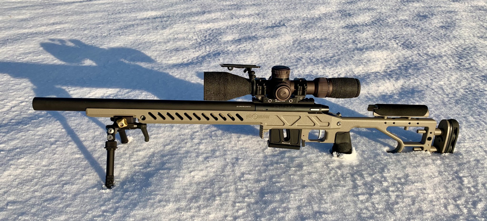

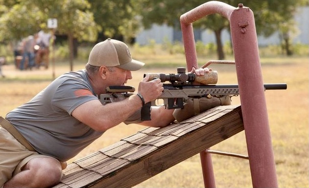

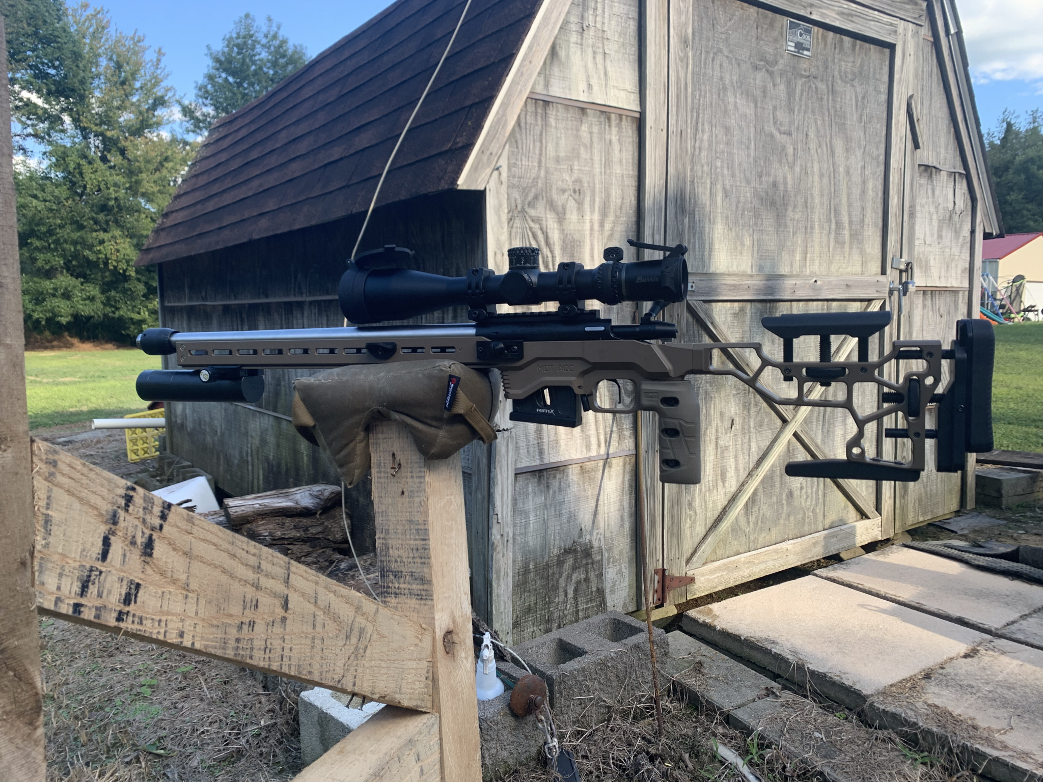

I run a PDC chassis with my RimX. I started out with mine in a Manners stock but switched to the PDC. Too me the PDC is the best fit for shooting matches. As far as prefits my first barrel was a 18” from Keystone and had absolutely no complaints about it.

What's up with the lower photo, I mean the barrel, it looks lie it must be 1.25" diameter. Is it shrouded?

No Shawn no Vudoo and yes the barrel is a 1.25 straight @ 22” . Gun weighs 19.6lbs with the internal chassis weights.

What I would be mostly interested in, how is this mag fit in this chassis? How much side to side play (wiggle)? Do you have to „shim“ it? Thank you, Tor
It has a little side to side play, I added one strip of tape to the front of my mags to help tighten it up a bit. Have not had any issues in the last year running it in matches.

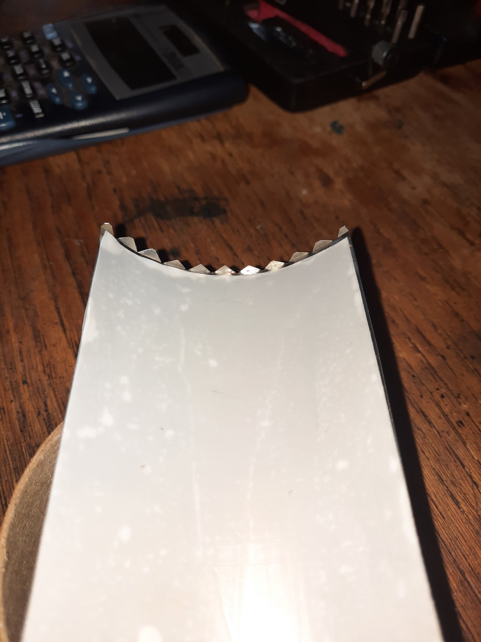

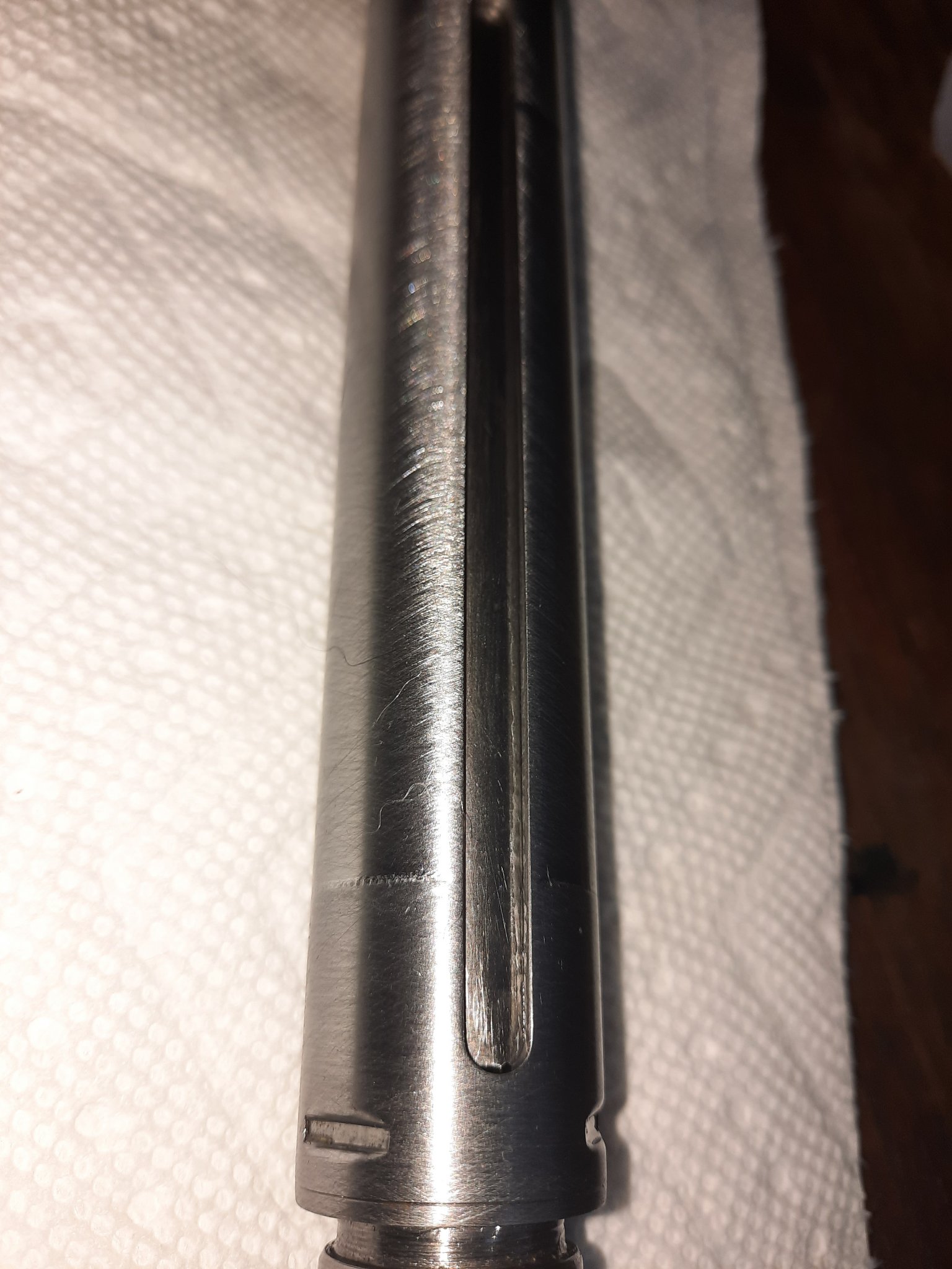

I meant to send you these two photos.... The first is a HW piston and in the slot you can make outside layer of the stainless steel baffle.
The second photo shows the baffle prior to insertion. The inside of the sheet has PTFE attached to it. The small diamonds allow the
sheet to roll and are turned inwards so that the top hat can retain the assembly. The baffle keeps the Krytox grease from migrating into the compression chamber which in turn would cause dieseling.

I put one layer of gorilla tape on the front of the mag. I tried 2 layers at first but that made it too tight. So far it’s working pretty good.

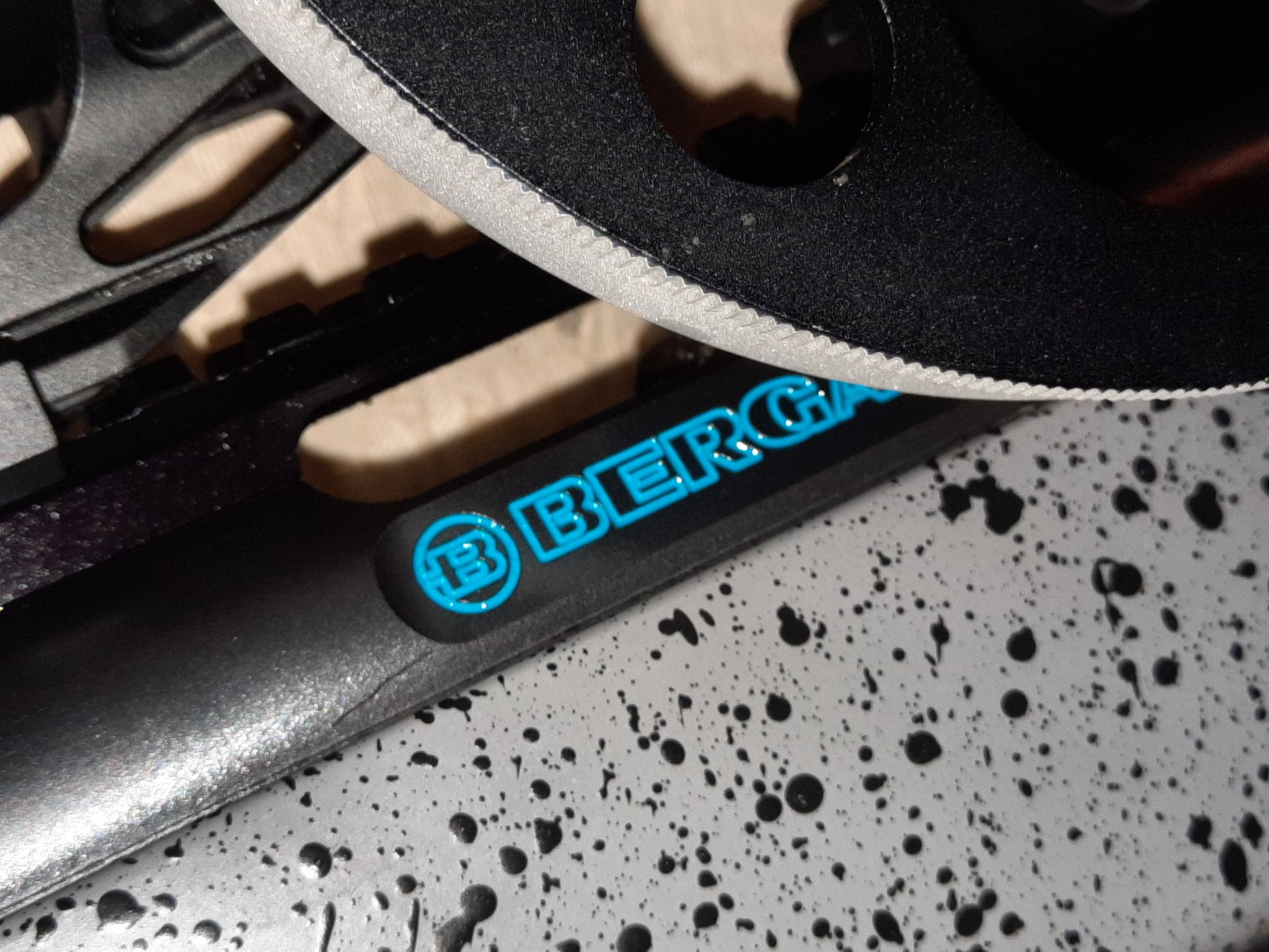

I need to get me a parallax wheel like that before I start shooting air gun field matches.

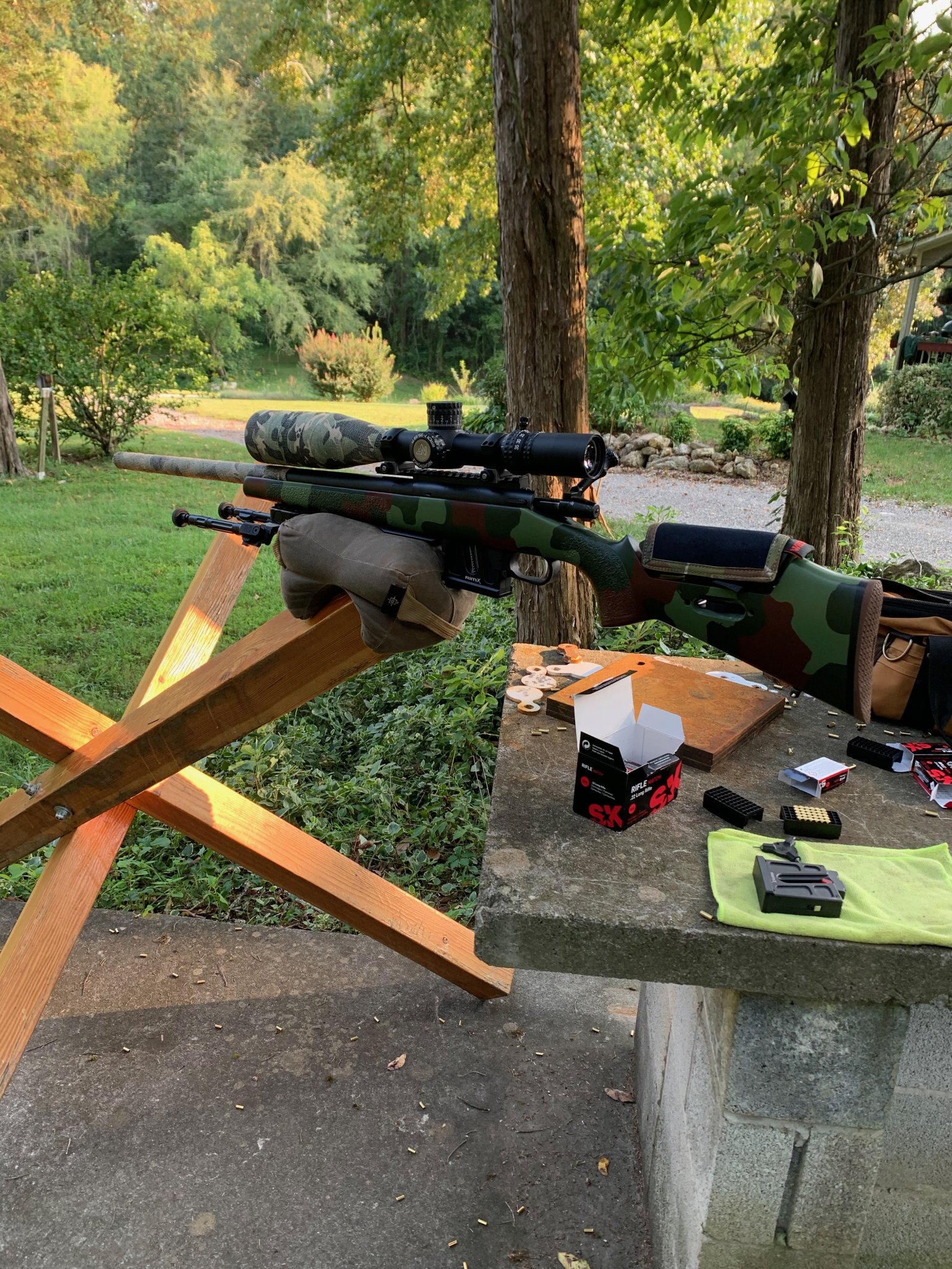

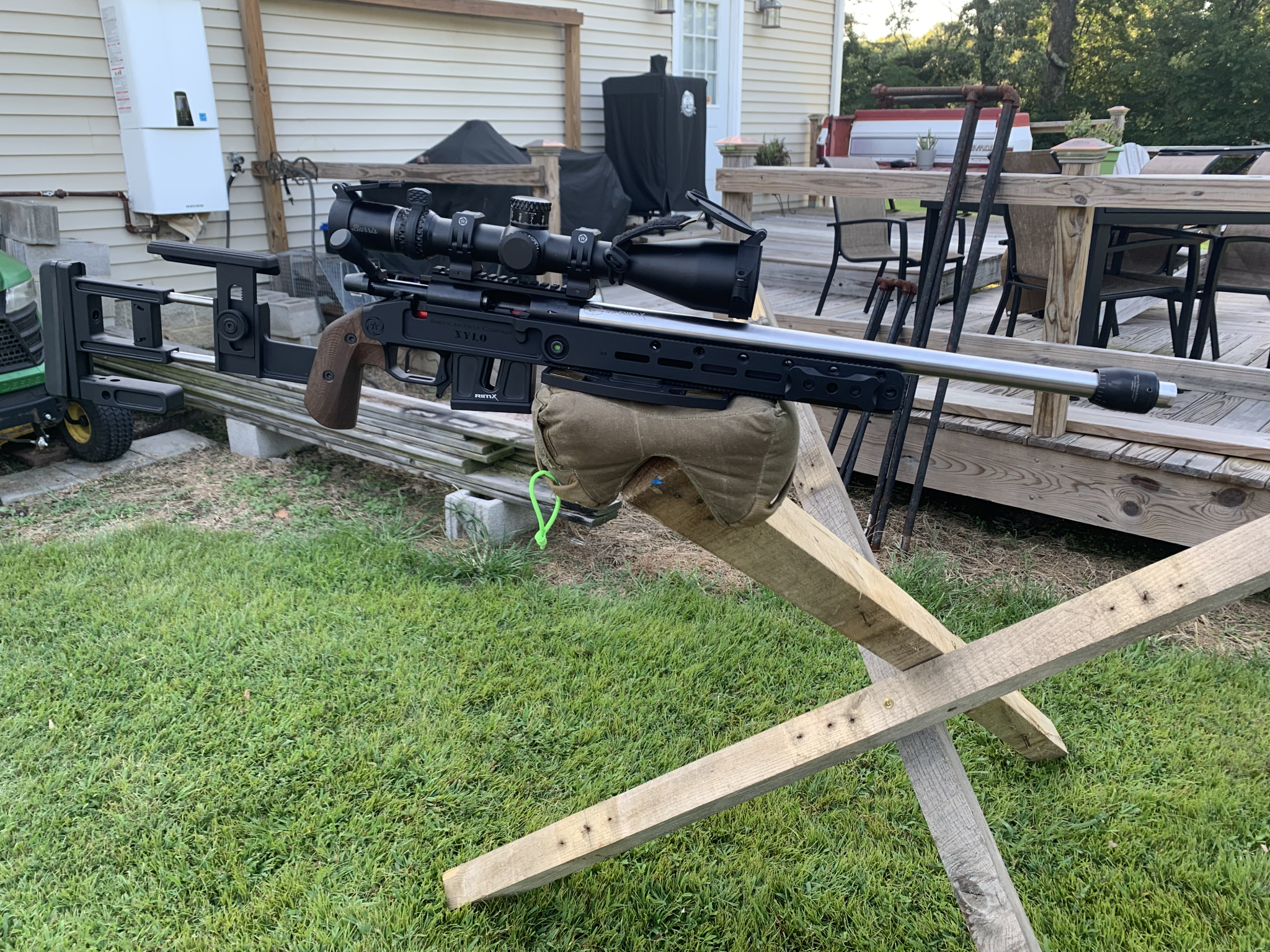

The thing with the RimX is it really does not matter the bottom metal. You will tune the mag to the action with bottom metal in place. If you swap to a chassis you will tune the mag again. This is the beauty of the mag catch on the back of the magazine. I went from an ARC XYLO to an MDT ACC and just a minor adjustment later 5-10 min total for 4 magazines and all is great.
I own a Vudoo and RimX and the RimX action out of the box is way smoother than my Gen 2 Vudoo. I should get to try a new 360 in the next couple of weeks to see that difference.
First picture is the RimX in the XYLO. Second picture is the ACC.
Where could I purchase a barrel in your specs and what chamber do you have in it? Cerakoted black to match the action? Really like your approach, I’m sure it’s well balanced and no weights needed.
