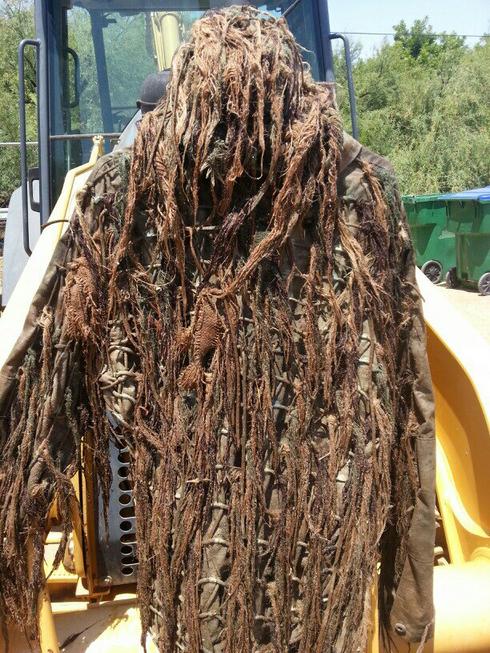

Any opinions or recommended techniques to dye burlap? I was thinking water in a bucket would be needed but the bottle is not real specific regarding instructions.

I used the video as reference and had my mother in law give her .02 (as she is more fabric oriented than I).
I heated up a pot of water, added about 1/3 of a bottle of dye, and two heaping tablespoons of salt (to help set it i suppose). let it all heat up thoroughly and added some burlap to sit for roughly 30 minutes. Took it out, hung it up and "ta da" after about 45 minutes of the Arizona night heat it was dry. I did brown last night, I am going to do green tonight. I will report back with updates.
Actually, I dont really cared how it came out, im FINALLY getting around to finishing my ghillie. I dyed brown, green and tan and it all had positive results. I figured as long as it is close to natural colors it'll be g2g as its going to be getting its mud bath and will be dragged down a dirt road etc etc.
I got a big pot of water warm (just below boiling), added the dye, then added two tablespoons of salt. Took it outside and added cut up strips of burlap and let it sit for roughly half an hour. It all turned out pretty good. Repeated this process 3 times (1 for each color).
Just a tip if you get your suit all put together and it is too dark, easy to do if you use too much green and brown. You can use bleach in a spray bottle to lighten it back up. Conversely you can also use rit dye in a spray bottle to darken it. Have fun and don't skimp on the mud bath.
Bleach weakens fabric, but you can hit it with some bleach water, let it soak and rinse to lighten it to start if you like.

It took its first "bath" need to let it dry and add more. I have no idea what I'm doing here lol
