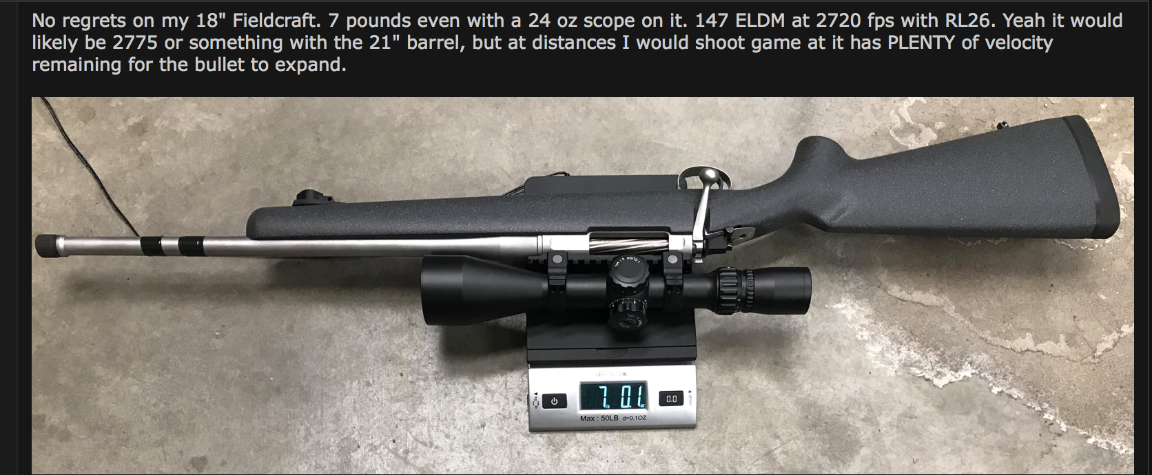

I’ve hit the same speed with a 140 in a 24 inch criterion, settled on a node around 2817, and tested velocity from 30°F to 70°F with 3-4 FPS difference. It’s safe to say I like RL16. I would think rl26 would be too slow but maybe I’m unaware of the latest and greatest.
Found this online
