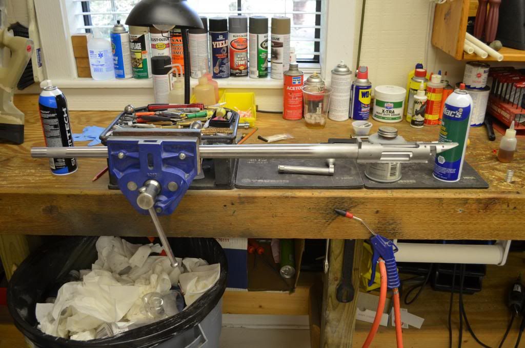

    Parts Pile

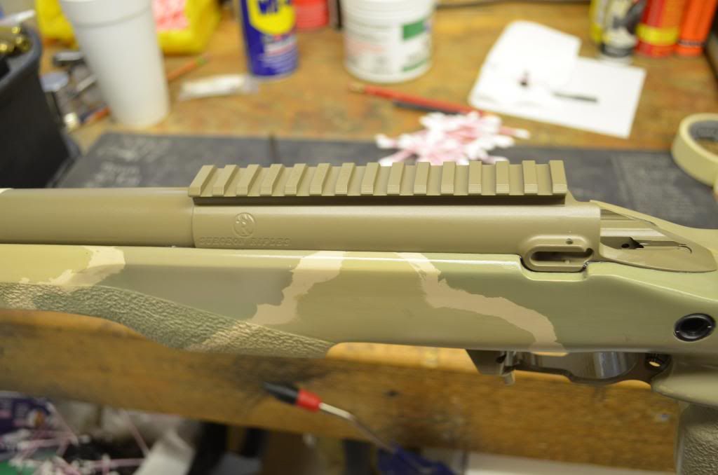

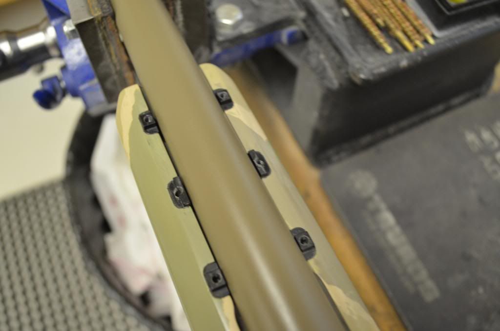

    Terry's MUNSter NV Rail

    In the parts pile picture where the stock , looks like 3 barrels and a bolt , the two that look checkered aren't barrels?
    I was referring to those.. They look great whatever they are!

    What camo is that from McMillan/KMW???
    Medium tan, light tan, and woodland beige.

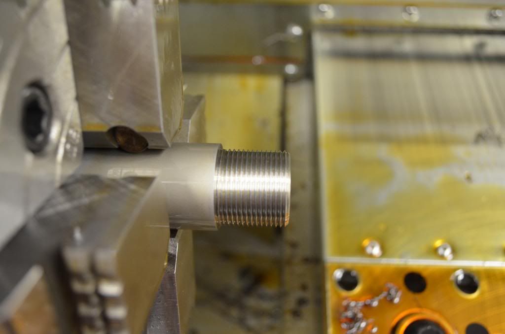

    How do you get threads right up to the shoulder like that? My tool hits the shoulder before I get that close. Smaller tool maybe?
    Anyway, very impressive. Looks great.
    I believe it requires a special type of lathe that has a built in function that allows that type of threading instead of your typical run-out groove. Not an expert so I could be wrong.
