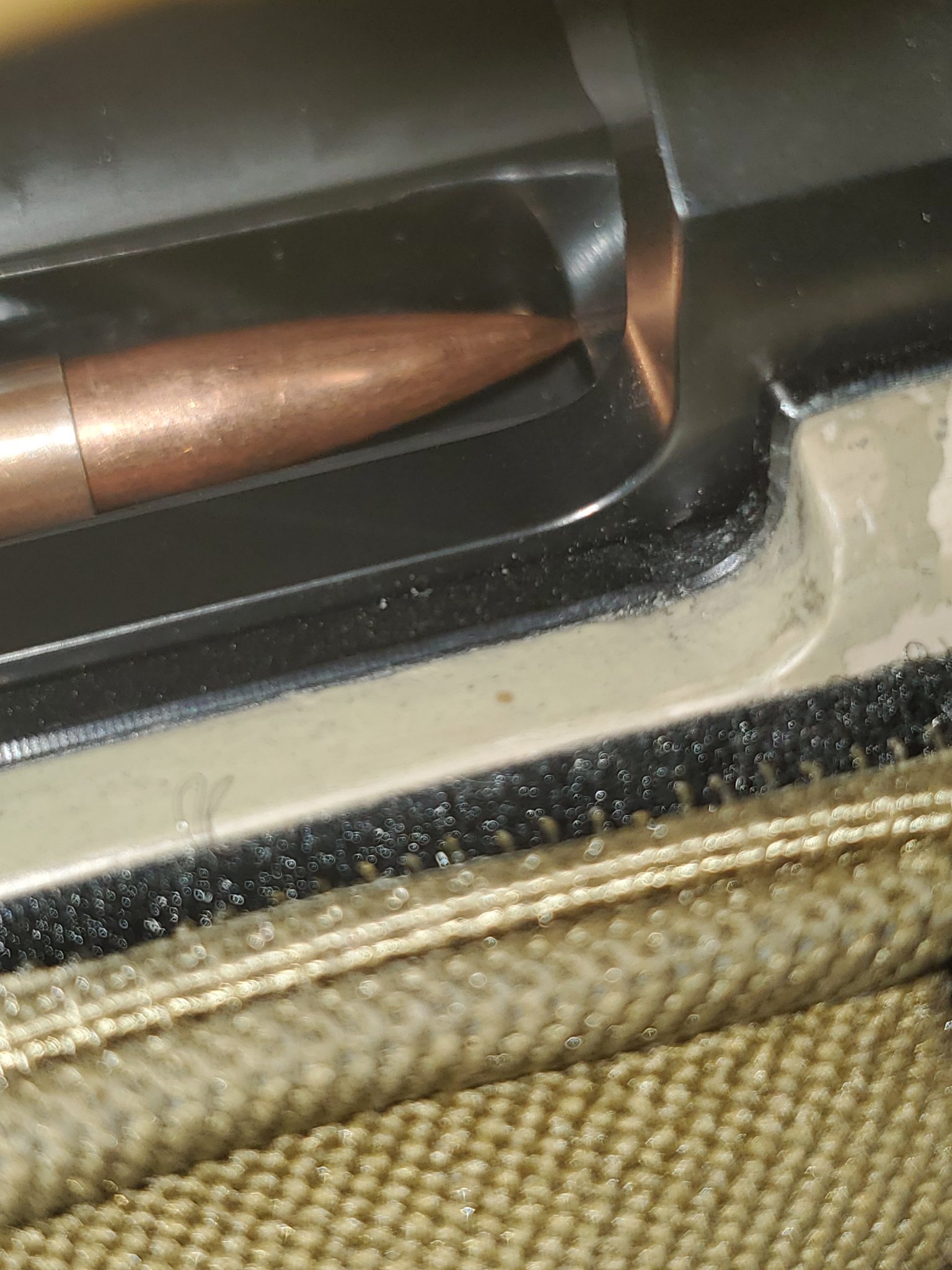

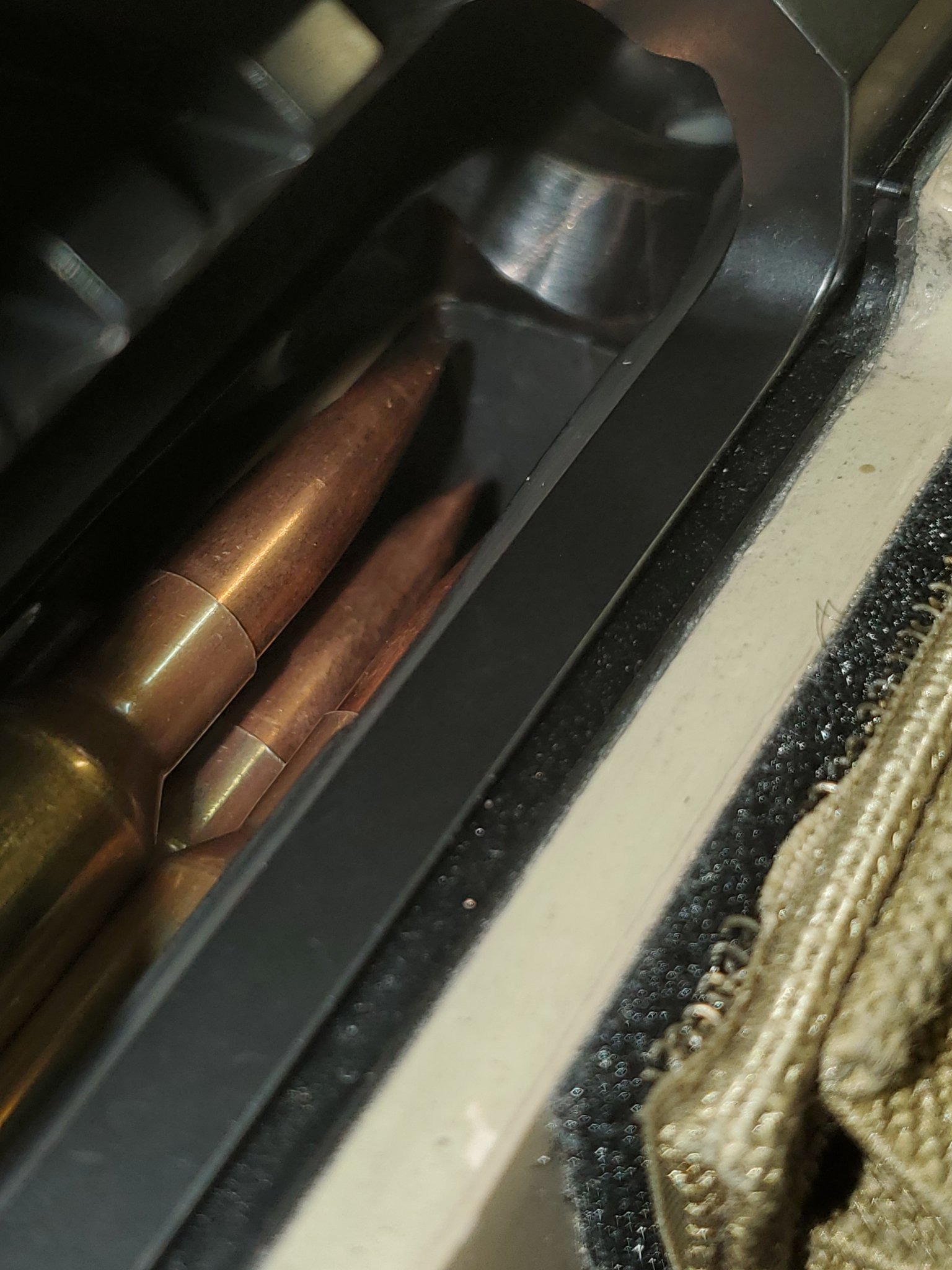

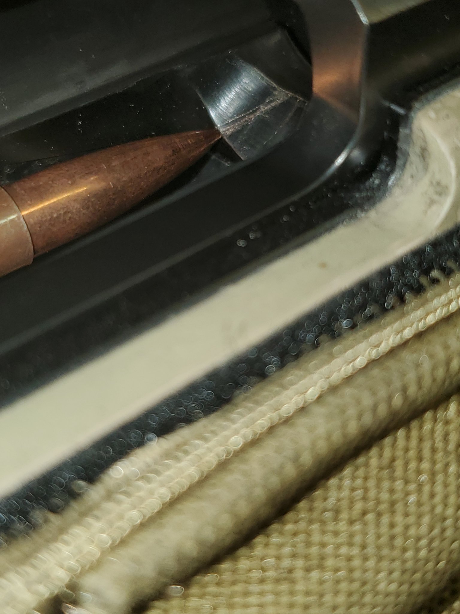

I got the AW mag to lock in, but now I'm having a feeding problem.
Some rounds will get pushed into the action and won't feed unless I really force it. When I play with the follower and angle the rounds a little nose up, they feed fine. When I unload a magazine by hand, the rounds move in a straight line, they don't nose themselves up or down are the supposed to?
Rounds seated to rear of mag.

The bullet tip is still catching on the side of the action, and I notice when I try to slide the rounds out by hand, the shoulder on the neck / bullet junction catches on the front of the magazine.
When I adjusted the lips where the front was much narrower than the rear, the bolt would skip over some of the rounds and not pick them up.
Any suggestions?
