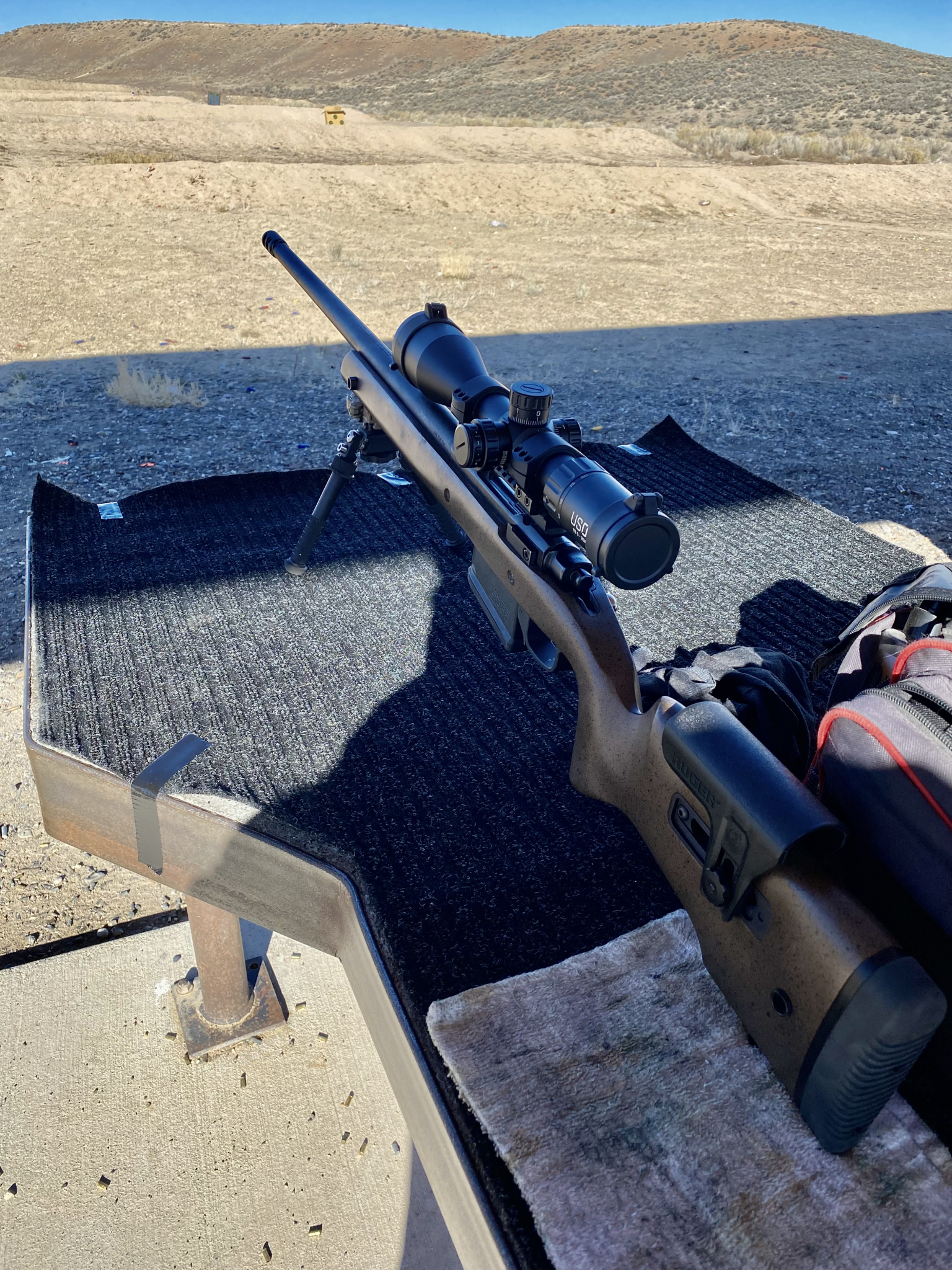

Just picked this up yesterday for a shamefully low price. 300 WM. Mounted a USO TS 5-25X50 on it in Burris Signature XTR rings. Fired first shots today. I have an RPR in 300 WM so I already have load recipes (the barrel is the same as the RPR) but the mag is about .050 shorter. Apparently it really likes my 220gr SMK load and it fits in the mag without modification to COAL

Out of curiosity........ Does this rifle have the fixed blade ejector or is ejector in the bolt ?

It’s an M77 so it has the Ruger Mauser style bolt and controlled feed extractor with a fixed blade ejector.
