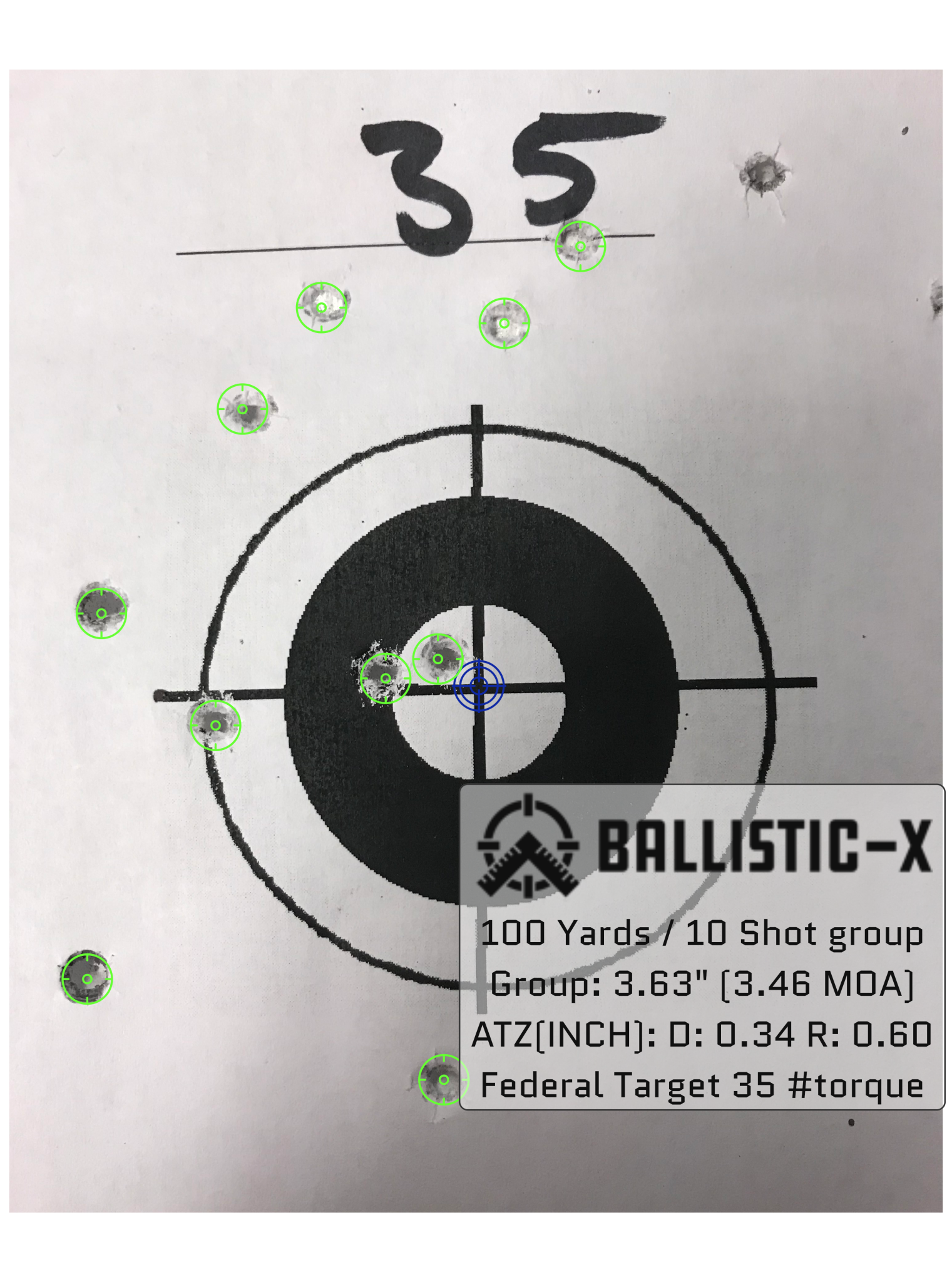

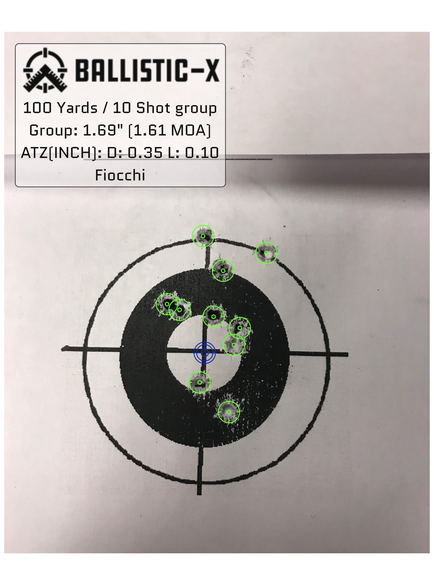

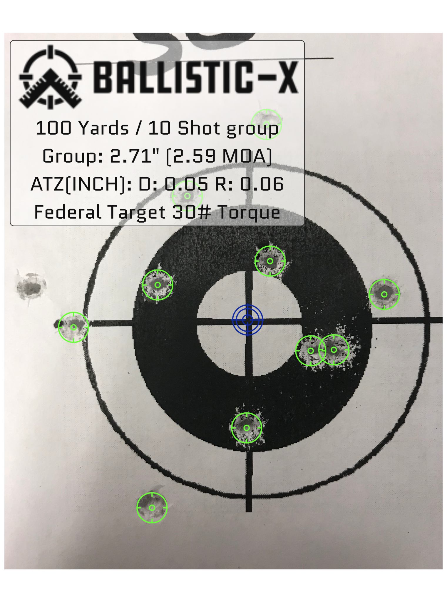

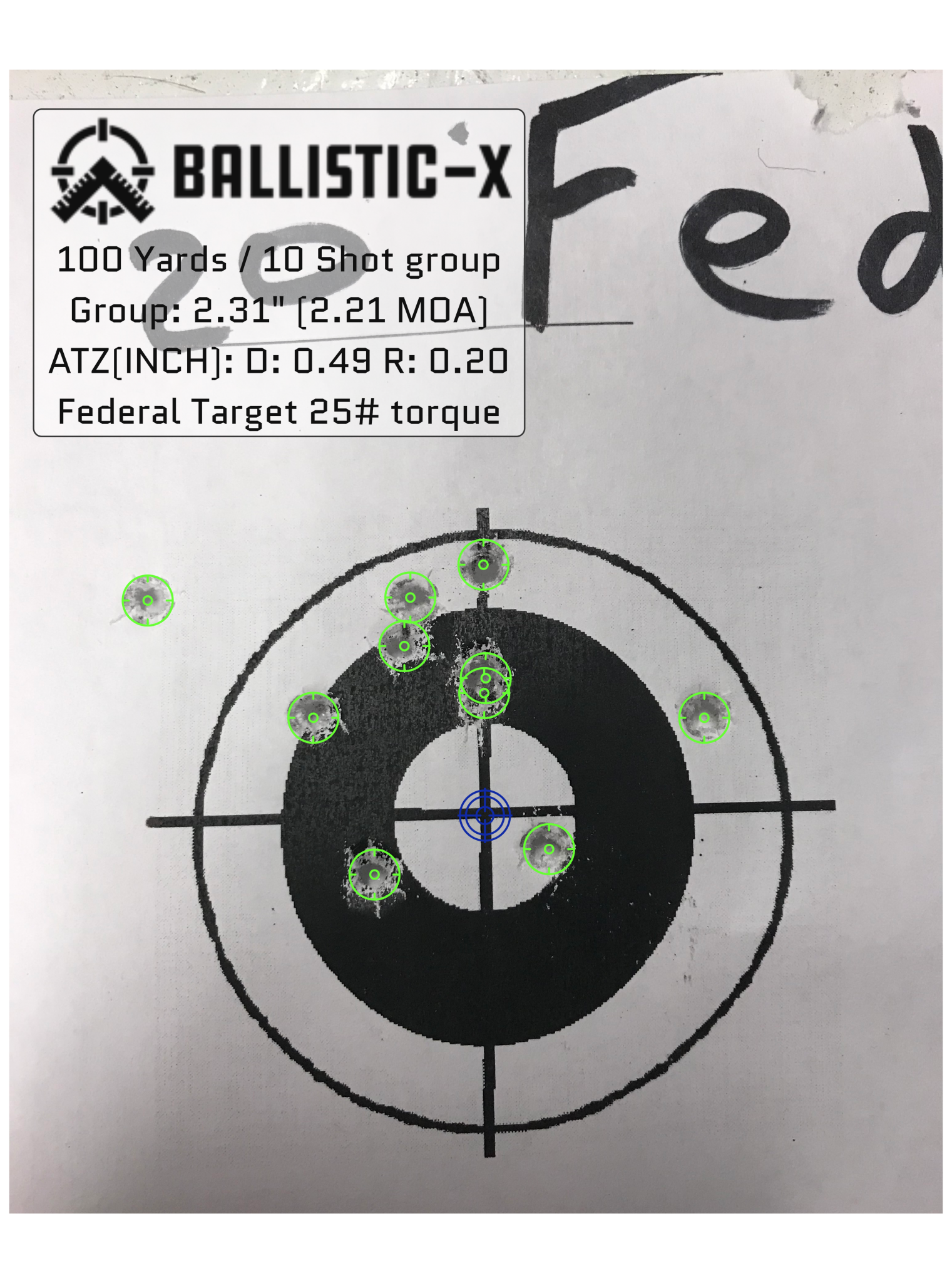

How action torque specs affects performance I used Federal Target as ammo an example with pictures but had tested several others at the same time all with almost same results, my biggest finding is the original torque spec of 25#s still holds true
25#s 2.21 MOA at 100 yards
30#s 2.59 MOA at 100 yards
35#s which is current spec 3.46 MOA
still waiting on the good stuff but we are taking a scientific approach on what to expect with a basically stock RPRR with just over 1,000 rounds threw the tube
