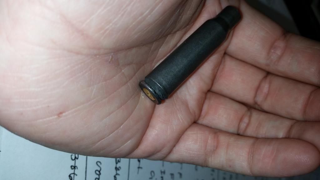

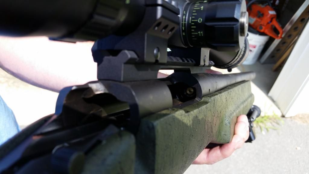

I decided to do a little experiment today with my SPS Tactical and some Tula steel case 308. Apparently it wasn't a very good idea. My buddy was on the gun. On the second round, a lot of gas blew back in his face. I opened the bolt and the case was stuck. We removed it by popping it out from the barrel side. Everything seemed ok besides that, but now the gun won't extract very well. Also, when I dry fire the gun the bolt knob will actually pop up about a 1/4" which I don't recall happening before. What's going on here? Permanent damage to the receiver, barrel, or bolt? And what went wrong? I've fired about 200 to 250 of these same rounds out of my DPMS LR308 with no ill effects besides a few that didn't go off. I still have about 200 rounds of this stuff left and I don't know if I should just junk it or what...

Steel cases may or may not be as accurate as match quality but they don't cause any issues with chambers that brass doesn't. Since all the steel cases available are either coated with laquer or some other polymer the steel never actually touches the chamber. The coating is softer than the steel and won't cause scratches or other damage. Its a common misconception that steel cases are bad yet years of testing by numerous govts have shown they don't have any of the troubles normally ascribed to them. I've seen a reasonable number of brass cases that had a head let go and some steel too. Things happen but its not just because its steel.
For the original poster there are a number of things to consider. Make sure it headspaces right. Its possible the shoulders are too far back opening up the headspace. Its also possible it is crap ammo and in that case tossing it is a better idea. Don't blame it cause its steel .... blame it cause its no good.

^^^ This. On the issue of steel casings you can have an issue if you have an oversized chamber or undersized ammo, as the steel is not as ductile as the brass and is more likely to fail as the OP found out. Most likely the gas pushed debris under the extractor and is causing issues, if it did not deform the extractor. Alas it is a Remmy extractor so you will have to replace it once you pop it out to clean it, but give it a good cleaning first, stripping the bolt down and popping out the ejector. Maybe that'll take care of it.
The pop of the bolt handle can happen if the handle is forced all the way closed such that the handle contacts the receiver. When the sear releases a torque is applied on the bolt and it can shift around during this process. Close the bolt fully, then tap the bolt handle back up lightly so it's not contacting and see if it does it again (during dry fire). You could also have excess gunk in the bolt now, or some shifted onto the threads, etc. Take it apart and clean it, and this might reduce the bolt handle pop.
