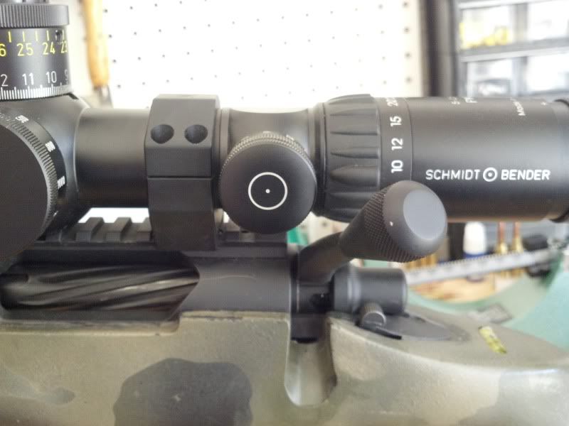

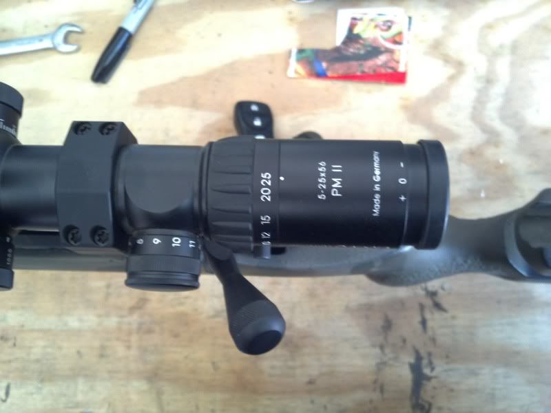

I have a Stiller Tac 30 in a T4A. I will send you a pic of it later today. Not sure how the Long Action will be but I am having issues with the brass hitting the Parralax knob and bouncing back into the action. But that is a stiller issue not the S&B. To clear the bolt handle my scope is pretty far forward but its perfect for me.

Here is a view from the top with the bolt all the way forward.
And from the side not a lot of room but it works for me. You cant manipulate the bolt by grabbing it you have to use your finger tips almost.

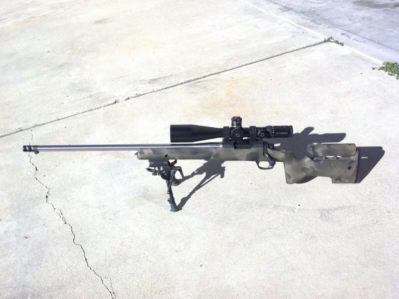

My Rifle

Let me rephrase that. Its the extractor. Mine has a m16 modified extractor. It causes the brass to hit the parralax knob and bounce back into the action. Does not happen every round but it happens. So if you are on the clock it can be a pain in the butt if you dont know that it bounced back in. It is the only thing that I'm not a fan of with this action. I dont think there is anything you can do for it as I cant move my scope more forward or back far enough for it not to hit. My buddy told me about the issue with his NF as well. But I couldnt afford a Defiance so Stiller was the next best thing. I love my stiller though!
