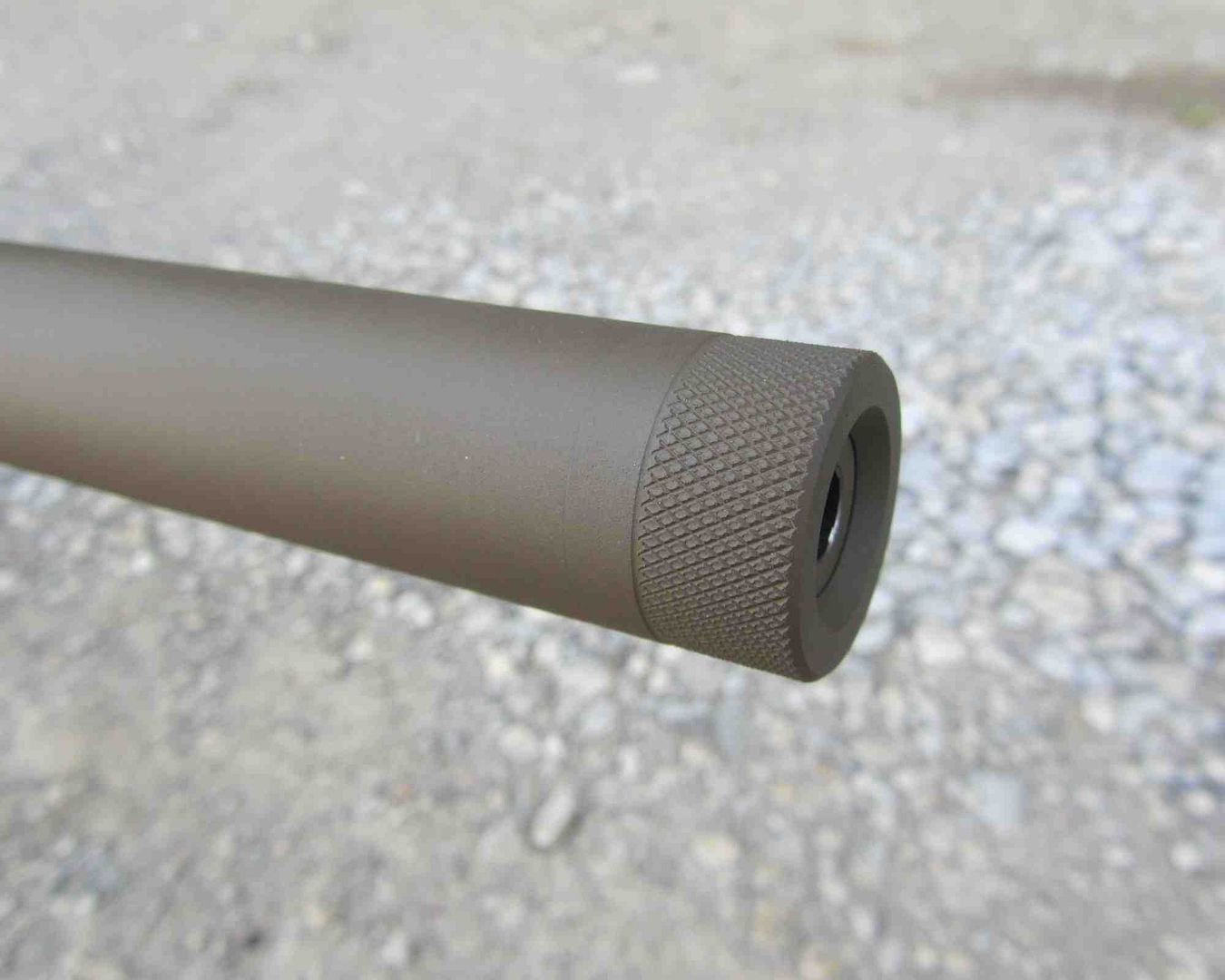

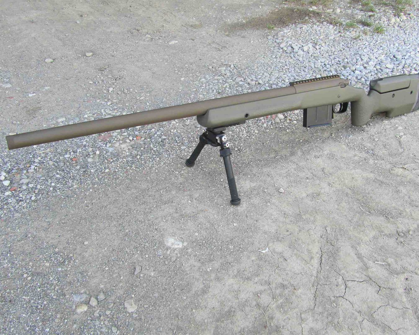

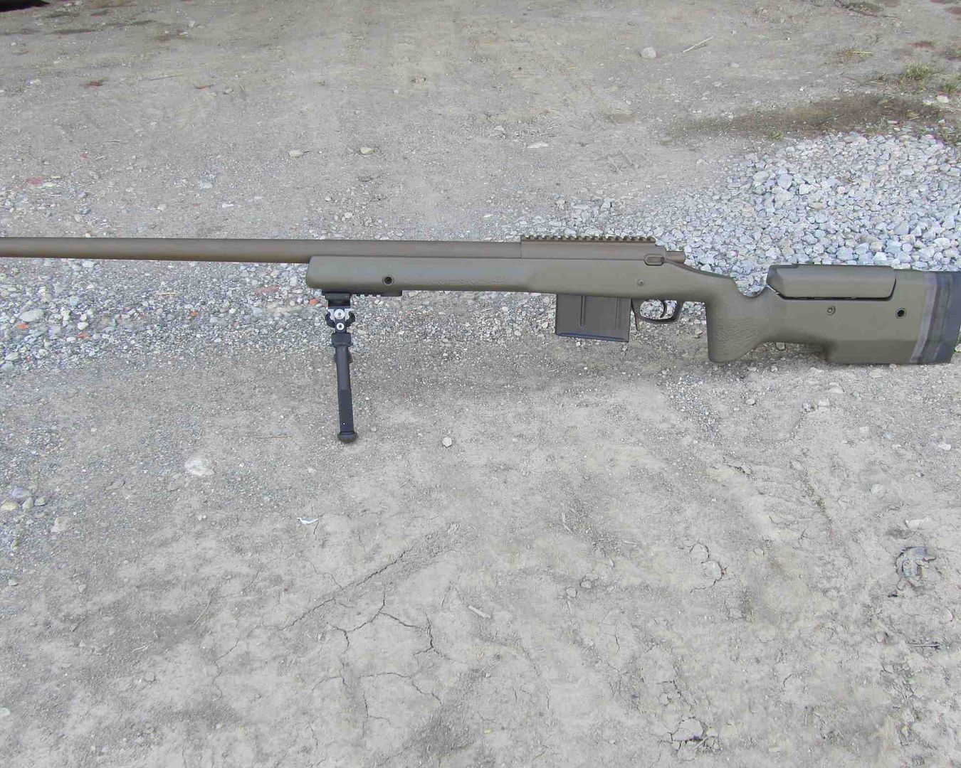

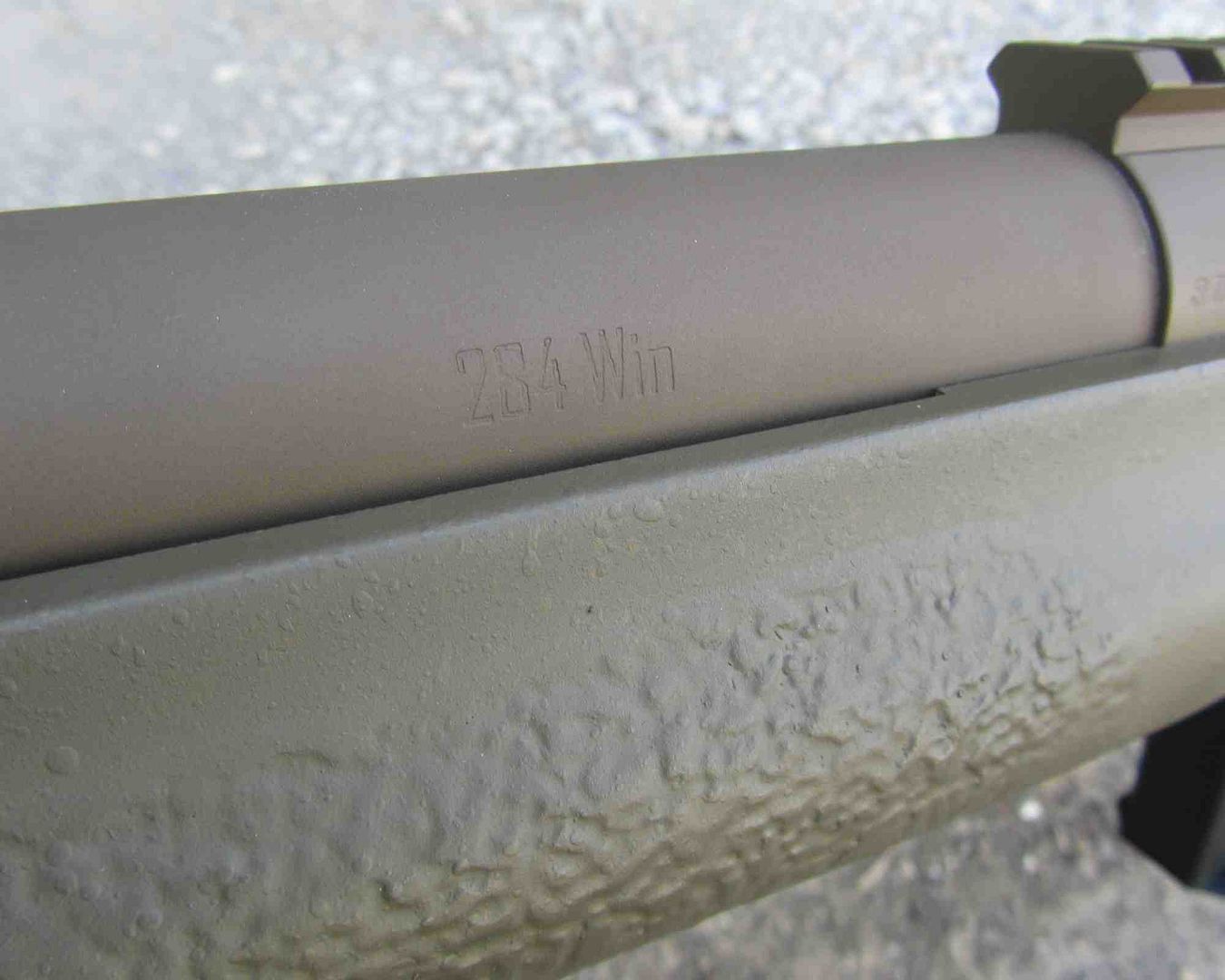

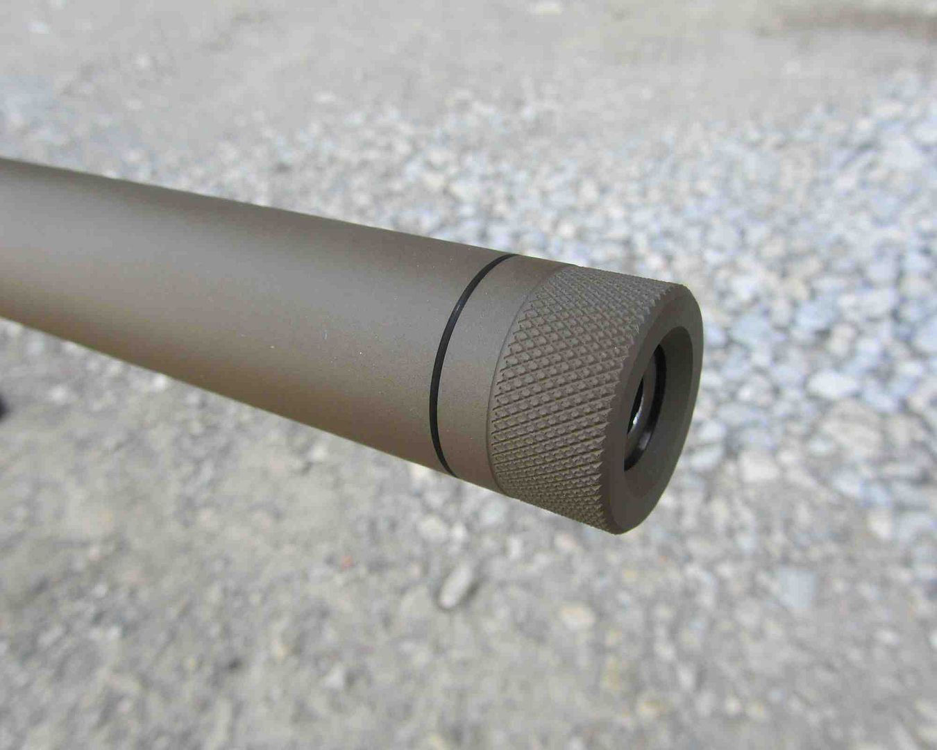

We just finished up another rifle this week. It was a customer supplied component build chambered in .284 Win. Everything turned out great on the rifle and we should be hearing shortly from the owner with a range report!
Here are the specs.
Surgeon 1086, standard bolt face
Krieger Heavy Varmint 1-8.7" finished at 26.5"
Manners MCS-T4A, Mini Chassis, Accurate Mag 300 Win Mag supplied.
SAC Standard .284 reamer
Skim Bedded
Stock blended/fitted
Patriot Brown metal with Black Accents.
Thanks for looking.
