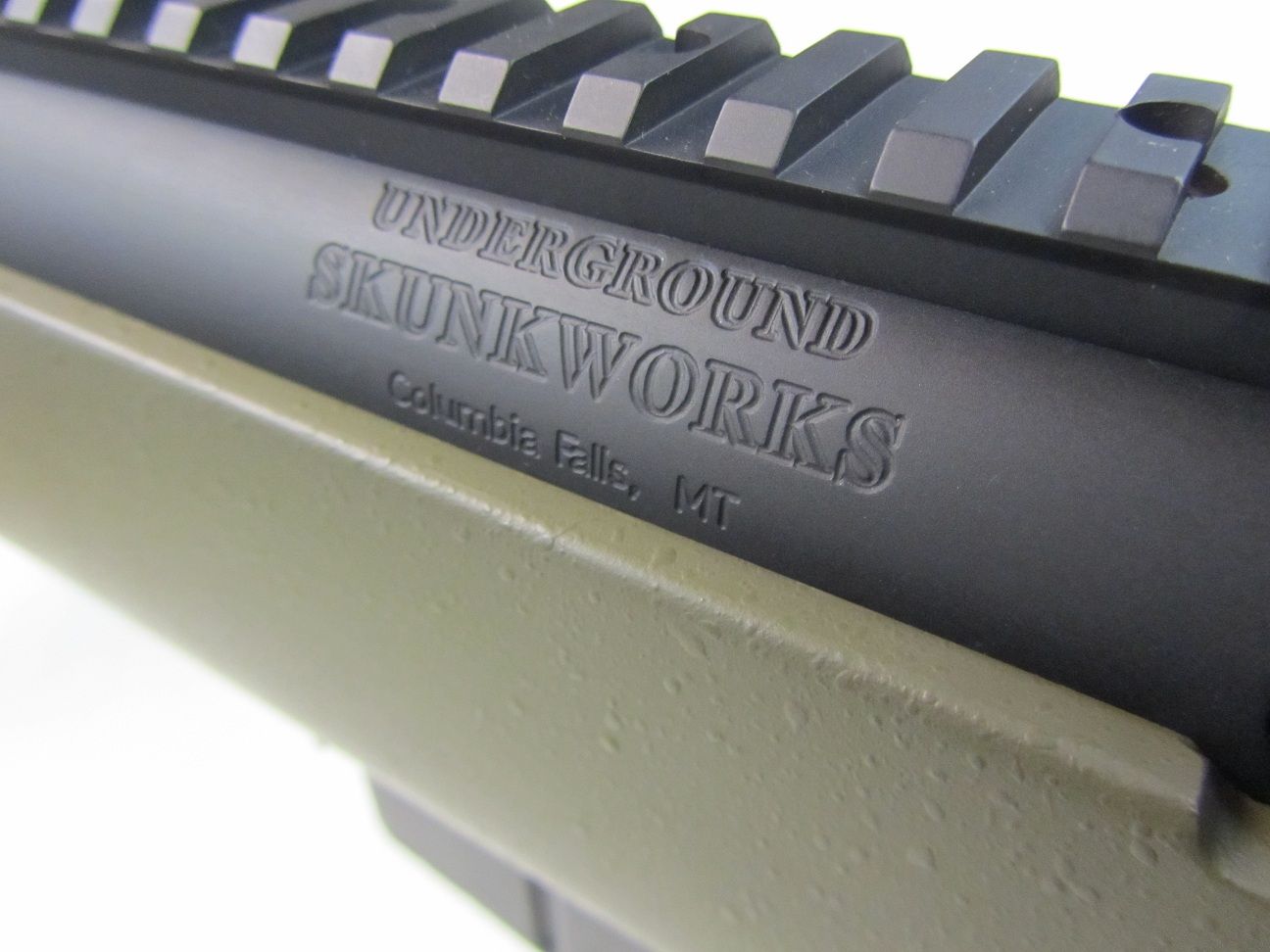

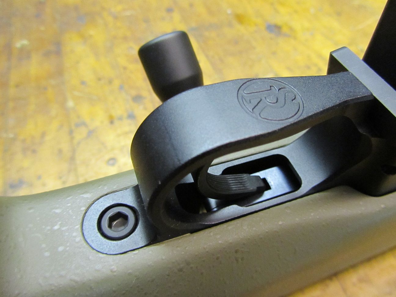

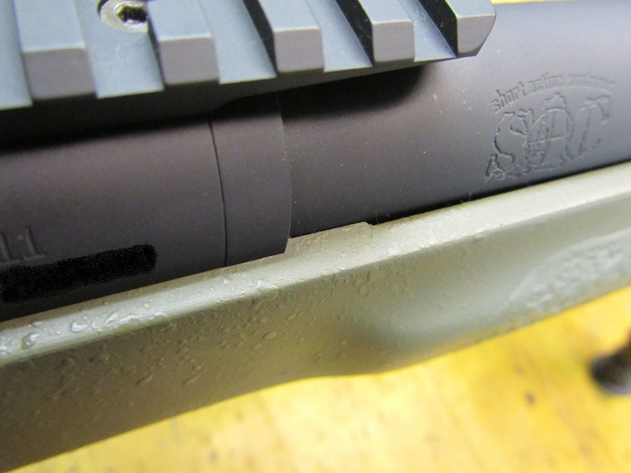

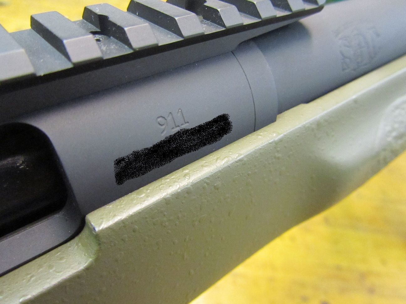

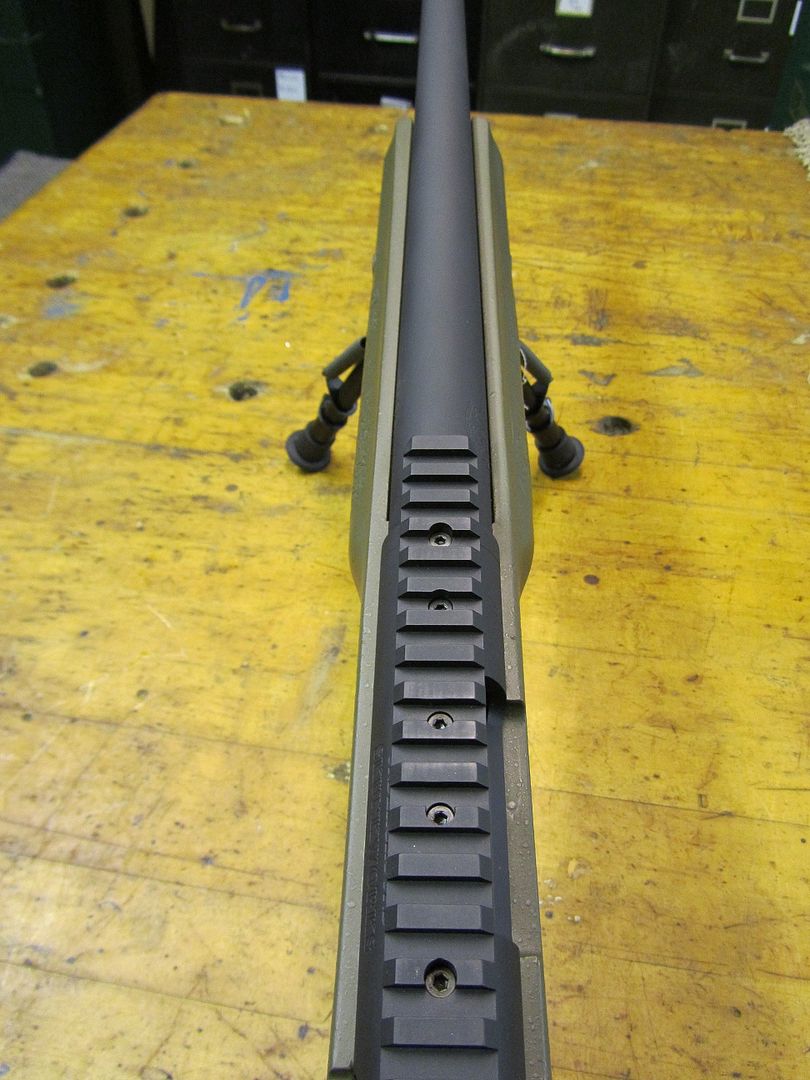

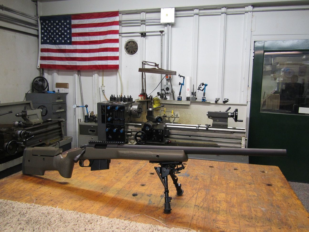

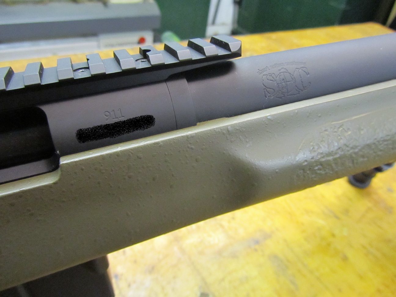

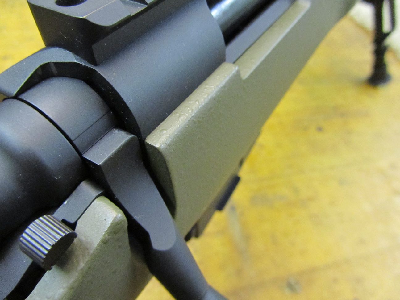

I just finished up another build I figured I would share with you guys. I'm very happy with the Manners stocks I have been getting. They are pretty solid and feel great. All the inletting has been pretty spot on and final finish is excellent.
These Defiance Machine actions are very nice. The extraction is the smoothest I have felt. The surface finish on the metal is exceptional, the side bolt release looks very clean, the bolt gets 100% full contact and the bolt lift is extremely easy. Other features are standard on the 911 action such as.
Double pinned scope base with (6) 8x40 base screws
Double pinned recoil lug
UGSK's ejection port
UGSK's bolt knob
Mark
Here are the specs.
-Mike Bush's Under Ground Skunk Works 911 Stand Alone S/A, Guardian Mag well, UGSK bolt knob, 20 MOA Double pinned base, double pinned recoil lug.
-Rock Creek 1-8.5 M40, threaded 5/8 x 24, custom thread protector and Randy Cain's Rapid Brake.
-Manners MCS-T4A, OD Green, Surgeon Bottom Metal, BT-17 rail. Stock was fully bedded.
All metal was finished in Cerakote Graphite Black.
Barrel was broken in, and (2) 5-shot groups were fired to test function. Accuracy for the 2 groups was in the .3" range with Factory Hornady 6.5 Creedmoor ammo with 140 Gr A-Max.
Enjoy!

<div class="ubbcode-block"><div class="ubbcode-header">Originally Posted By: Storm Tactical</div><div class="ubbcode-body">Nice looking stick, and that is the cleanest shop I have ever seen! Mark </div></div>
Well, they say that "neatness reflects quality"....
Catch me during normal working hours and the picture might look different.
Mark
