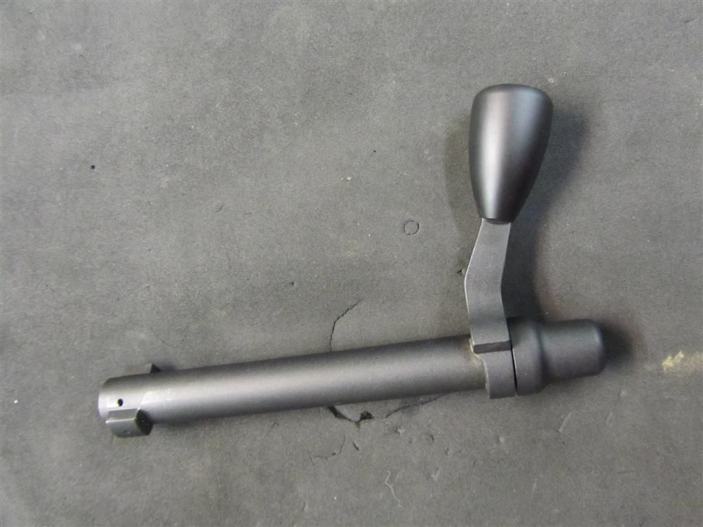

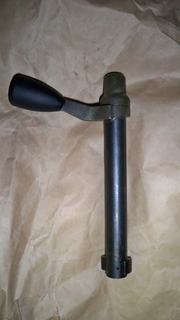

Shooters, I just wanted to share some information on the latest generation of bolt knob conversions were doing in the shop.
I believe that our bolt knob conversions are the best looking and most functional conversions out there. We're always trying to make our products the best, so if you have any constructive critisim we're always open to getting the customer what they need.

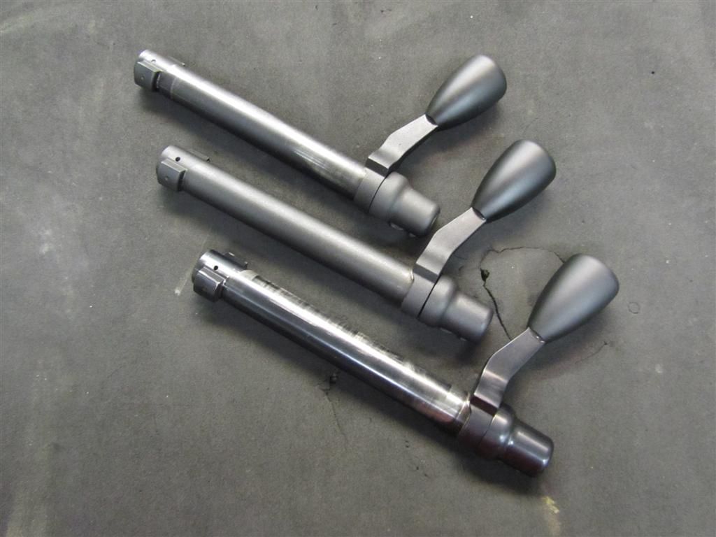

First is the Remington 700 Bolt knob conversion. Each bolt is indicated in on a lathe and the factory knob is turned down and threaded that is centered perfectly on the handle. Since Remington uses at least 3 different style handles, I can indicate each style in to get the best results.

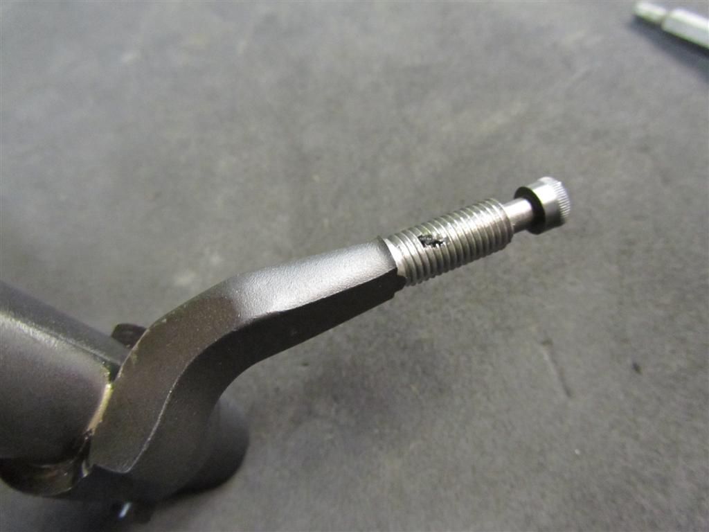

Once the handle is threaded, I drill out the center of the bolt aprox. 1 1/4" deep. I then tap the hole and fill it with Loc-Tite 271 and insert a 10/32 hardened steel alloy screw. I do this because there is typically some kind of inclusions in the casted handles and these are usually in the middle of the handle and sometimes close to the bolt knob/handle shoulder junction and can/will cause breakage down the road.

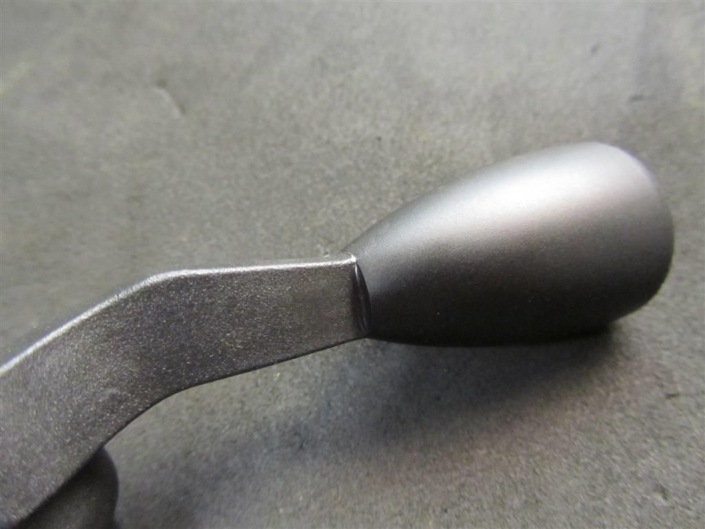

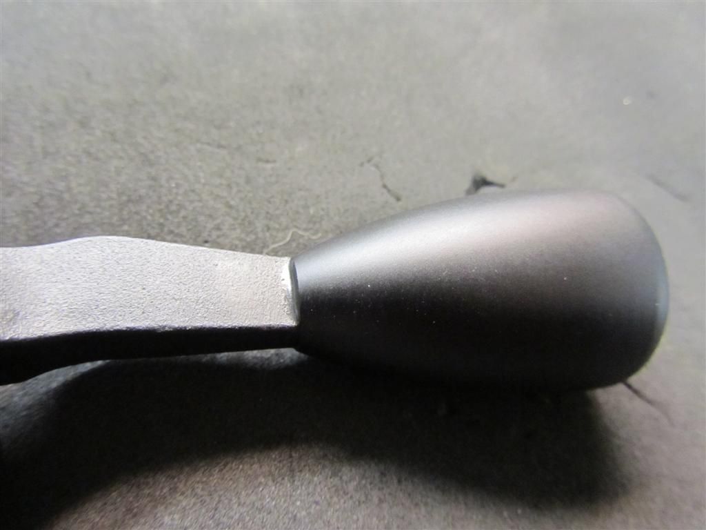

Once the handle is threaded and drilled and tapped, the knob is screwed on and fitted. I typically leave a little contour of the factory knob so it blends in as well as a square knob can blend into a round bolt knob.
An additional benefit of doing it this way is that my bolt handles retain a little extra length than your standard milling bolt knob conversions. Short Action Customs conversions are typically around .1" longer aiding in extra leverage and keeping the bolt knob away from the trigger finger when the index finger is straight and off the trigger.
The fixture we use was designed to allow the bolt handle's threaded shaft to run parallel to the back side straight section of the factory handle. No additional sweep back is introduced into our conversions. Just a perfect conversion with all the correct angles and geometry. Furthermore, there is no distortion or deformation of the bolt handle. Our proprietary fixture causes no stress on the bolt assembly.

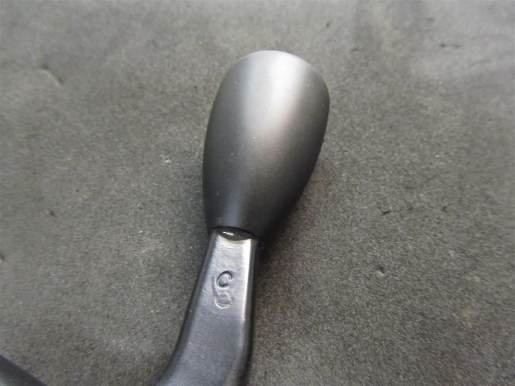

Finally, the bolt is removed from the fixture, cleaned, no refinishing is required, and the bolt knob is secured in place with JB Weld and sealed for functional and cosmetic reasons.
Price is $90, this includes performing the conversion, supplying the bolt knob and return shipping to the customer.
