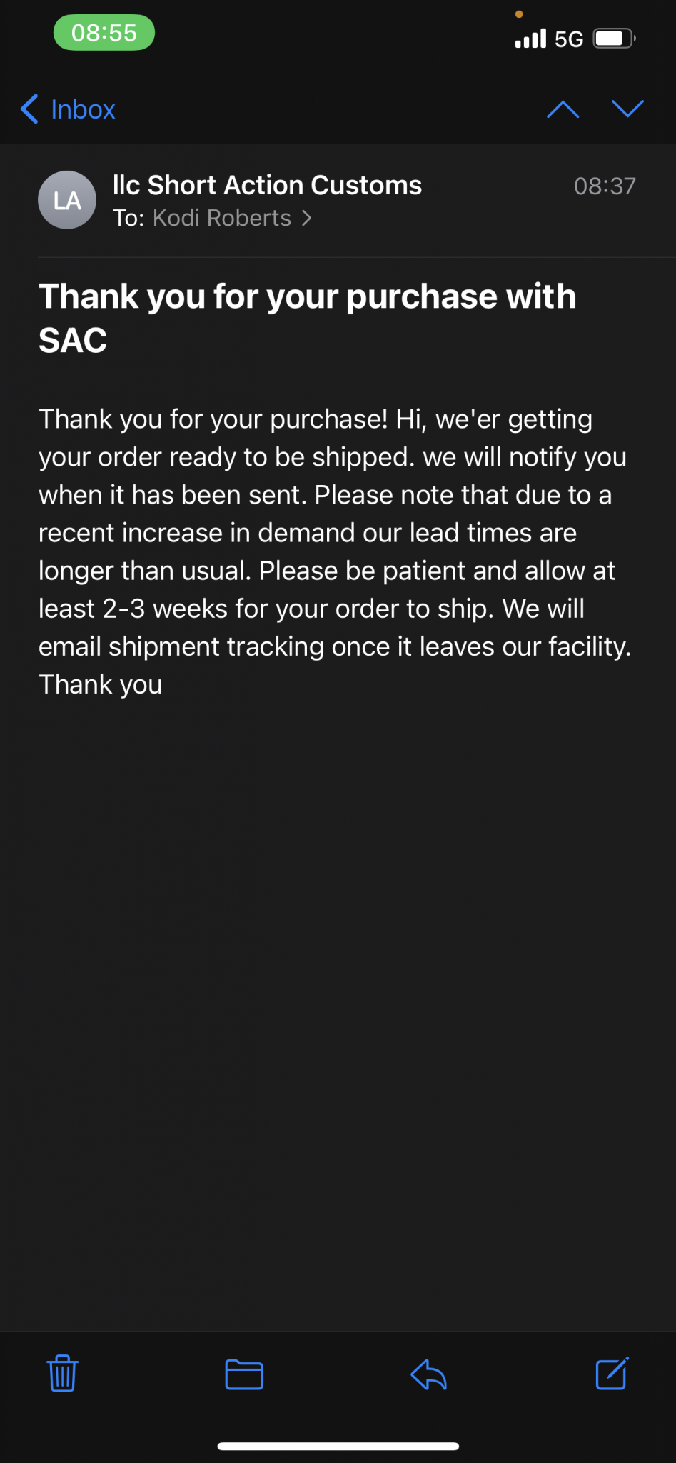

Well. I pulled the trigger. Hoping it’ll be here before I get off hitch next week.
Could be a couple weeks judging from their email they just sent me 🥲

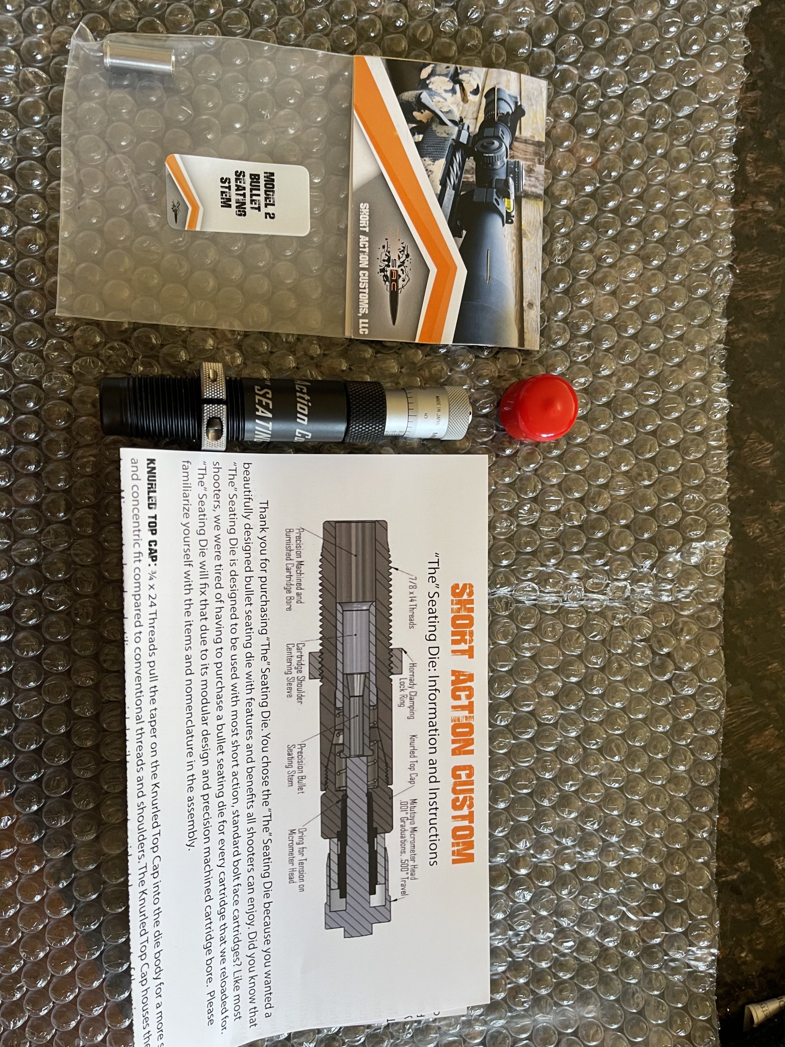

Showed up today. Seems like a super high quality die over the Redding’s. Waiting on my autotrickler scale to warm up, gonna load some 6.5cm, 6CM, and 308 today probably.
