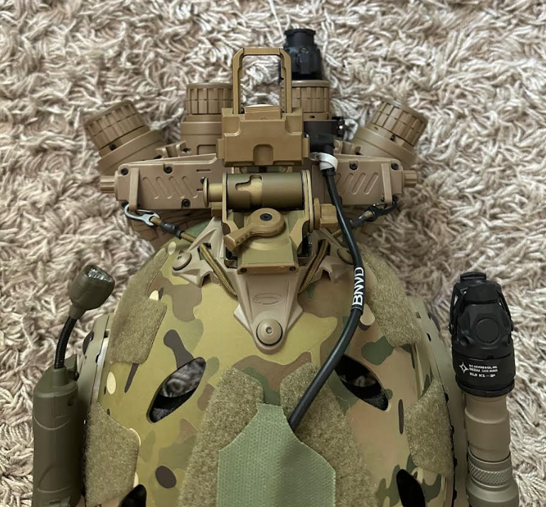

Back on topic: just ordered all my ancillary equipment for the TAD. Got a whole bunch of stuff to run both my NODs and TAD off external power, including a CUBA coming from SOK. I'm hoping that will be a plug-and-play part, but have already been in touch with one of the guys there in case I run into compatibility issues. Now to wait until business hours on the west coast to settle up with TNVC.
What...ancillary equipment IS there for the TAD?
I ordered the SOK CUBA, Alamo Night Vision GDPC (for my DTNVS), TNVC Mohawk Mk1, 2x Voltaic V50 battery packs, USB plug protectors (for when the cables are not in use), a LEMO plug protector (for the same reason), a silicone USB-C blanking plug (for the unused battery pack ports), and a pair of 1" x 3" rubber caps (to kinda-sorta protect the battery pack from rain). Next up is some method to secure germanium sacrificial lenses to the TAD itself, which will be a DIY job.

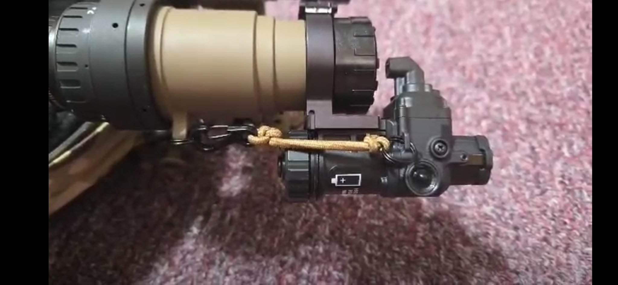

Yep, I just had a look at mine and I get a slight amount of play in rail/bracket interface. I did the same with a small bungy, more out of retention but killing two birds with one stone is fine by me.
Reactions: JWG
Yeah, I'm not trying to come off as complaining or like "It has a problem". This can't be an interference fit. It's GOING to have some tiny bit of clearance. A bit of light tension from a bungee effects retention and solidifies it.
I am noticing the tiniest but of wobble between TAD and bracket. Very small, but it bothers me. All rail surfaces look fine. So, I do a fix.
Just out of curiosity, was the wobble enough to cause misalignment of the projected thermal image over the I^2 image?
Mine snaps in very tight. In fact it’s so tight it wouldn’t snap into the PVS-15 side by about half a millimeter, so the bracket went back to Optics 1 also.
