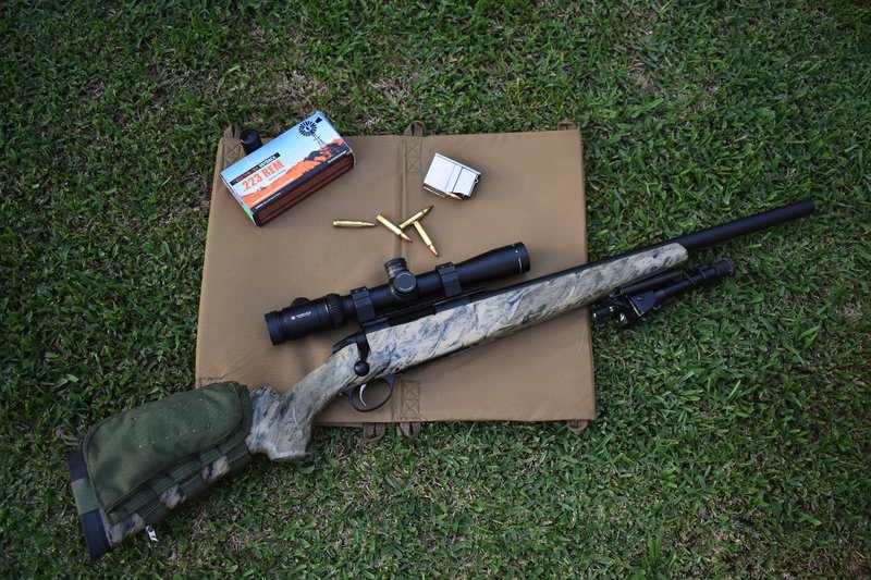

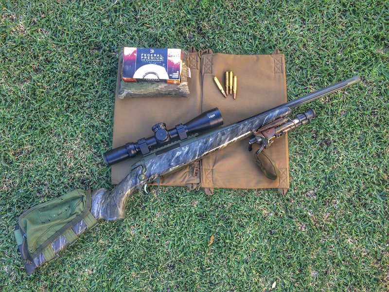

These are my pair in 223 and 308, both in McMillan Sako Varmints, both with Richards Pic rails, Both 20in barrels setup as practical carry guns/all rounders.
