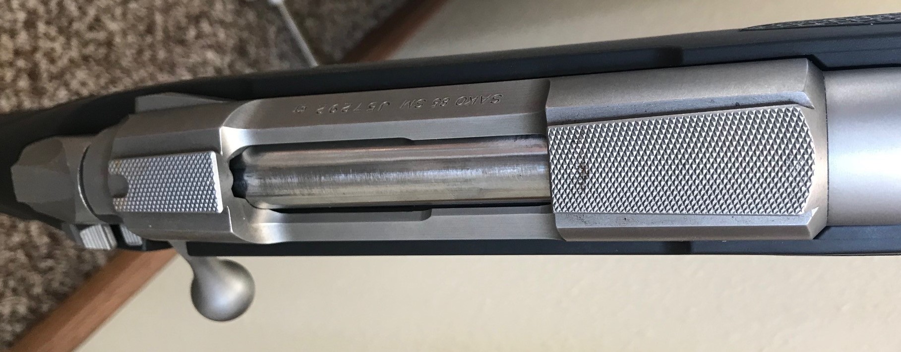

OK in the stupid question category - I am removing Leupold rings/bases from my Sako 85 Finnlight that I purchased as a package with scope installed, and I just realized I don't know how the bases are attached. Is this a press fit or something? How to remove and replace?
Thanks
Thanks - that's what I thought. I just didn't want to go tapping/beating on them without somebody's approval of experience. I might start with hardwood tap then graduate to brass before steel.
Edit - I like your signature quote!
Yeah, I've had a few Tikkas and CZ rifles with dovetails like that. Shouldn't be too tough to move them. But you can put a drop or two of penetrating oil between the mounts to help get them moving if needed.
Got 'em off - thanks. (but not until I hammered the second one on tighter before seeing it was one-direction - no harm done though.)

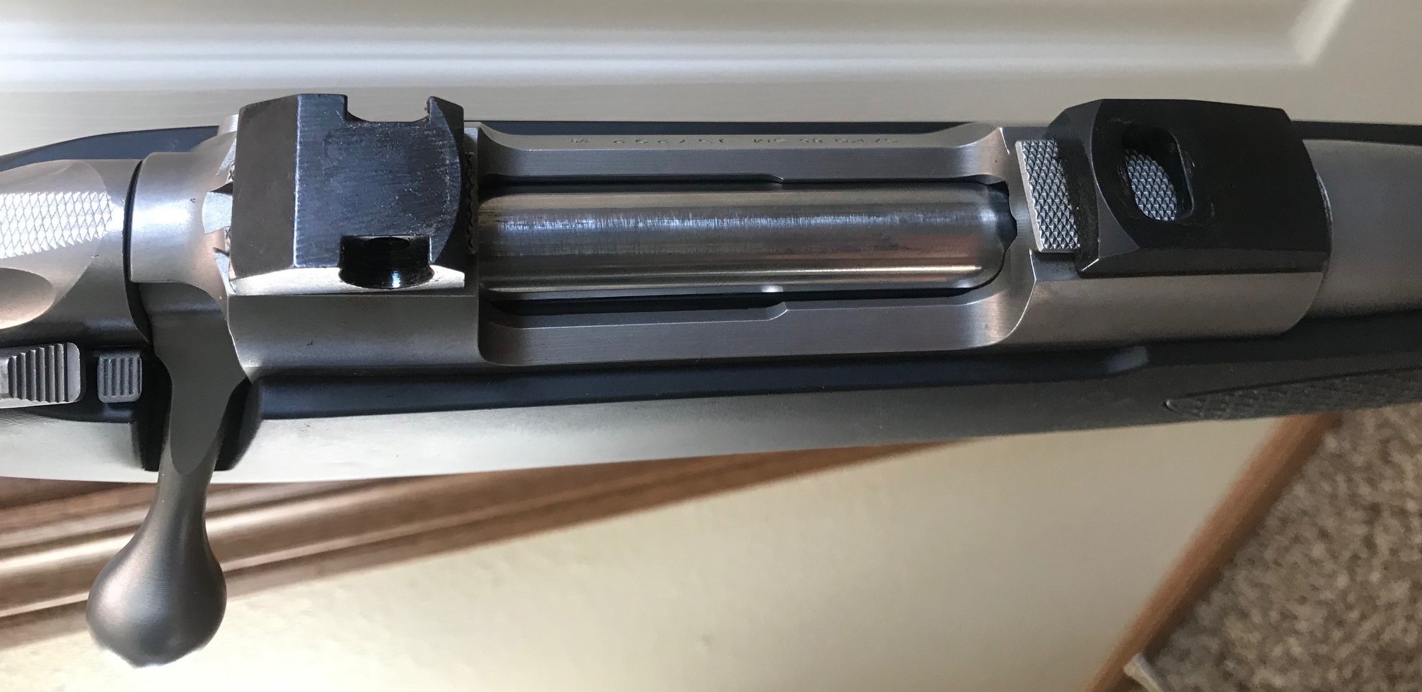

The taper is now obvious without the bases. Put 'em on going forward, off toward the rear. Obviously so the opposition to the recoil pushes the base tighter, not looser.

I would not drill/tap. Here's why.
From thier FAQ:
Frequently Asked Questions
Question 1) How do your SAKO 85 rails attach to the rifle?
Answer: Our SAKO 85 rails use a light press fit onto the dovetails and have a
positive recoil stop machined as part of the rail.
Question 2) There are no screws or clamp bolts. How can this be secure?
Answer: The SAKO dovetails use a 31:1 taper. This is a self holding taper by
any engineering standards. When a customer selects the matching rail for their
particular action length, we are aiming for a 1.5MM to 2mm of press fit. In other
words, when the rail is slid forward with firm hand pressure only, the base will
stop short of perfectly aligned by about 2MM. Using a wood dowel set against
the aft end of the rail It will take several light hammer taps to seat the base
properly as it advances the final 2MM to the recoil stop. If 20 Kg of hammer
impulse was needed, then you would have 640 Kg of clamping force or over
1000 lbs. Your base is very secure.
