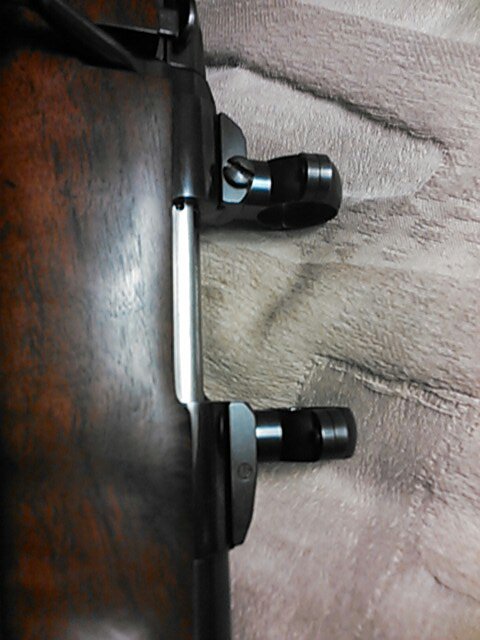

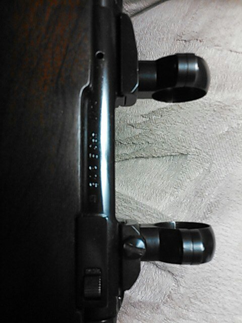

I just bought an older Sako 6PPC USA. It has a "B" series receiver B375. I am a little confused on what rings/bases will fit this? Standard Sako optilock? It has 1" rings and bases now but ideally I would like to get 2 pic bases for it if possible. Anyone have a direction to point me in?

Here are some pics of the setup thats on there.

the ones on there look like redfield style, leupold or Burris probably- There is a turn in dovetail front ring and windage adjustable rear.
If you want to mount a 30mm scope yuo could use Sako"s proprietary rings either the 2 pc Optilocks or optilock Ringmounts.
I tend to prefer the ringmounts as sako's have the built in tapered dovetail why complicate it with a seperate base?
If you want a picatinny type base then IOR has a version: SAKO Tactical 1913 Picatinny Bases
I have also heard that richard near will still make or has some old stock of his bases but I cannot confirm this- would probably be worth a phone call if you are set on a picatinny.
If it was me though the optilocks are pretty easy to get ahold of in the size you need and will work to get you up and running with very little drama and will work just fine....
