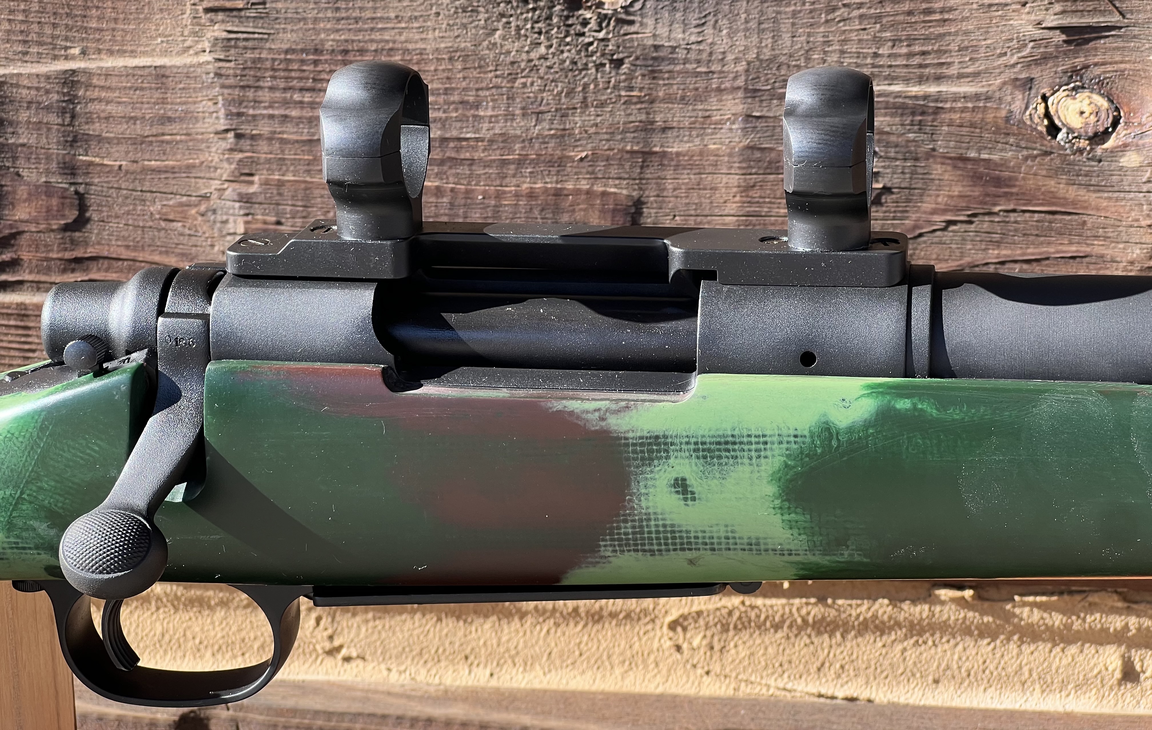

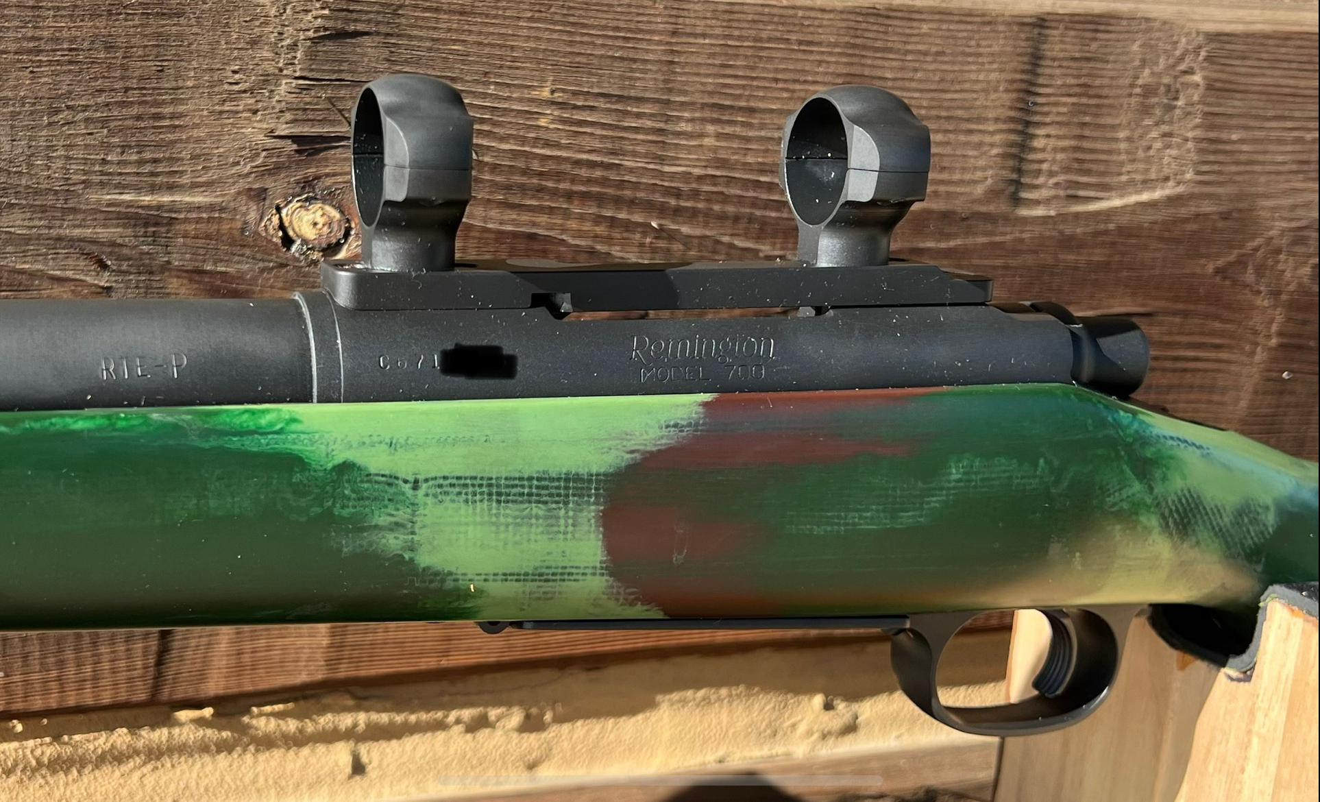

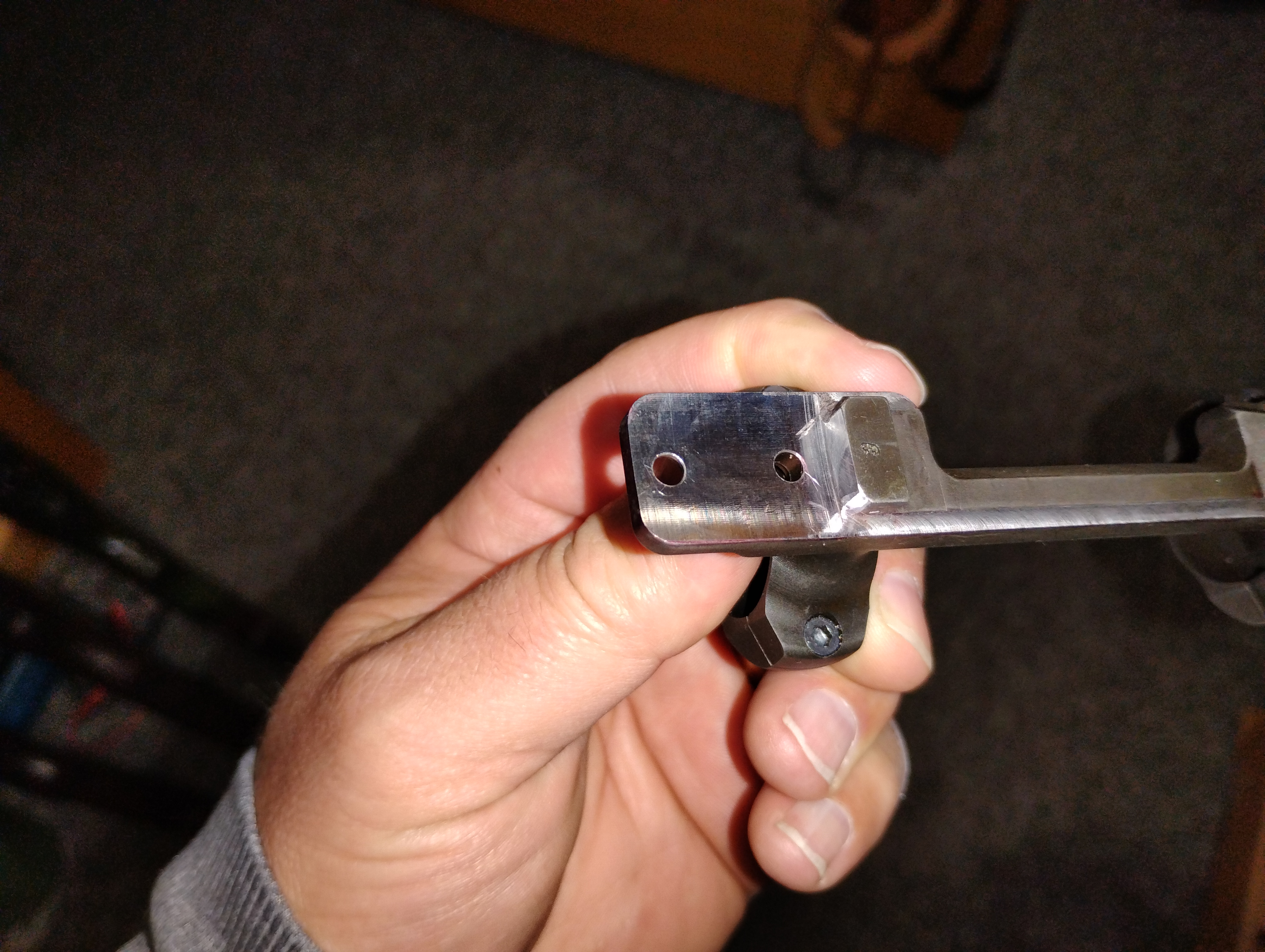

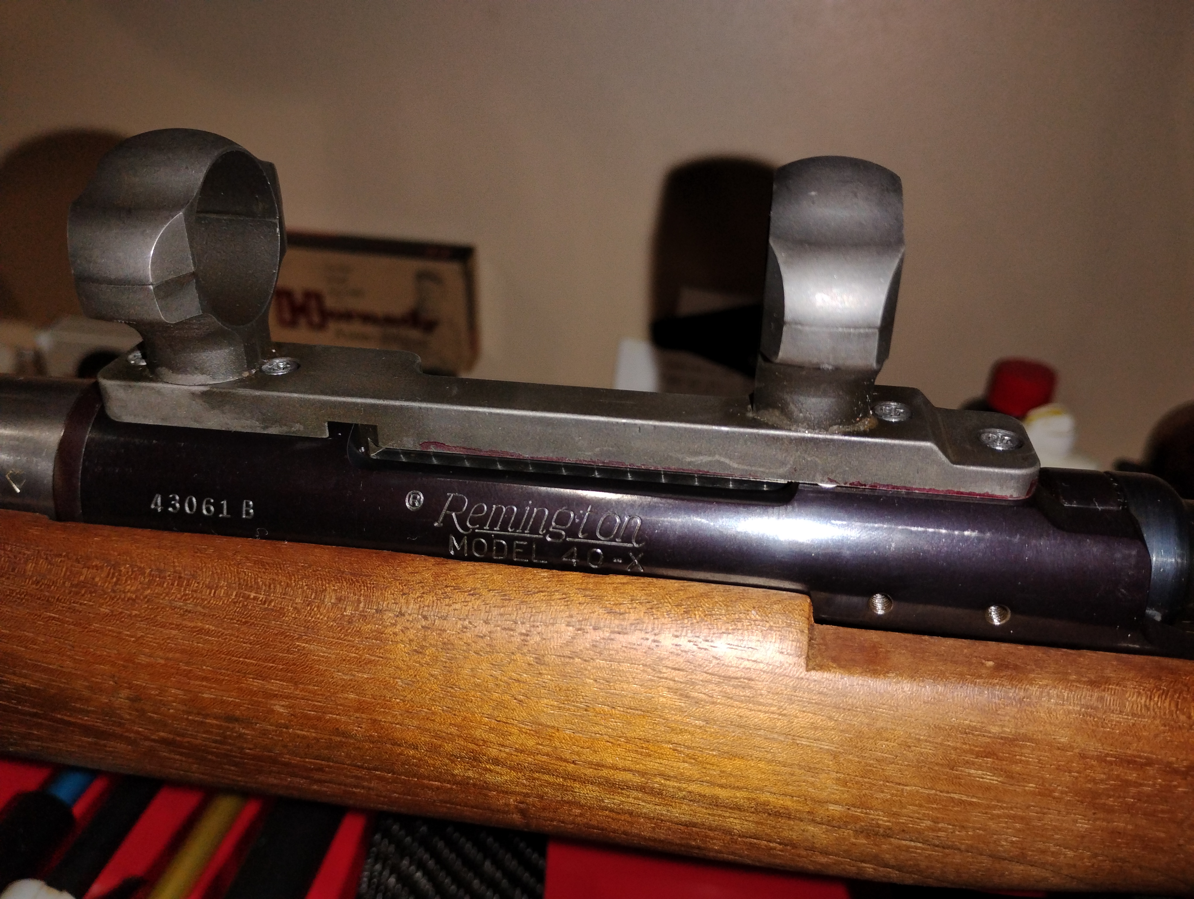

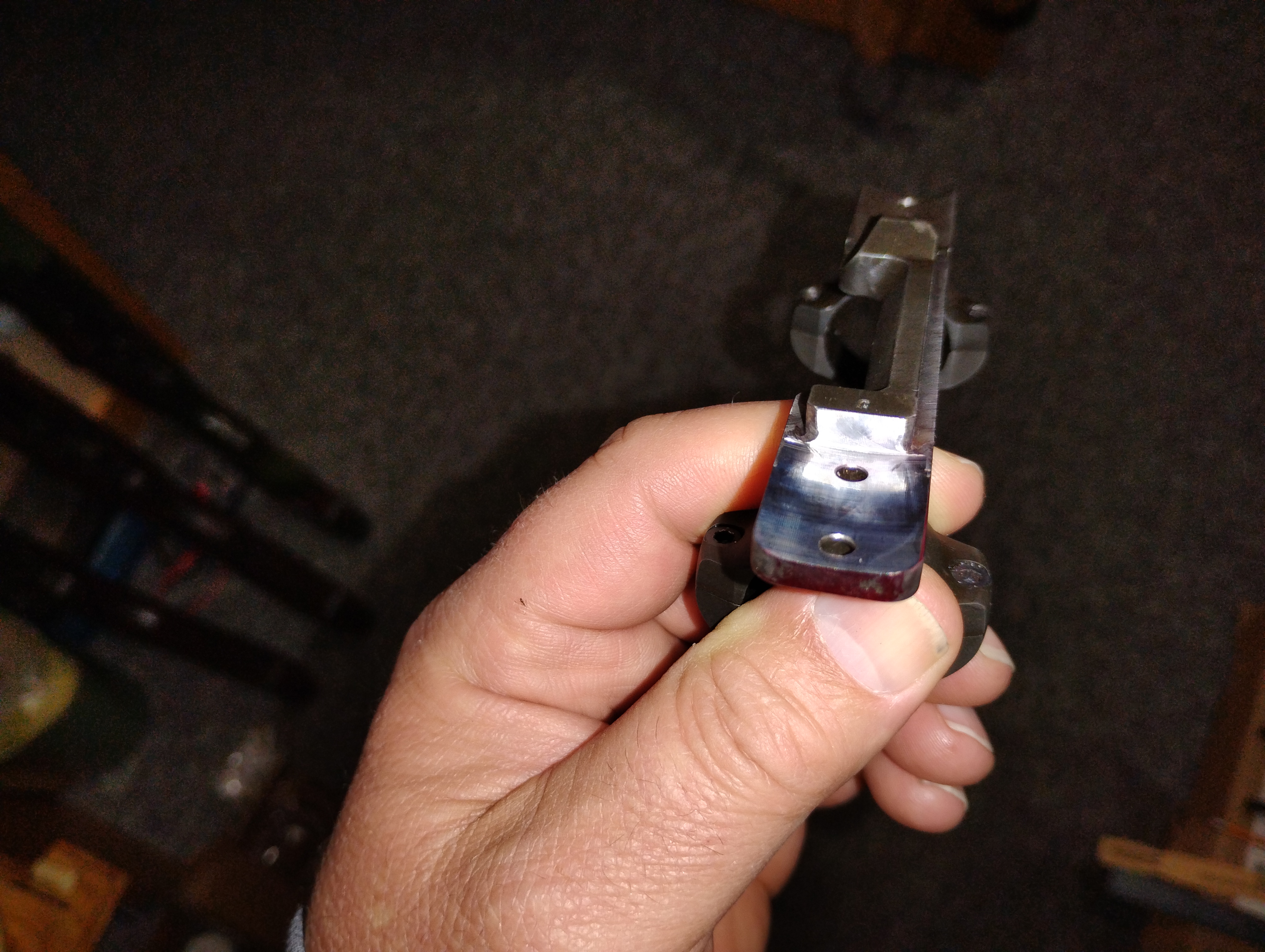

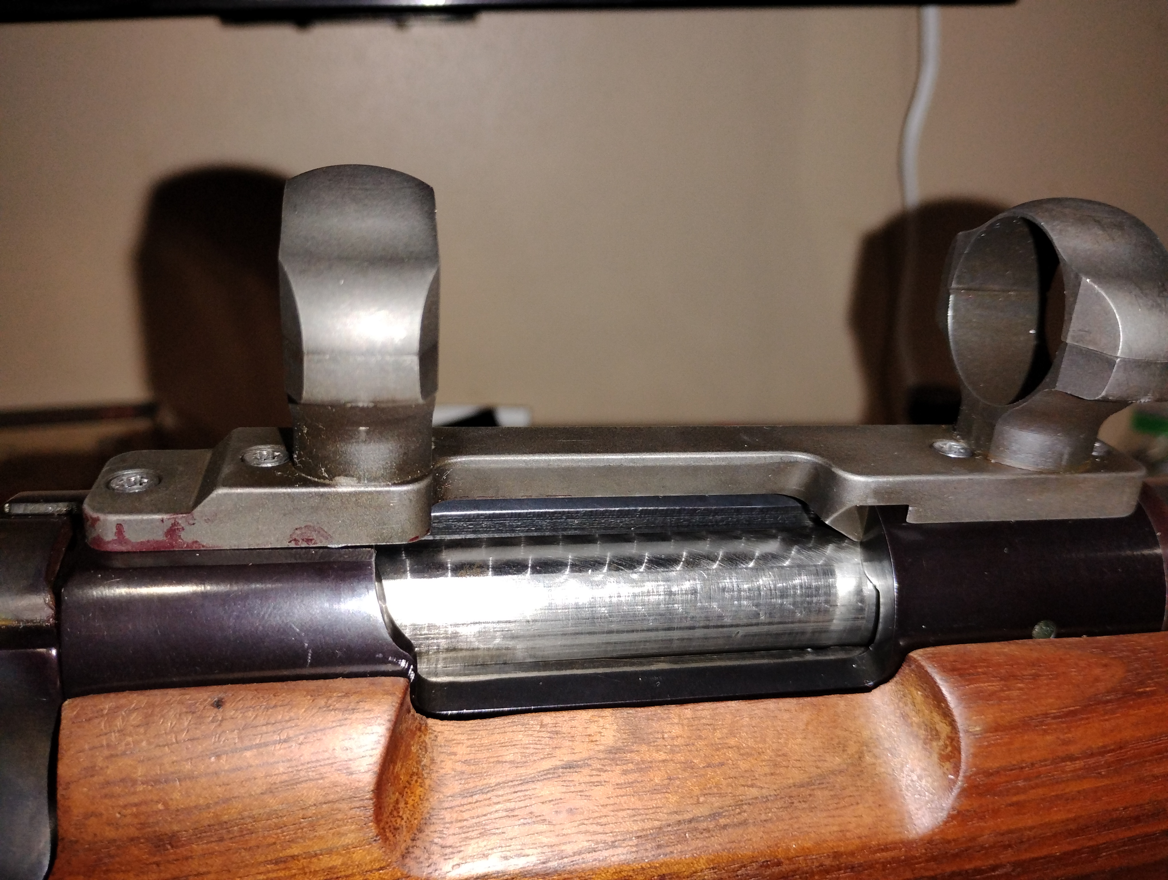

So here is a update on the mounts. I took one of the ones I got and fit it to my original 40x action that was clip slotted at the Remington factory custom shop.
I had to take off about .020" from the back side of the rear lug. I put a 45 degree chamfer on the back corners to make sure the back corners so it didn't get tight there/bind with that inside radius of the clip slot on the back of the receiver. The angle was about .050" on each back corner I did.
The mount went on to the receiver with no issues.
It did sit higher because that back tang as to how it's machined. So I did some checking and was involved with a conversation with George at GAP and a few others. The sample mount that the shop had... didn't have the bottom of the rear tang have the radius to match the rear bridge of the Rem. 700 action. I was told that that was intentional to give the mount some built in moa for the scopes to have enough elevation out to a 1k yards. Land even told me that.
If I was going to do the mounts myself... I actually had two versions in mind. One matches what we got which is the same as the Ice mounts but then I did one with the rear tang to match the Remmy rear bridge. I just thought it would look cleaner.
We think the one mount supplied was a really late version where the intentions was to true up the rear receiver bridge and then fit the mount to the receiver. It was jokingly told to me maybe we should call it M40A1.2. Rumor I was told it was Chandlers idea. I can't confirm that myself. Anyways for whatever reason... here is where it's at.
GAP is getting they're mounts reworked so that rear tang will have the radius done to it so it matches the receiver.
I took the mount for my 40x and went on a limb here myself and set it up in the mill and cut that radius on the back bottom of the rear tang to match the Remmy action. Think it's a 1.819" radius.
I like how it looks much better. So the maker that made the mounts... if anyone wants they're mounts rear tang modified to match the rear bridge. Send it in and they will rework it at n/c and return it back to you. If you want yours done... PM me and I'll get you the contact info.
If anyone buys the ICE mounts it won't come with that rear radius either. The first ones didn't have it as well and I got one of them.
Here is some pic's of the mount that I fit up to my 40x. On the edges of the mount the funny looking discoloration is from when I put layout die on it before I machined it to fit.
Later, Frank

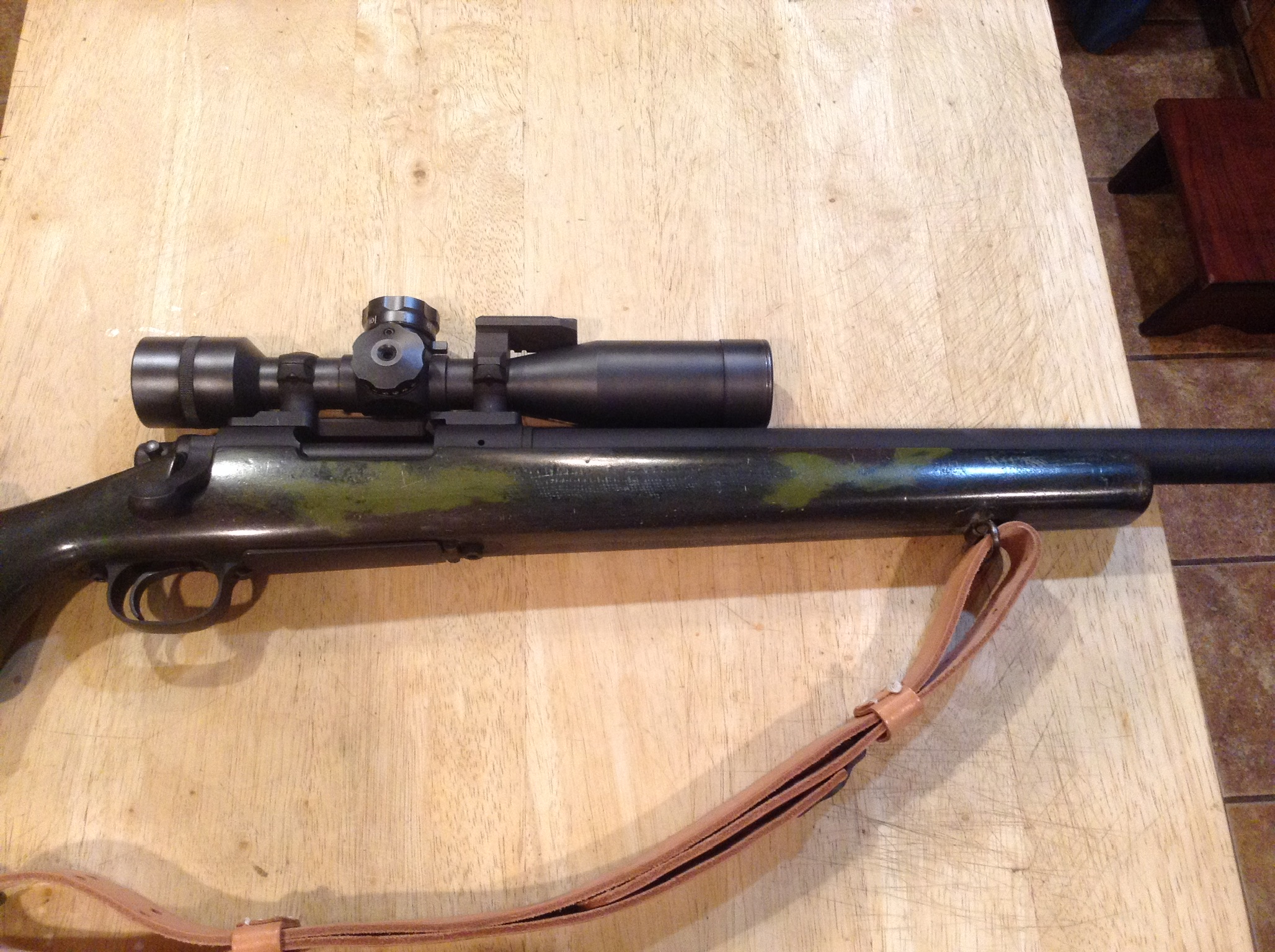

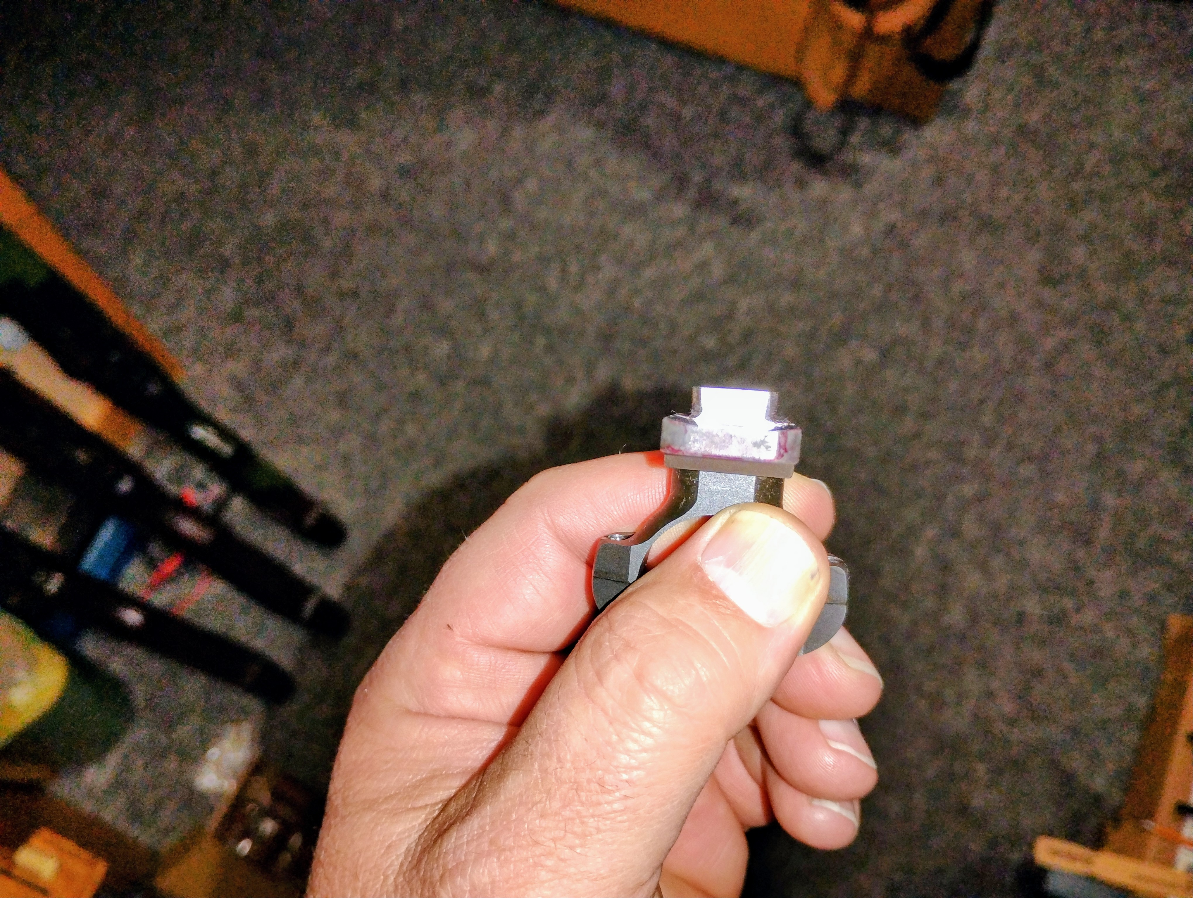

Frank, I have a real M40A1 mount. Would it help you in anyway to get any info off it? I do have an actual schematic of the original M40A1 mounts too, but I don't know if it has the measurement on it or not.
This is an original in that spot.
Here are a couple original M40A1's in Marine inventory. This is how they sit. I would be curious what these look like and how they fit on there without any modification. Because there is a slight Gap in the originals but that is because of the way the underside is cut.
Reactions: Frank Green

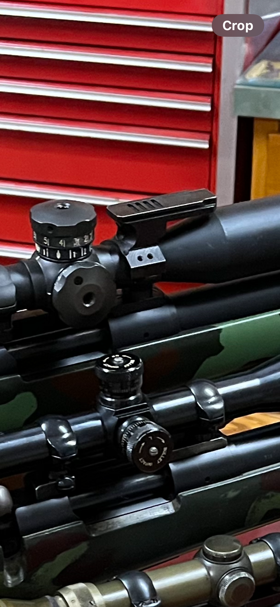

I received two ICE M40A1 mounts and have to say that I am very pleased with them. The machine work and attention to detail are the best I’ve seen BY FAR. I have an original to compare to… these mounts are just what anyone who has been patiently waiting for to be produced…. Delivered. Couldn’t be happier.

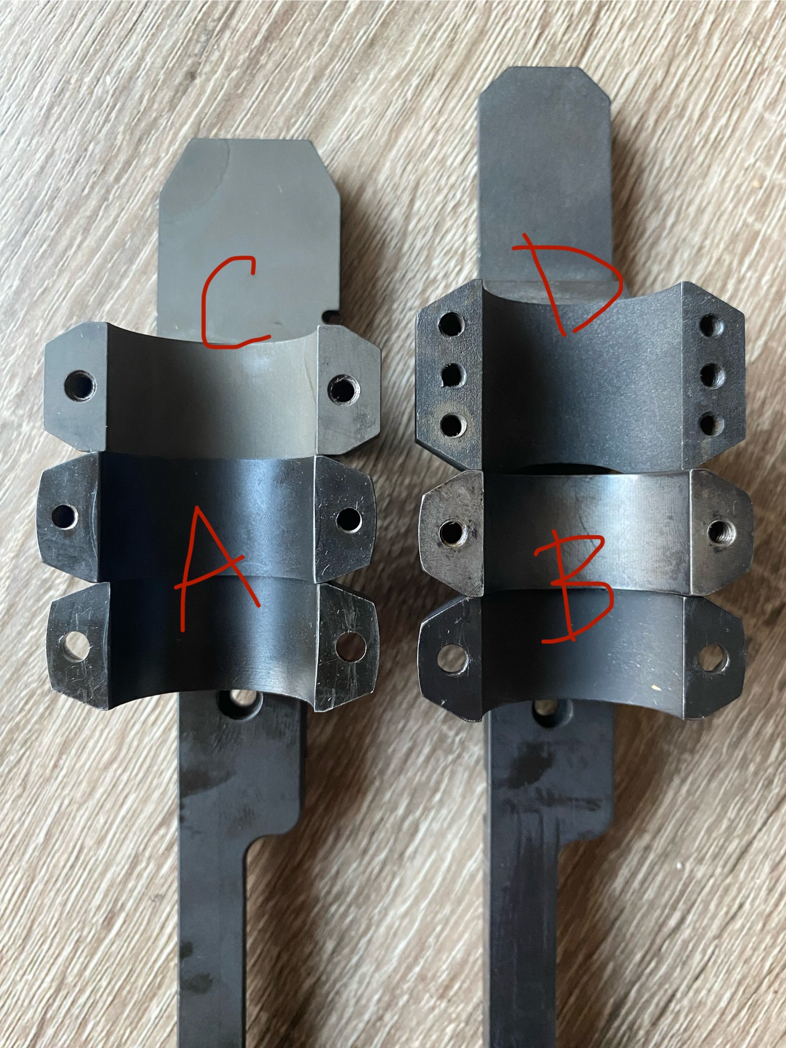

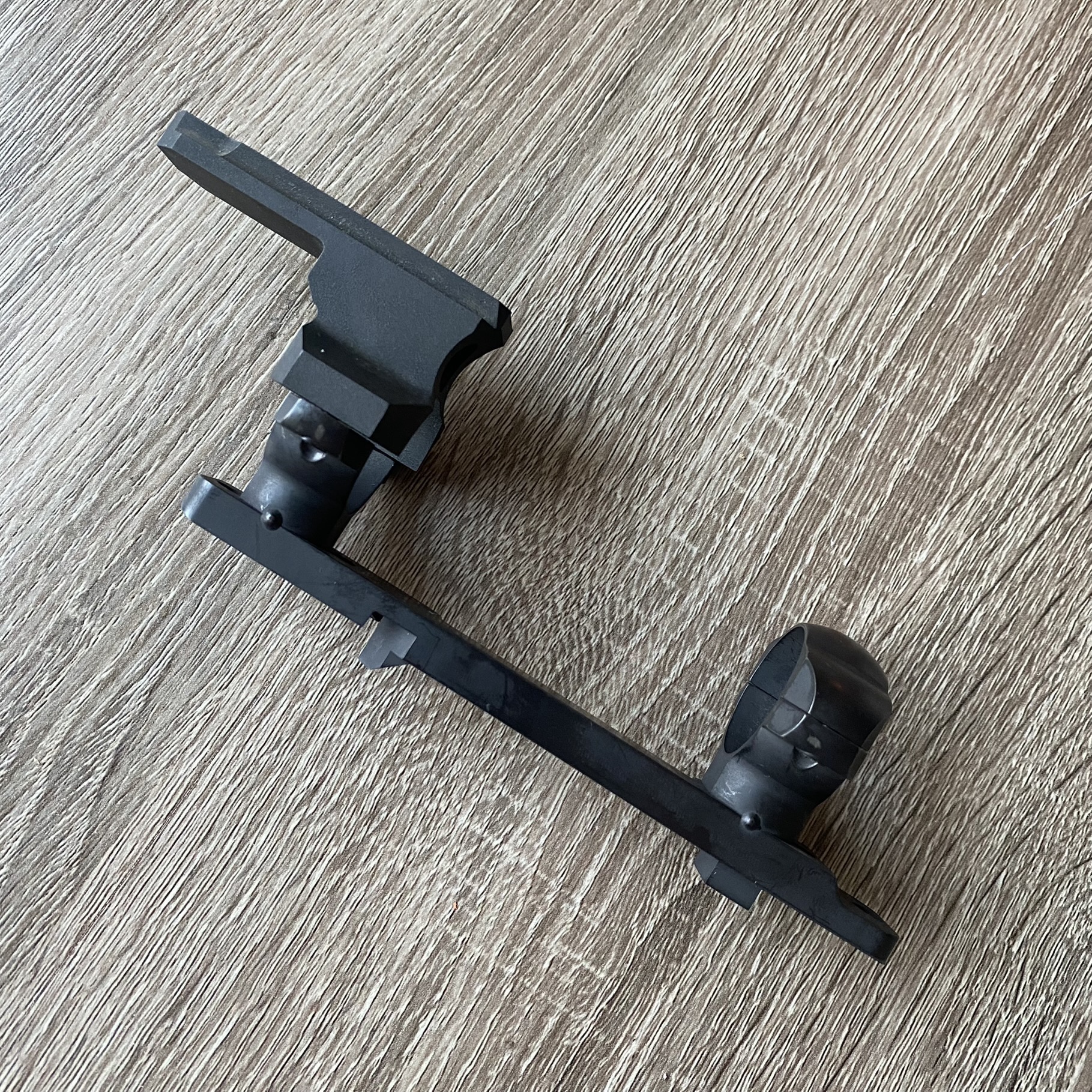

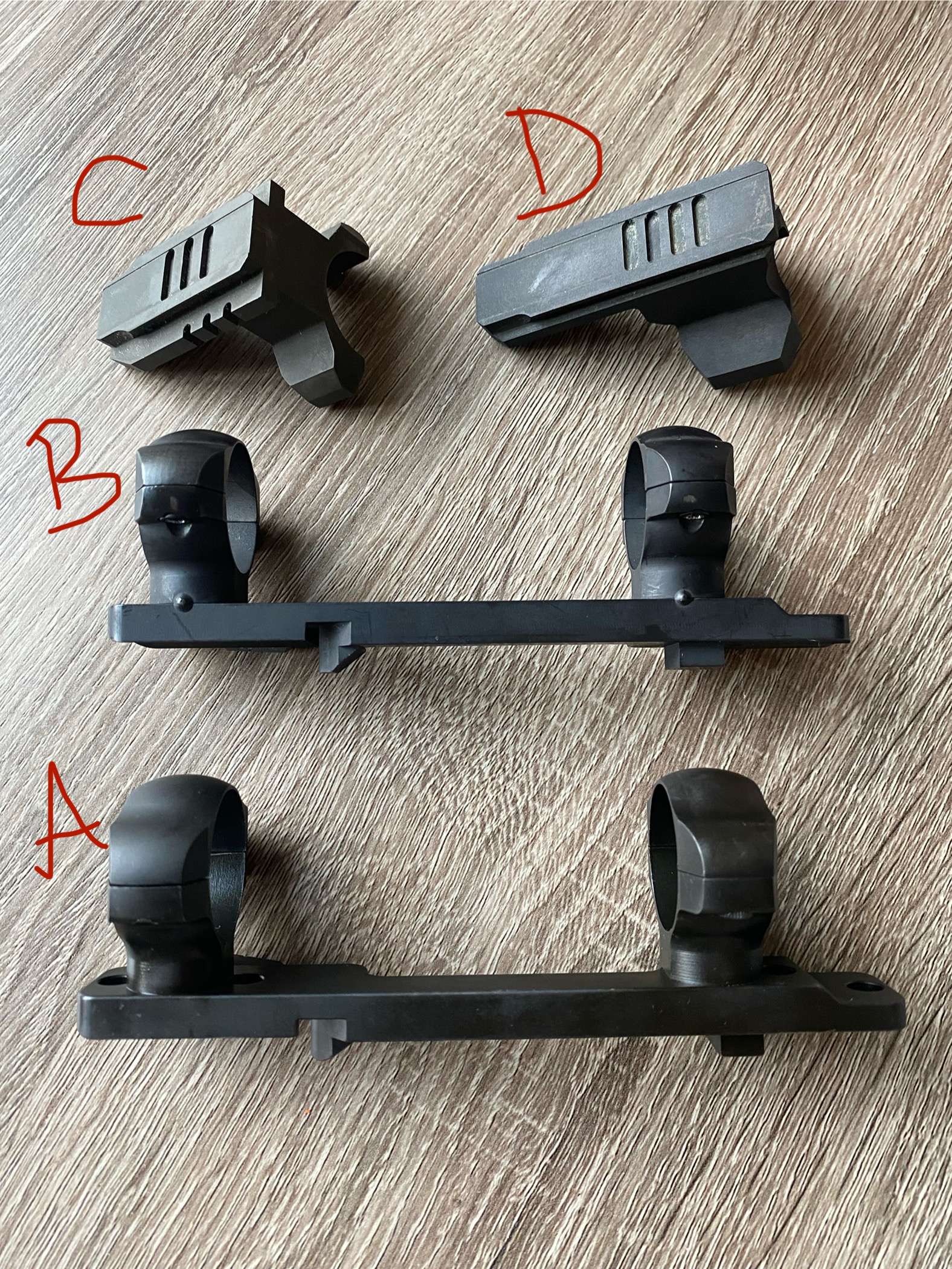

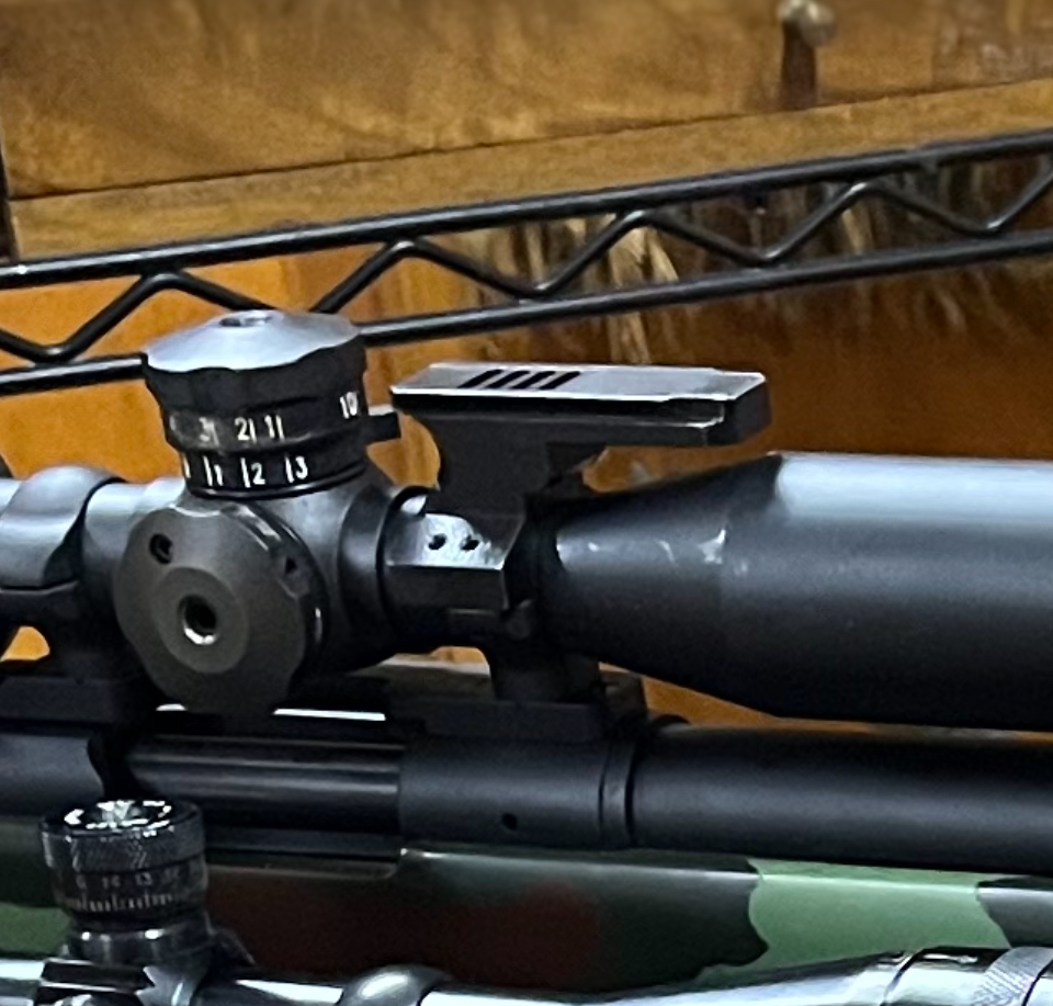

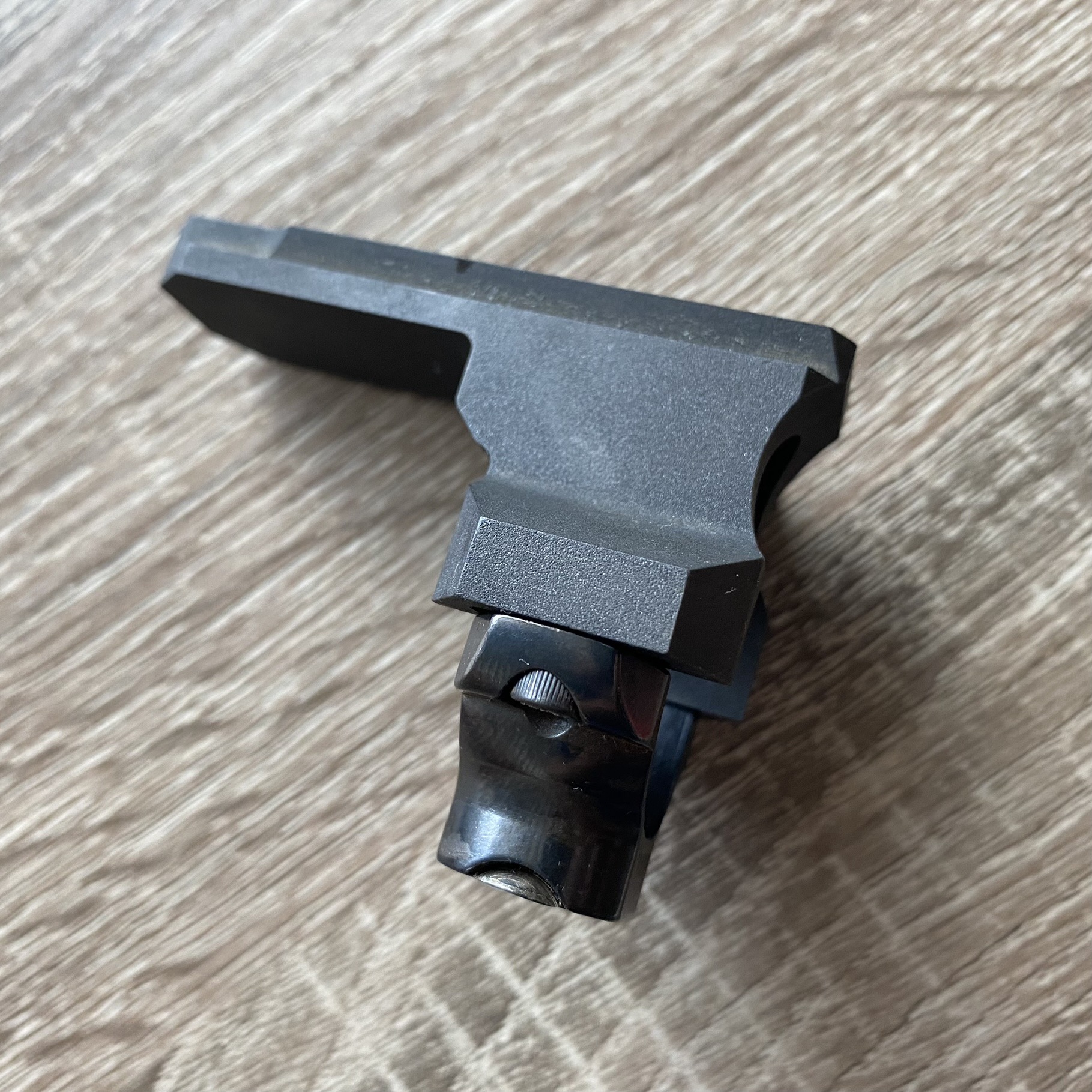

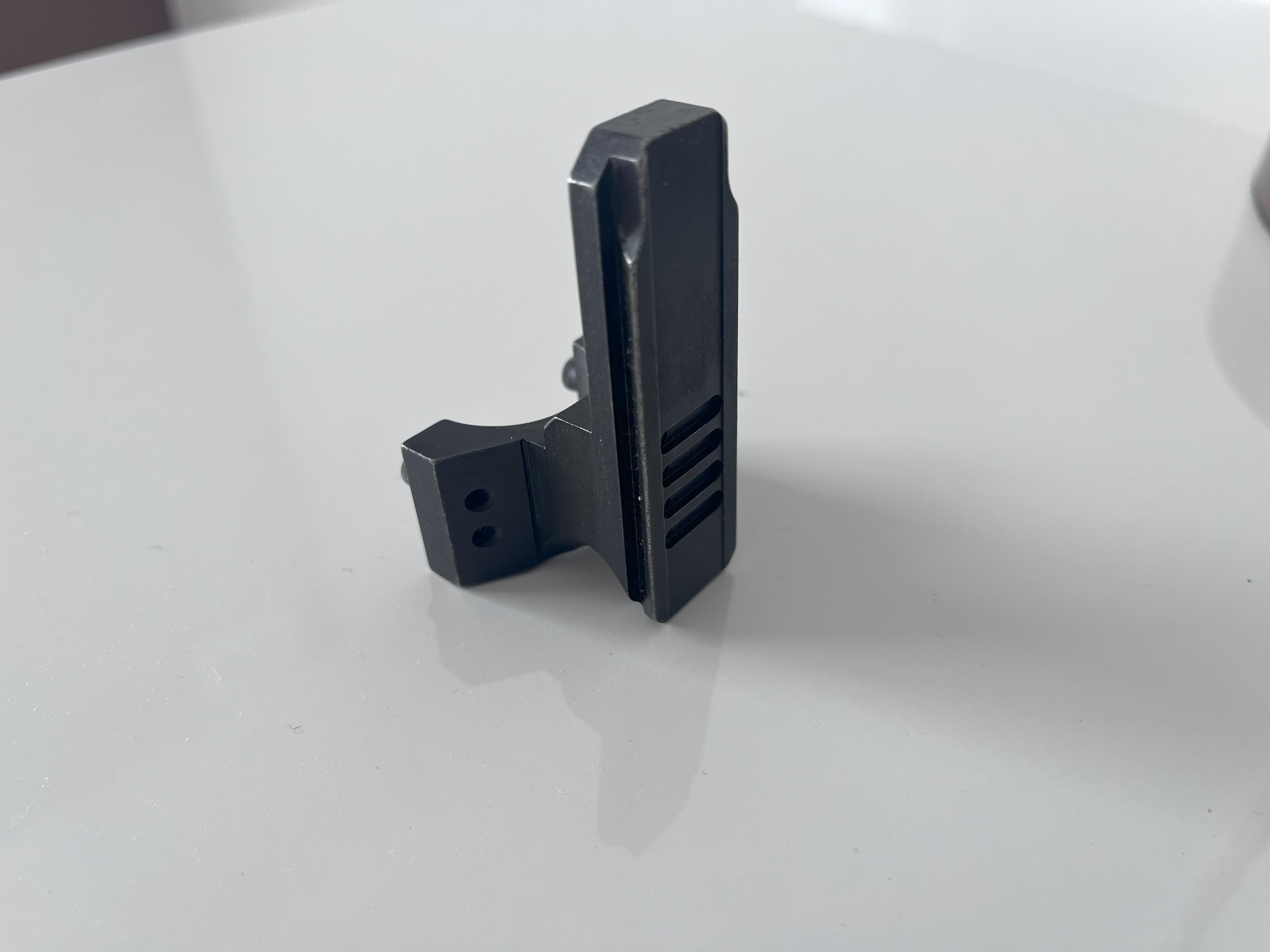

So for those interested in the fit of existing or prior production simrad caps for these mounts, I did a fit test with:
A. Repro mount from this group run
B. Original Unertl mount (supposedly according to the person I got this mount from and compared to other real Unertl mounts I have)
C. Badger Ordnance simrad cap
D. TheHogsDen/TwoManAttack simrad cap
So here’s what I found out:
- The original mount and TheHogsDen simrad cap hole spacing are pretty much centered horizontally on the split halves contact faces
- The repro mount from this group buy has its hole spacing non-centered and are located slightly outboard
- The Badger Ordnance simrad cap has its hole spacing non-centered and are located slightly inboard
- Though I did not take calipers to the hole spacing on each hardware, you can visually see the difference in the below photo (the edges of the ring halves do not line up in the photo due to height differences, but they are all basically the same on the inner diameter)
Therefore, and based on fit tests with all different combinations of hardware:
- The original mount and TheHogsDen/TMA simrad cap fit together. This is also confirmed with other original Unertl mounts and TMA simrad caps I have with my existing M40A1 builds
- The repro mount from this group buy will not work with either Badger or TMA simrad cap without modification
The (only) combination mount and simrad cap that will work together without modification:
There are a run of simrad caps being made for the repo mounts on this group buy. The cap was also loaned from Ed Land that is being used to make them.
The more I find out about the caps and mounts… the more variations that seem to exist. From what I’ve gathered so far… 3 slightly different variations of original mounts is what I’m getting. Best I can come up with.

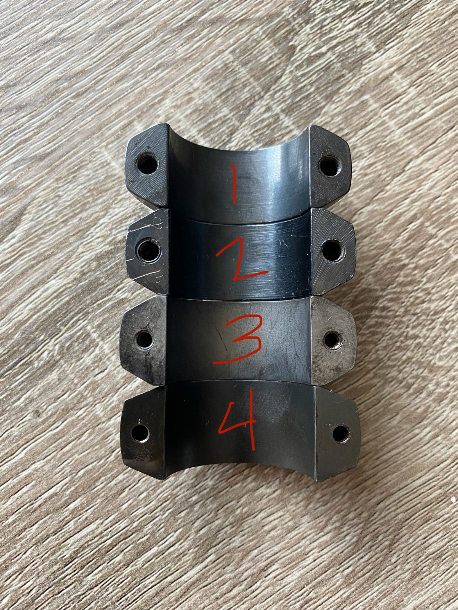

I compared:
1. Original Redfield 1” bottom screw ring
2. Another Redfield 1” bottom screw ring
3. Unertl M40A1 mount ring
4. Ring from this repro mount buy
So one surprising tidbit (to me anyway) is that the original Redfield rings use a larger screw than the Unertl or repro mounts (same size screw used for the simrad caps, obvi). I haven’t measured it, but I’m guessing the Redfield rings use the common 8-40 screw.
Aside from the screw size difference, the rings on the real Unertl mount I have are exactly the same as the Redfield rings, including corners of the bevel lining up and the positioning of the screw holes (basically in the middle of the surface faces). Cannot swap and tighten the ring halves between them due to the screw size differences, but eyeballing the smaller screw Unertl top ring onto the larger holes of the Redfield bottom ring, they do line up.
Tried screwing in the Badger simrad cap onto Redfield bottom ring, but even with the Redfield’s larger screw hole, could not tighten down the second screw due to tension with the non-aligned hole spacing (the Badger simrad cap’s screw holes are a bit inboard vs centered).
But since the HogsDen/TMA simrad cap’s hole spacing are also centered and fits my original Unertl mount, it fit the Redfield rings as well:
