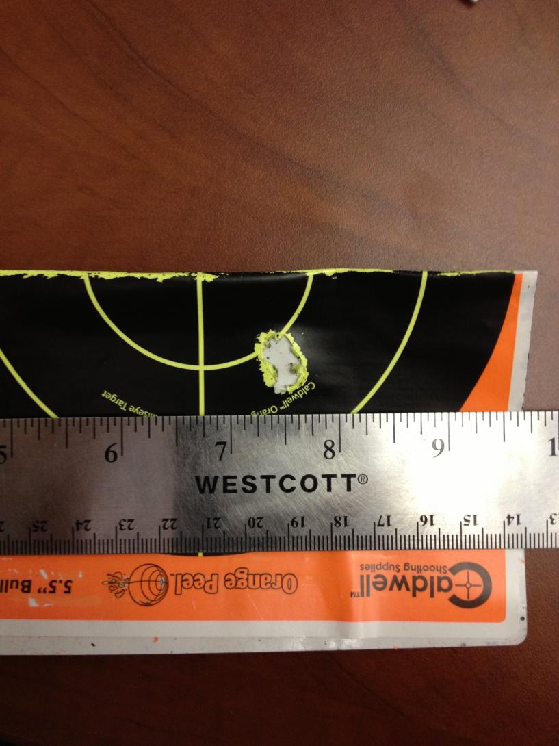

I just bought a trg 22 and had it to the range only once. The rifle will outshoot me. We put about 75 rounds through it with 4 different shooters all but a few 5 shot groups were under 1" at 100 yds using a mix of reloads from my dpms lr308 including 155 and 168 amaxs, 168 and 175 smk.
Here is the picture

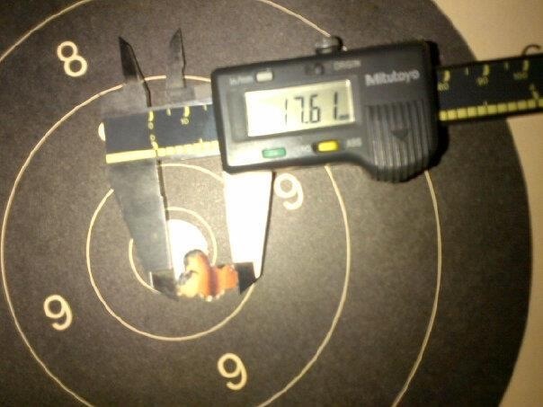

Okay here are my results for the day. I'm hoping someone can help make sense of this:
100M
200M
Group Size determined with a digital caliber measuring ring to ring, and subtracting 0.300". MOA is determined by taking the CTC value and dividing by 1.141 @ 100M and 2.282 @ 200M.
MOA shown to have an apples to apples comparision to those that shoot at 100/200 yards.
Pic 1 100M:
From top left to top right.
1. Federal 168gr Sierra Matching BTHP GMM: 0.633" or 0.555 MOA
2. Hornady Match 155gr OTM W/C: 0.834" or 0.730 MOA
3. Hornady Match 155gr OTM W/C: 1.342" or 1.176 MOA
Middle left to middle right.
4. Hornady Match 168 gr AMAX: 0.765" or 0.670 MOA
5. Hornady Match 168 gr AMAX: 0.743" or 0.651 MOA
6. Hornady Match 168gr BTHP: 1.090" or 0.955 MOA
Bottom left to bottom right.
7. Hornady Match 168gr BTHP: 0.578" or 0.507 MOA
8. Federal Sierra Matchking 175gr GMM: 0.785" or 0.688 MOA
Pic 2 200M:
Federal 168gr Sierra Matchking BTHP GMM: 1.071" or 0.469 MOA
It looks like I have a problem with trigger control...

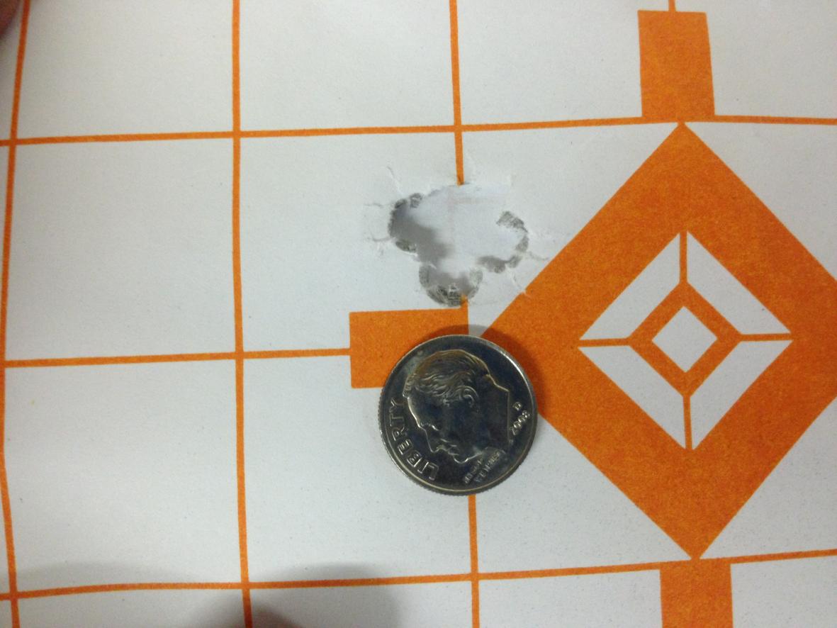

Fired at 100 yards, 3 shots with 155 Lapua Scenars. Group is .2MOA
