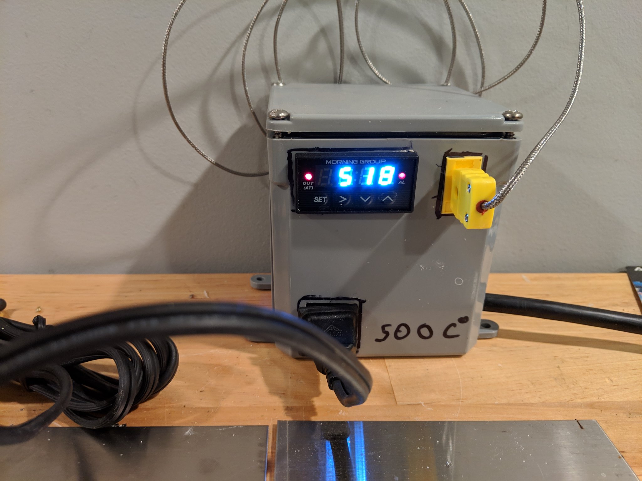

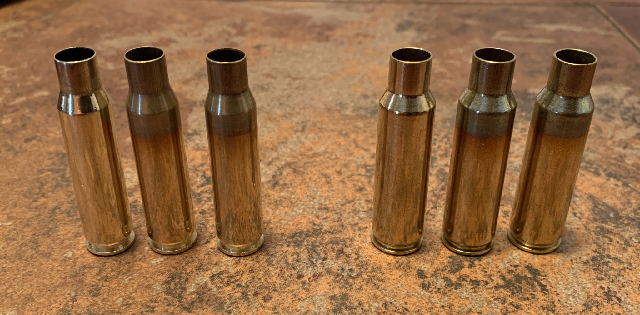

I tried my salt bath Annealing kit today. It was easy to set up and use. I’m looking farward to swing if there is a noticeable benefit when shooting.
2x fires Lapua 308 brass and virgin 338 RCM brass for the test run. 5 seconds @ 500 C°
I used a cut down 30/30 brass to adjust the placement of annealing.

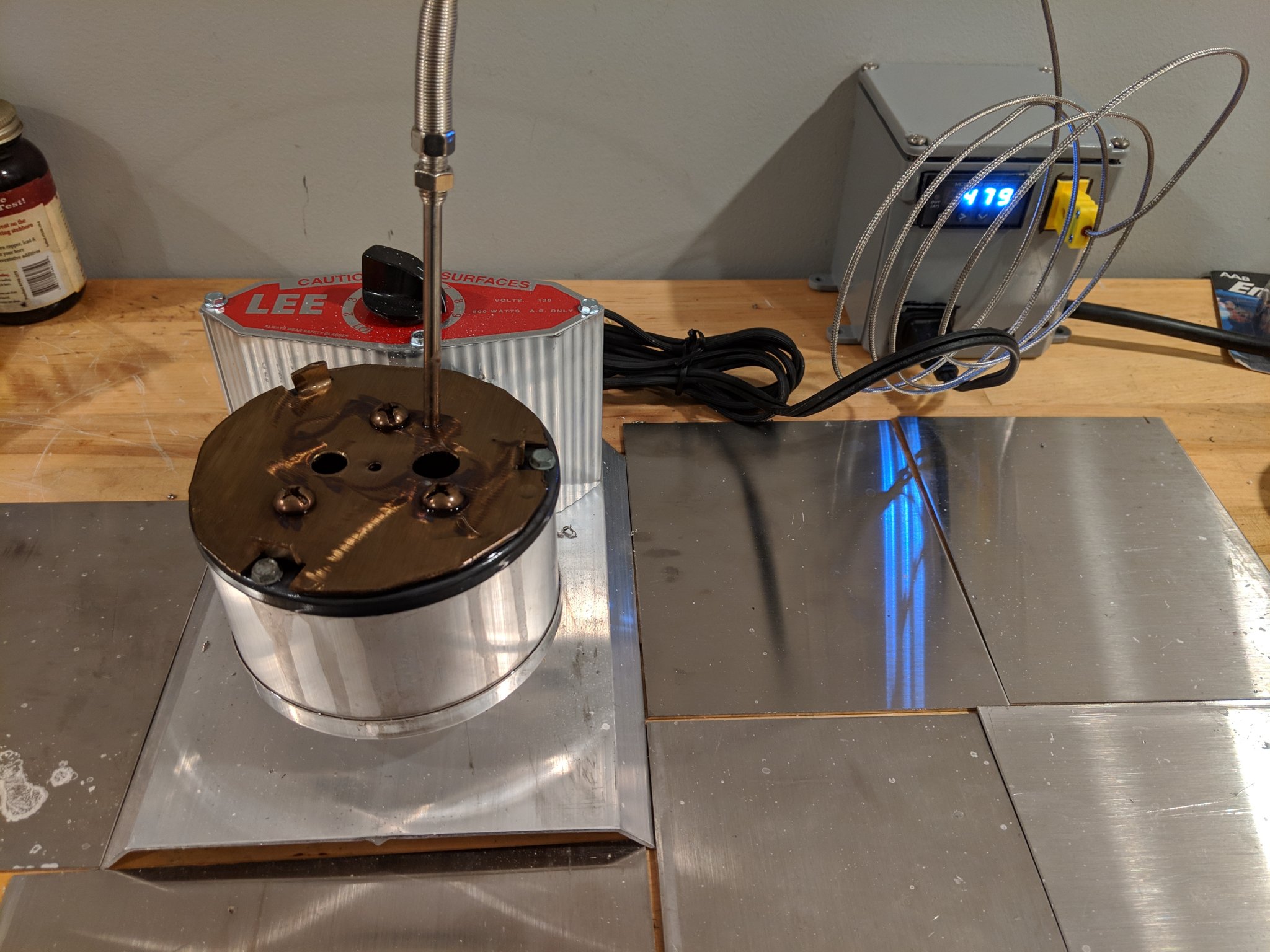

Figured I would share my experience with Salt Bath Annealing as annealing is something I wanted to do for a long time but the fire way seemed crude going the low cost way and a little expensive with me only needed to anneal a few hundred cases per year.
I saw the system you can buy online, but I like to do things myself so I bought the Lee melter on Amazon as well as a relay, temperature controller, and thermonuclear so that I could dial the temperature exactly where I wanted it and the controller would keep it there. I also bought the Sodium Nitrate and Potassium Nitrate salt online rather cheap and I use a 60 Sodium/40 Potassium mix based on some reading I did other places. Below is some pictures of my setup.
I typically set the temperature controller to 550 C and even with my processing brass it doesn't go below 510 C. The thermal couple is rated to 800 C.

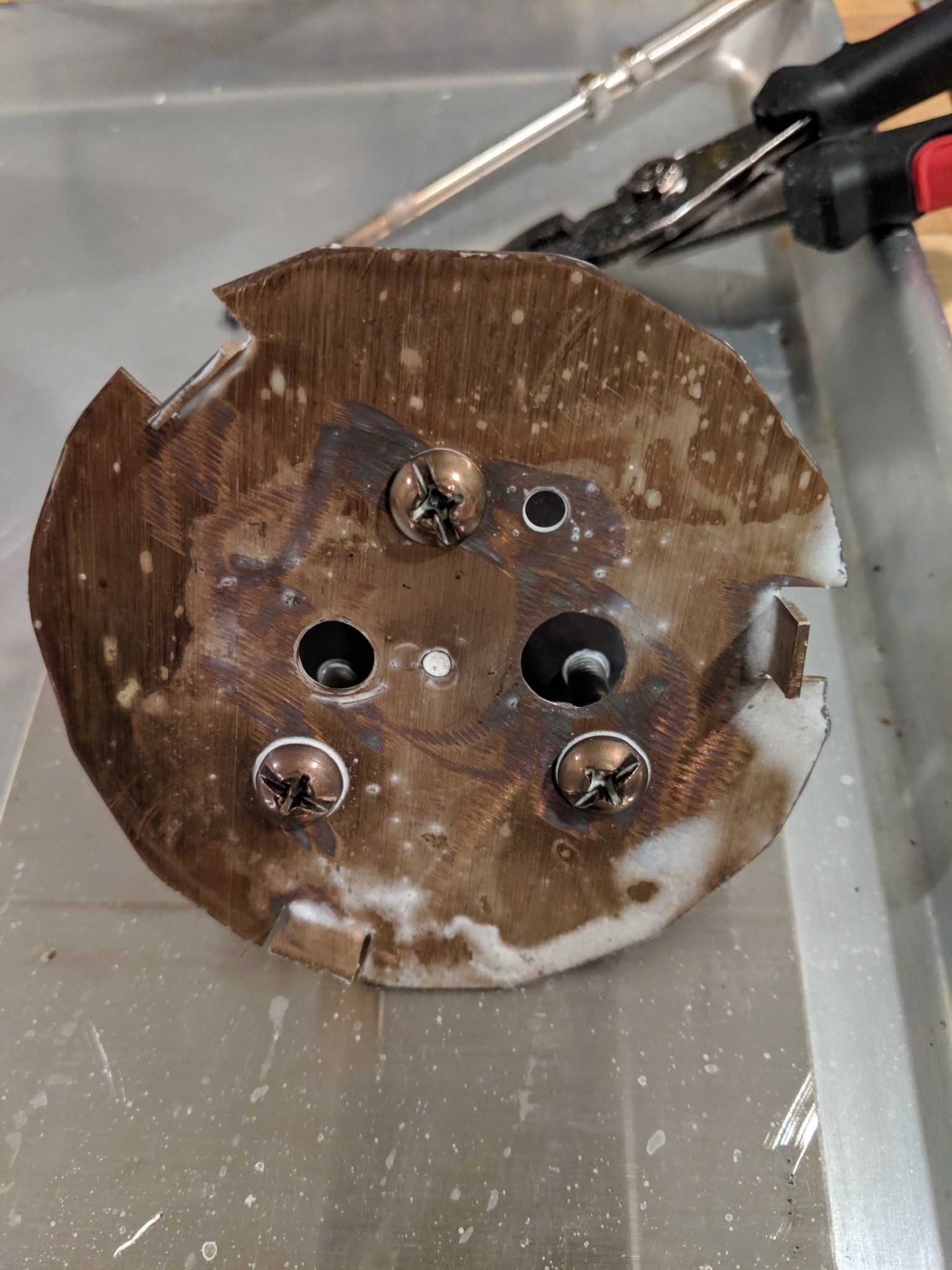

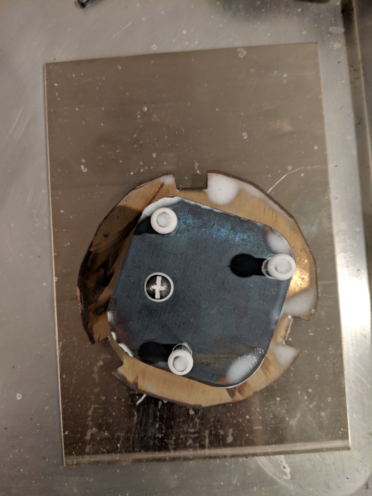

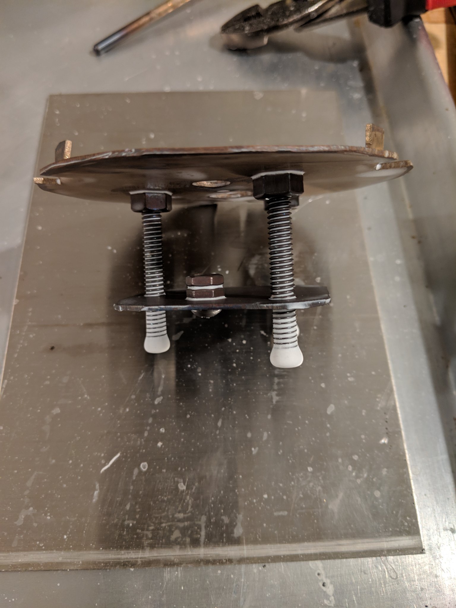

For the jig or shell holder, I'm on my second design. I use a 4" diameter SS plate with one hole drilled to work with .223 based cases and drilled another hole to work with .308 based cases. I tried running a jig that allowed you to anneal two cases at once like some of the videos, but I found it harder to keep the correct dwell times. My top plate differs from others as it rests on the top of the melter with space cut out for the screws on the melter. I then have a sub-plate that is a stop for the cases that is attached with three SS screws. I added a screw and some nuts to reduce the depth on the .223 hole as you can see. I also drilled a hole for the thermal couple. I used a floor jack to make an indention in the middle so that the liquid salt would run back into the bath (first one I built ran over the side).
For dwell time I use an app on my phone which will tick every 5 seconds (Metronome).
There are some changes I still want to make to the jig but overall the system works great and less then $100 into it. Below are some of the things I noticed about using the system.
