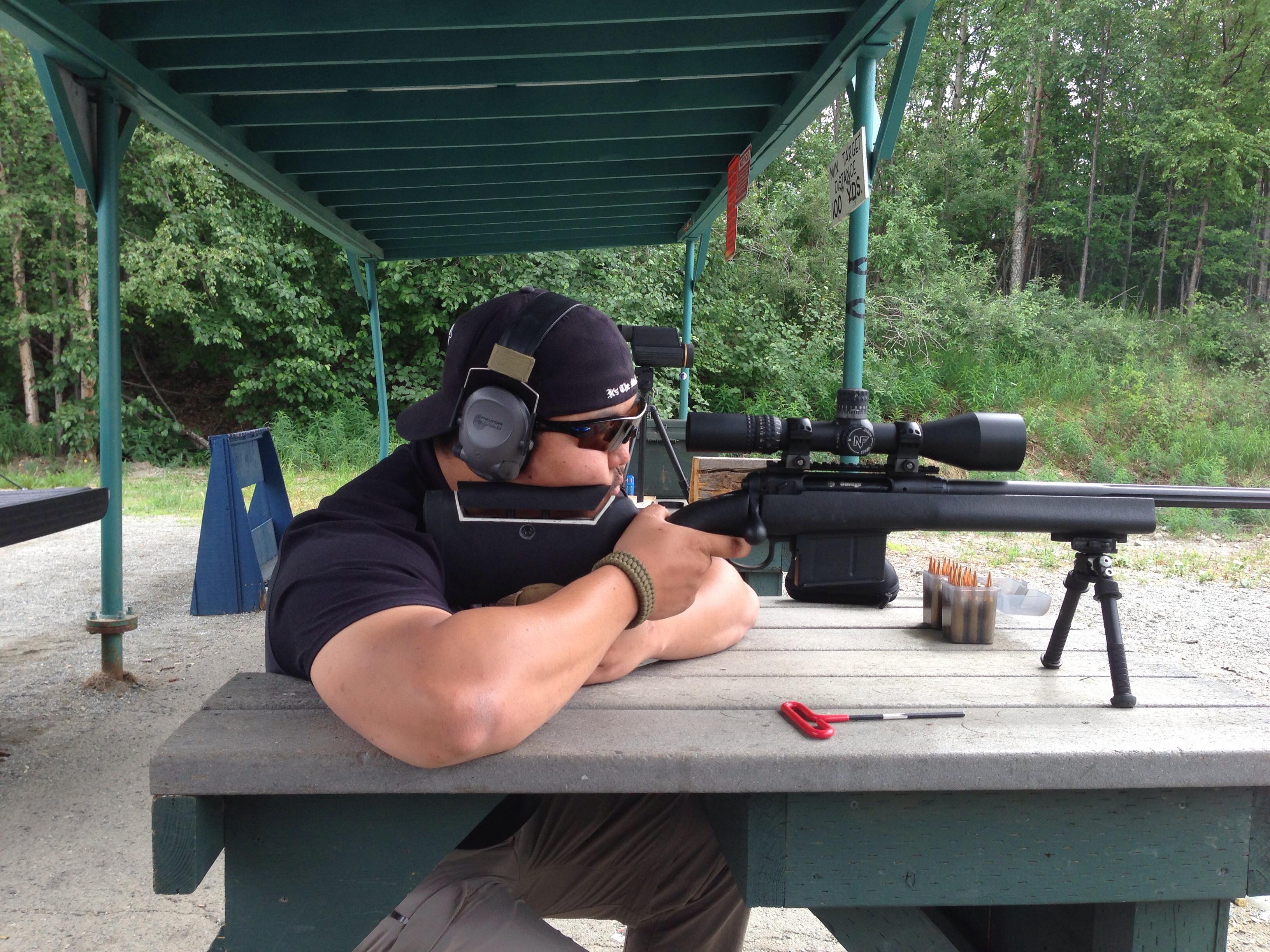

I installed the loggerhead in my HS Precision stock. Not hard to do.
here's the sophisticated cheek piece on mine:
I've since removed it. at the end of the day I decided that I'd rather mount a 40ish mm objective scope low and use the stock as-is rather than mod it for a hubble scope.
