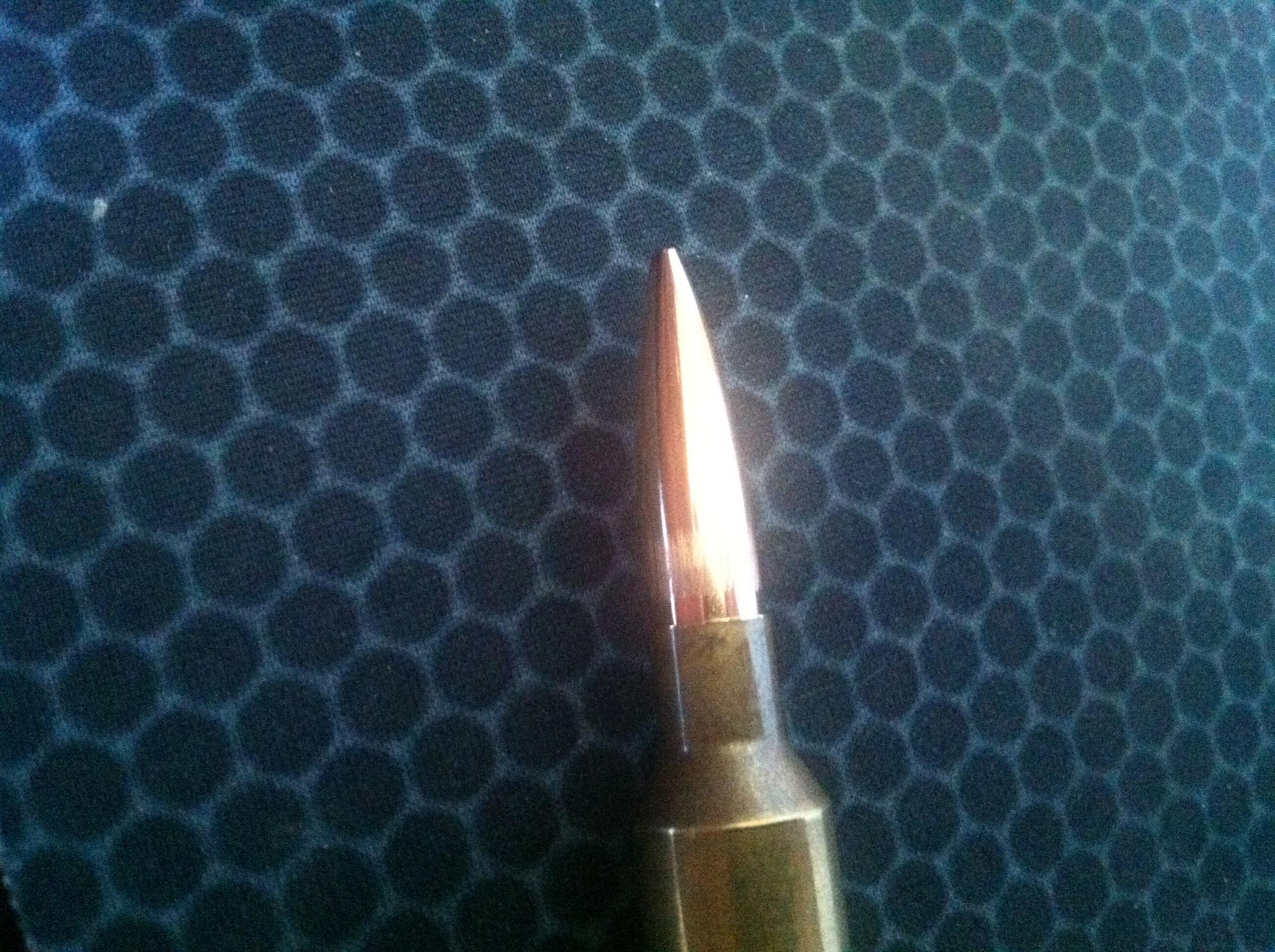

I purchased a new Savage 12 LRP in 6.5 Creedmoor a couple of months ago. I've been reloading for it with Nosler 140CC bullets since I got it. Recently I purchased Lapua 139gr, and 140gr Amax bullets for it. When attempting to chamber rounds loaded @ 2.800 COAL with any of the Lapua or Hornady bullets, I'm noticing that the last 1/8 inch of bold close is very tight. When extracting the round, there are marks all the way around the bullet as shown in the pic.
I've attempted to reload the 140 amax bullets, but about 50% of the time, I'm getting extractor marks on the brass at a safe load of 41.5gr H4350.
By comparison, the Nosler 140CC load I've been using for about a hundred rounds is 42.4gr of H4350. That load displays no pressure signs at all. The Nosler bullets aren't getting marked in any way and load and extract cleanly.
I'm assuming that the issue is with the shape of the Lapua and Hornady bullets, and that my Savage throat is very tight. This is causing increased pressure on the Amax loads. (Does this sound right?)
If this is what's going on... what's my best option? Should I find a local smith who can resolve the issue, or should I just send the whole thing back to Savage (and hope they do something to fix it). I'm hesitant to monkey with it, its the most accurate gun I own with the Nosler bullets, but I really want to be able to shoot other brands also.
Any advice would be appreciated, Thanks!

Looks like the free bore is too tight. It doesn't look like it's into the lands. Give Savage a crack at it. At least it's not pulling the bullets on a live round extraction, which makes a damn mess. Seems like a lot of Savage issues of late with chamber/throat issues. I agree with you that you should be able to run any bullet (proper spec) without problems.

I have measured the base to ogive with a comparitor as well, and set that depth on my reloads to the same measurement as factory ammo. My real issue is that I cannot use factory loaded Hornady 140amax rounds in this rifle. That's the problem I sent it back for.
If I had the correct wrench and barrel vise, I would have checked myself. I'll end up investing in those tools someday... but for this issue I just sent it back to Savage. I'm expecting my new savage rifle to function correctly with factory ammo.
Sure u can use the factory, just bump them back.lol. Savage tends to be sending out 6.5cm and 308with shorter throats, don't know what's up with that. If they run their chamber reamer in, the same one that made the chamber, then most likely it will still be the same. A smith could run a 6.5 thoat reamer and set it to whatever u want. I have heard their 308 chamber is optimized for 168smk, not sure about 6.5cm. It could be worse, remingtons that i've owned had the freebore out near the crown.
41.5 of H4350 is printed on the box of factory Hornady 140 AMAX ammo. But I didn't start there. I started at 40 grains and worked up slowly. My real issue is that I cannot use factory loaded Hornady 140amax rounds in this rifle.
Agree that a factory new rifle should digest any ammo. If you have a regular bench vise, you won't need an action wrench. I have only had to use a vise on two of a few dozen rifles, just the wrench is what it typically takes.

My brother in law forwarded this thread to me. I also have a savage 12 LRP in 260. Mine came from the factory without the throat being deep enough. I had mine repaired with a local gunsmith, who lengthened the throat by .0120. Rifle would shoot really well before, but it shoots lights out now.

He had a gunsmith lengthen the throat. I think he paid $120.00 to have it done. His bullet is way out there now. My 260's COAL for a 140 VLD is about 2.919 and his is .150 longer than mine (the .015 number I posted earlier was a typo).
I have the same issue with my 12 lrp in 6.5 Creed. I sent it back once for the scratched bullet symptom and they returned it saying the chamber was "rough". Well, after getting it back and blowing primers with factory AMAX rounds, I bought a comparator and measured from the ogive and oal. Factory ammo measured correct oal, but ogive measurements were .015 too long. Hand loaded some AMAXs shorter and problem disappeared. I plan to have a smith correct the throat when things calm down with my schedule, but I'm done with Savage "gunsmiths". I love the rifle but I have NO faith in the their service department.

I think i have the same issue. I just bought this rifle. I can reload but had heard good things from my dealer about the factory 140 amax loads so that's what I went with. (They don't shoot Savage rifles). First box (lot # 3141278 seemed to shoot really well. Didn't measure but really close to 1/2 moa for sure. I only shot 6 rounds to sight it in but the last 3 were touching so I called it good.
Went back to get some more and they were out of that lot # so got some with lot #3133063 and it shot like total poop. Like scary bad. Didn't notice until I was picking up brass that 2 primers were blown out of the 20 I shot so I started researching and ended up here.
Don't have a lot of the tools that you guys have mentioned so I did a quick little marker test to see of it told me anything. This is what I got.
I also noticed that it took more force to close the bolt with the 313 lot. I did the same test with the #314 and it wiped the marker but closing the bolt had no resistance so I'm not sure what to think. I do have calipers to measure the OAL but couldn't locate them.
Don't really feel like dealing with factory runaround BS. Should I just take it to a Smith to have it looked at or blame it on Hornady and start rolling my own? Thanks.

There were documented 313 bad lots so if the 314 is shooting good then it is probably the bad lot of ammo. Contact Hornady. You shouldn't have to worry about lots other than the 313s so if you want to shoot factory ammo with 312 and older or the new 314s then you will be fine.
Update on my 12LRP:
Savage had the rifle for about 2 months. They were in communication with me weekly over the last 3 weeks of repair. First they replaced the barrel. Then it was sent to the range for testing. I was told they weren't happy with the accuracy, so they replaced the entire rifle. I'm not exactly sure why that was necessary, but they must have seen something they didn't like on my rifle.
New rifle doesn't have any issue chambering factory 140Amax ammo, or any of my reloads set to factory OAL. It took 3 shots to zero the scope, and then shot a .5 inch 5 shot group with shots 4-8. I'm very happy with Savage customer service. It took a while, but they did make it right.
