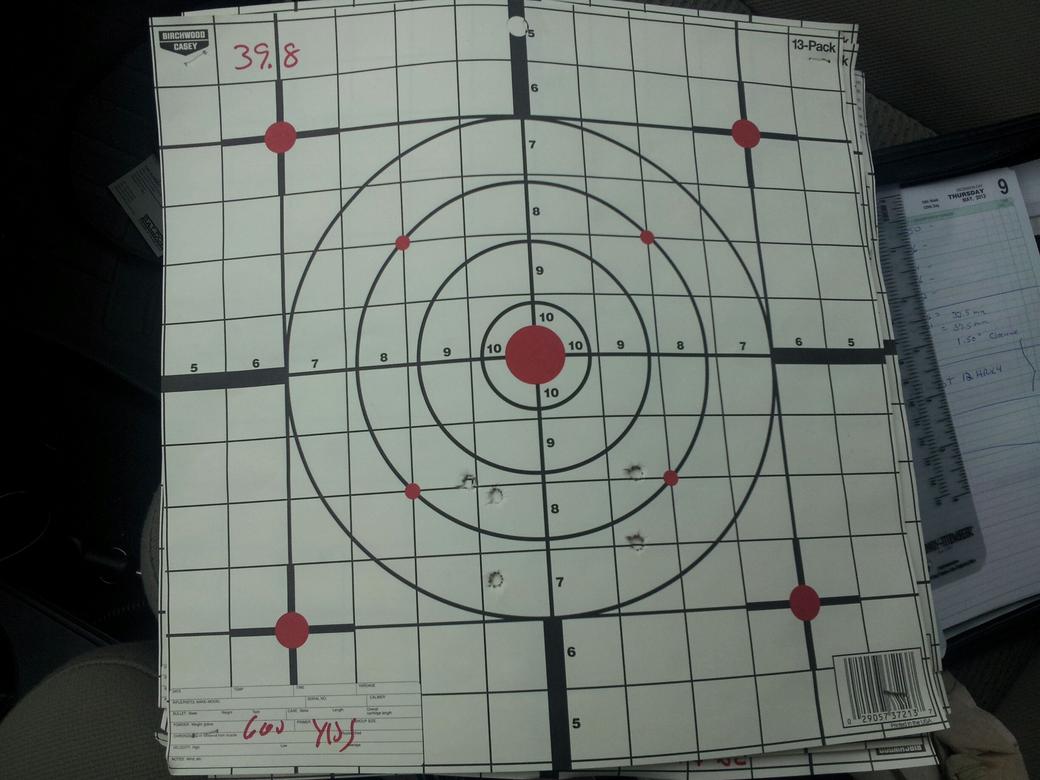

    12LRP/6.5 CM. Mine likes 140 gr Amax and 39.8 gr IMR4350. Target is at 600 yards on a not so calm day. The vertical is about 1.65" outside to outside. The horizontal is on me.
