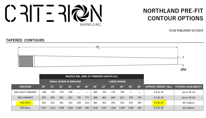

    Any of y'all running savage MTU contour barrels? How do you like it, and how much do they weigh on average? Can't find a ton of info.

    Barrel nut MTU?
    On a barrel nut Barrel a lot of weight is lost compared to the same profile shouldered especially on an MTU type profile.
    My 28” heavy Palma is 5.5 pounds or so so I I’d imagine it would be a touch more.

    Im running one on my origin dasher and this seems pretty spot on but its been a couple years. With my acc chassis and no weights I can slide the bipod to directly in front of the magwell and it can damn near balance it perfectly on the bipod legs alone so its the perfect weight for my situation.
    If I can remember in two months when I pull it Ill weight it for you lol
