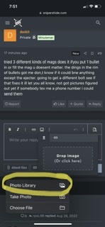

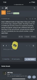

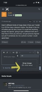

tried 3 different kinds of mags does it ifyou put 1 bullet in or fill the mag u doesent matter. the dings in the rim of bullets got me don,t know if it could bne anything except the ejecter. going to get a different bolt see if that fixes it ill let you all know. not got pictures figured out yet if somebody tex me a phone number i could send them
