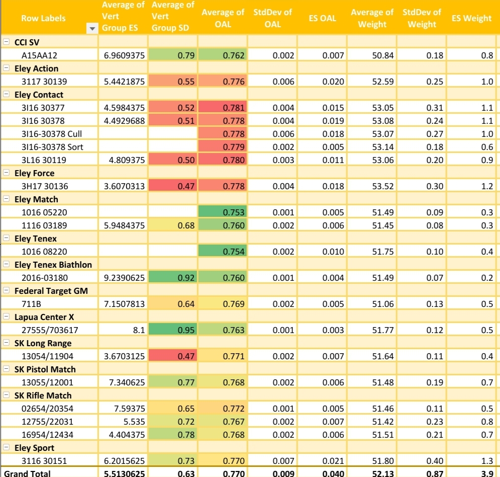

I like your spreadsheet. I do the same. Do you measure base to ogive for your ammo as well? I'm not suggesting sorting to 0.001" as i dont see that making a difference. More is there a correlation between length and what shoots best?
I dont see a difference at 50 yds but at 200 where I do most testing I seem to have a correlation with length.
Thanks for the liking of the spreadsheet. I do not measure the ogive, mainly because I do not think sorting will allow for this fireman to have it's accuracy increased. From what I shot today and saw, this rifle is having some issues with the ramp. I shot Tenex and it seemed either, I was pulling the trigger inconsistently, aerodynamic jump, the ramp is cutting the wax coating and lead weirdly, and or that the barrel needs to be worn in a little more. This seems extremely interesting still to me. As far as the the length goes, it likes the length of the SK rifle series and Lapua Center X. I am not at my shop right now, I will update this with measurements.

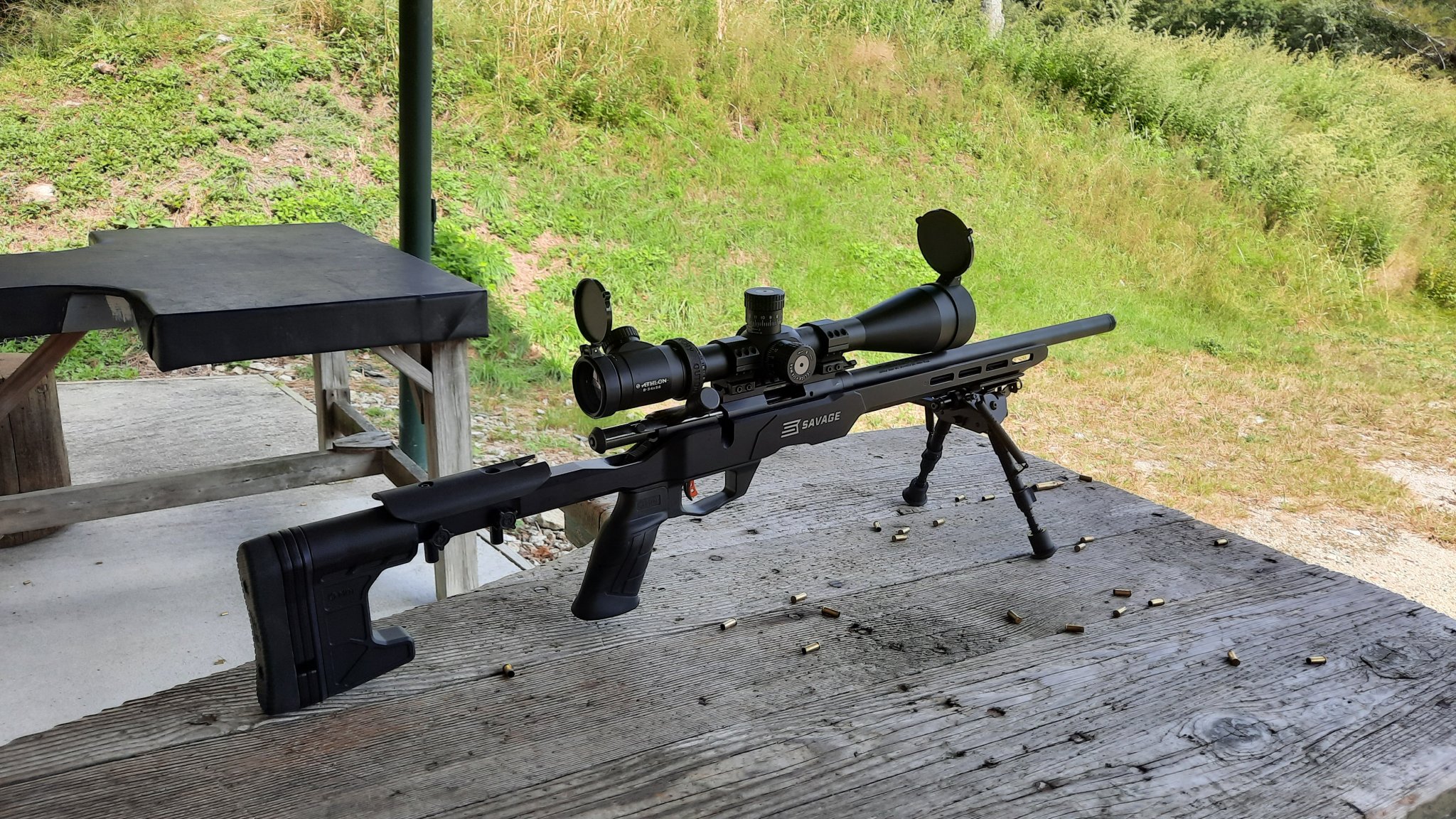

Greetings,
I’ve been a long time member and lurker. I don’t post often and most of my posts have been questions related to rifle set up, equipment, or “dibs” on the SH PX. I am an average shooter with experience mostly with AR platforms and handguns but new to the 22 LR Precision world.
My search of the SH, YouTube, and WWW did not show many reviews of the Savage B22 Precision. Below is my 5+ months experience with the rifle. The purpose of the build was to compete in the NRL 22 base category and to have a trainer for my Savage 308 in a MDT LSS XL gen2 chassis. The scope has changed many times but most of the testing was done with the Arken SH4.
I purchased all of the items myself, with zero factory discounts. I have no financial or business disclosures to make with any of the companies.
Set up:
Savage B22 Precision with factory MDT chassis ($599 MSRP)
Arken SH4 4-14x 50 ($399 MSRP)
Vortex 30mm rings, low
EGW 20 MOA base
MDT stock spacer
Harris bipod
Ammo tested:
CCI SV
Federal Gold Medal Match SV
Fiocchi SV
SK Flatnose Match
Aguilla Rifle Match SV
Lapua Biathlon
The B22 Precision Rifle is solidly built with a very comfortable and adjustable stock. The length of pull was a bit short, so I ordered spacers from MDT and the fit now mirrors my center fire rifle. The finish is matte black in what appears to be a nitrided finish that has been durable and pleasing to the eye. One issue with the adjustable plastic knobs for the cheek riser: not much force is need to lock down the riser, if you gorilla it, the knob‘s internal plastic gearing will strip off and expose the brass Allen head that is designed for more permanent cheek height setting. A small dab of Gorilla glue (pun intended) and gentle but firm tightening fixed the issues.
The bolt is smooth and does not bind when pushed forward on a slightly off axis. Bolt closure is tight with zero wiggle after closure. There is no appreciable bolt lift when cycling the action. The 2 position tange mounted safety is easy to operate and ergonomic. IMHO, the bolt is smoother and is easier to cycle faster than the CZ 457 Pro Varmint. The bolt knob is of the “tactical” variety and I think that it is permanently attached to the bolt handle. It is very ergonomic and compliments the lines and purpose of the rifle well. When re-installing the bolt, a marking on the back half of the bolt and the extractor must line up PERFECTLY. It took a few tries to get it right, and it may frustrate some newer shooter, especially young-ones starting out.
The magazines are 10 round rotary type with the release lever incorporated at the front of the magazine body. This makes unloading a breeze, but durability may be a issue after many elastic cycles of the plastic latch and drops onto concrete surfaces. Luckily, the magazines are cheap and abundant and is the same magazine in the Savage A22 and other B22 line.
I think that a 20 - 30 MOA scope base, similar to the one found on the Ruger RPRR, would be very beneficial to the intended customer for this type of rifle, but the EGW 20 MOA scope base was easy to source. True to Savage reputation, the scope base screws were loose when I removed them to install the 20 MOA base. While installing the new base, I noticed that the 2nd screw (screw 1 being the screw closest to the muzzle) was tighter and grittier and was harder to fully seat. It threaded easily for the first 1/2 and was not cross threaded. My guess is that there may be some metal shavings or uneven surfaces at the base of the hole. However, it did not bind or interfere with the bolt action.
