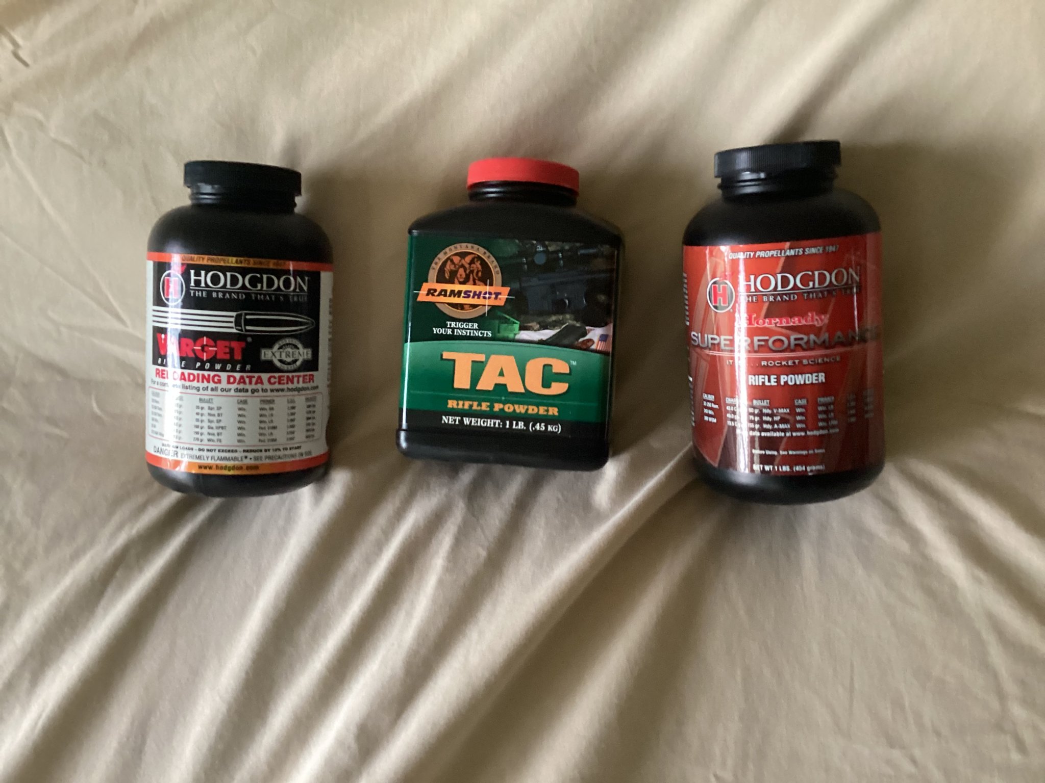

In these days, I have solved a lot of this worry (not all but a lot) with the three rounds I load the most. I use three very distinct and distinctly packaged powders. Those three calibers I load for; .223 uses TAC in the square bottle, 6GT uses VARGET with the Hodgdon colored bottle and 6.5 Creedmoor, I am pretty much married too Superformance in its very maroon bottle. Makes it easy but not foolproof, still triple check both before and during the loading process. (Oh, did I forget to mention, I use checkweights on the scale to verify the weight I set on the scale?).

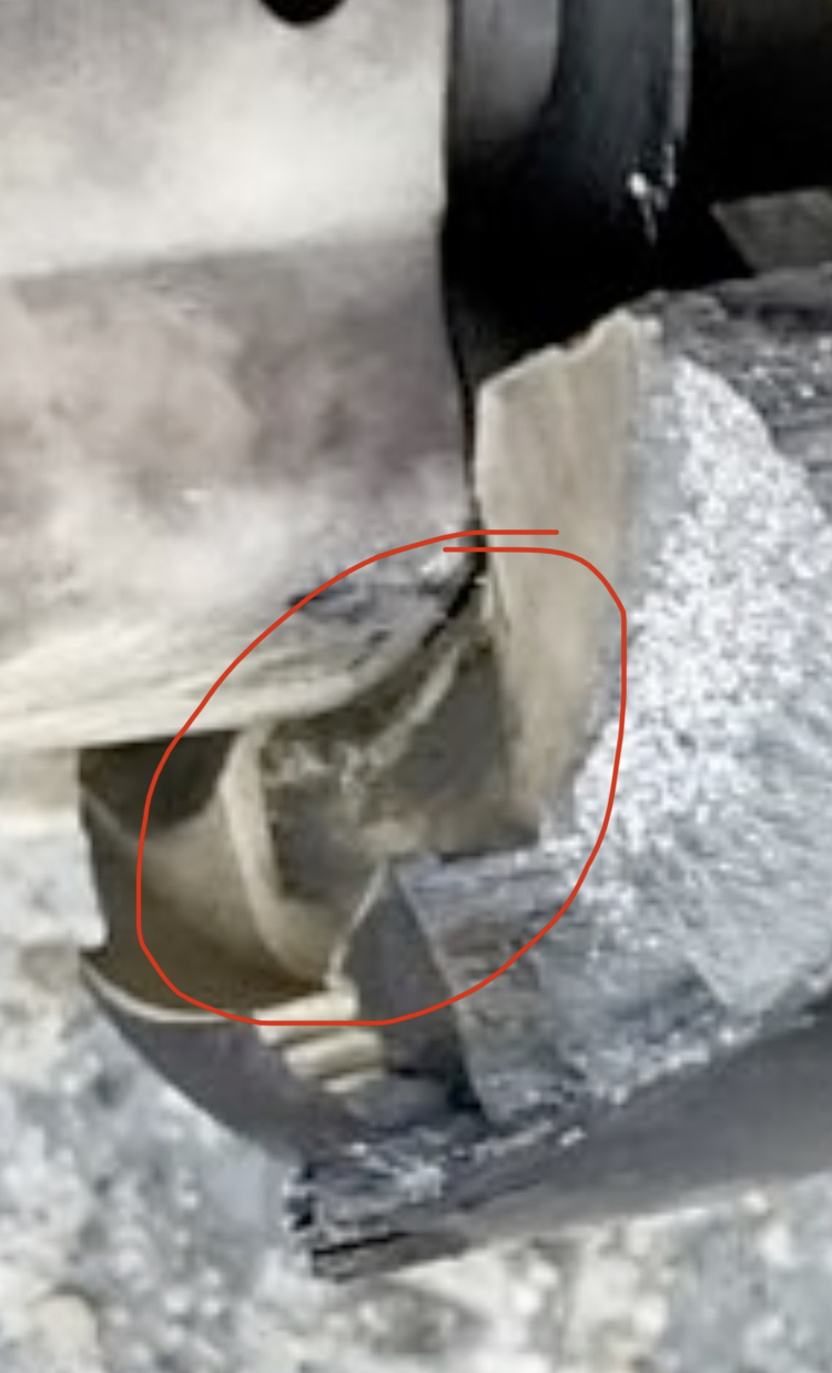

It seems that everyone wants to blame the shooter and a bad reload. If you look at the pictures there isn't any damage to the barrel apparent. If you do a little research you might find that there have been more than a few Savages fail because of firing out of battery. That would better fit the damage in the photos.
If it would have fired out of battery then there wouldnt be the distinct and deep impression of the bolt lugs on the reciever lug abutment would there ?
What XLR308 is referring to above
Normally an explosion that big in a bolt action is operator error
Either pistol powder in case or squib that blew up, but generally speaking bolt actions don't explode, wasn't the bolt in the action and locked in place? It sounds like it blew when fired
After taking a closer look at the ammo box, it appears there’s factory and reloads in the box. Definitely can’t rule out wrong powder.
Interesting that the barrel "looks" just fine. Case didn't stand and chance, gas cut through the bolt like a block of cheese and away went the action.
That was indeed surprising. When we looked at the barrel, we couldn't find any obvious bulges, and the bore was clear of any obstructions.
Impossible to determine at this point, but if it had been a squib, wouldn't we expect to see some obvious damage to the barrel?
I agree. It suggests to me that it wasn’t a squib halfway down the barrel, unless it was just deep enough to allow the next cartridge to be chambered.
