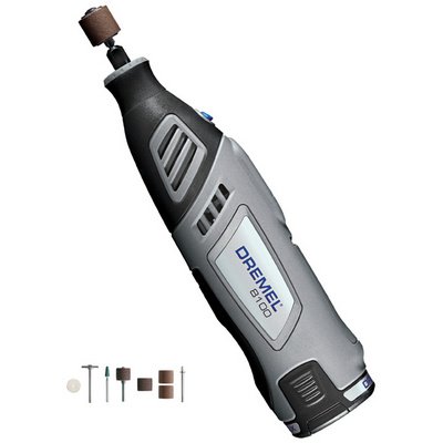

Grind off the "alignment tab" on the GB.... or buy another brand Adj. GB and save the OEM Adj. GB to sell with the Savage Barrel.
