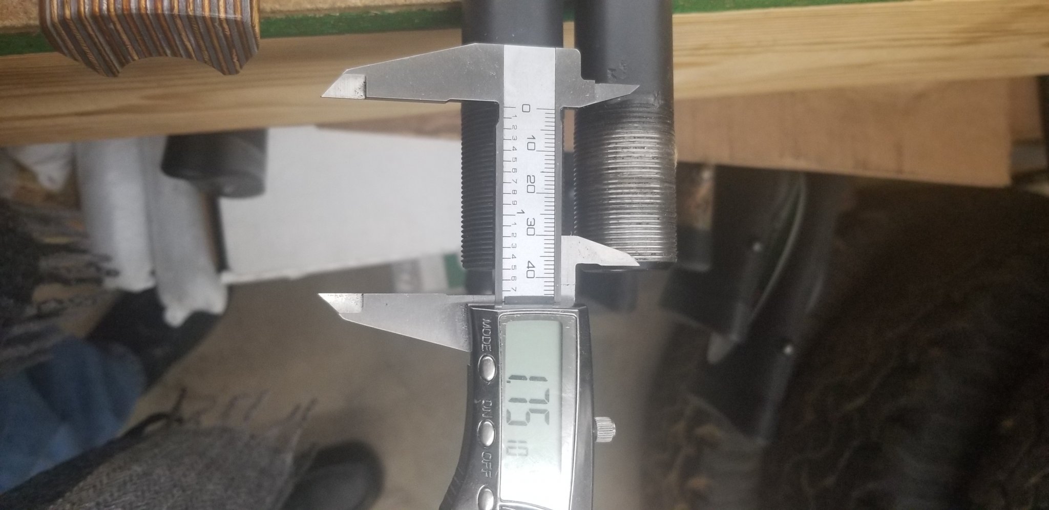

    I have two dead Shilen’s and two factory savage barrels
    That would be helpful. I'd like to know how the factory barrels measure. If you can check the diameter just past where the threads end I'd appreciate it.

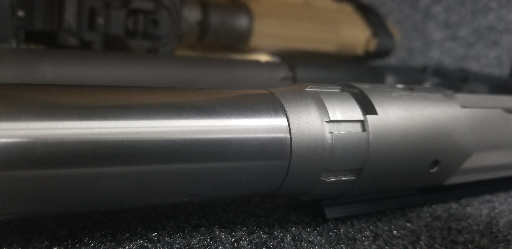

    Are you turning the barrel I turn the shank to 1.055 ×20 and step up some to fill the gap under the smooth part of the nut.
    I am turning the blank down and I plan to do it very similar to what you show. Thank you to all who helped.

    With a real thin recoil lug the 1.65 showed about a thread and a half with a stock nut and NSS nut.

    measure the length of the barrel nut subtract an eighth to determine the thread length. I d of nut determines diameter of barrel on muzzle end
    I didn't have the action, barrel nut, or a savage takeoff barrel in hand. I made the pre fit with 1.56 inches of threads and mailed it to the customer. He said it fit perfect.
