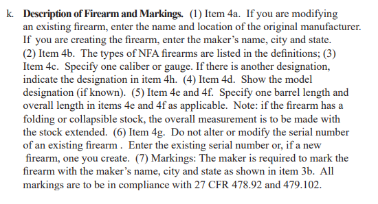

My understanding is that a SBR cannot be registered as "multi" and that seems to be supported in this section of the Form 1 guide. Complete document here: https://www.atf.gov/file/11281/download
I have always registered my form 1 lowers as 10.5" 223 and kept a 10.5" 223 upper for each lower. I have a multitude of other calibers and barrel lengths, but have the ability to return the item to its original specification. So long as the modification isn't permanent and you can return the item to it's original specification I believe you are good to go. I would not feel comfortable registering the item as a 223 and not possessing a 223 upper to return it to it's original configuration as specified on the Form One.

Correct only the lower is registered, but part of the registration is declaration of caliber and overall length. You have to be able to return the registered item to it's registered configuration. If you make permanent modification to the item then you have to notify the atf. Suppose I changed my stock from a LMT sopmod to one of the lwrc ultra short stocks, the rifle is now shorter than it was originally stated on the form one....so long as you can reinstall the sopmod and bring the rifle back to how it was originally built you are gtg. IF you had to weld the lwrc stock onto the lower and it prevented you from ever reinstalling the lmt sopmod stock you would have to notify the atf as the change is now irreversible. Uppers are the same line of thought, so long as you can return the item to how it was registered gtg, but if for some reason you had to weld an upper of a different caliber and or barrel length to the registered lower you would have to notify the atf as the modification is now permanent.
As far as lowers marked multi.... I have several marked multi, but just like @SkyScrapin all of mine have a caliber designation on the form one. I believe that if you put "multi" in the caliber designation box it would be rejected, but I've never done that.
