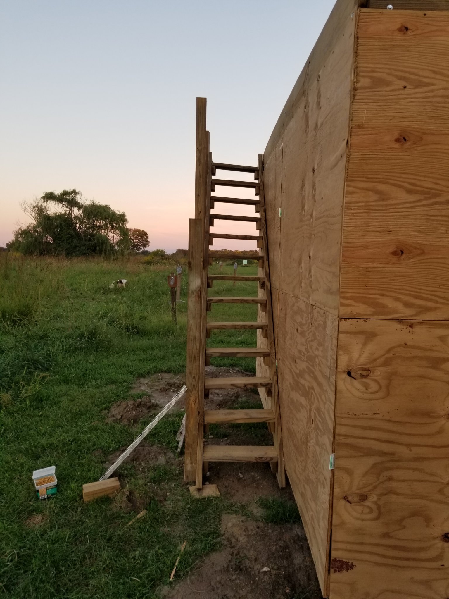

Stairs... top goes on this weekend.

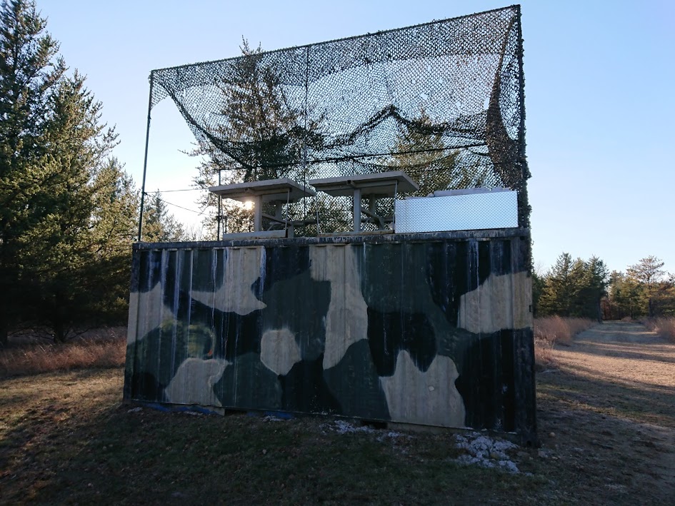

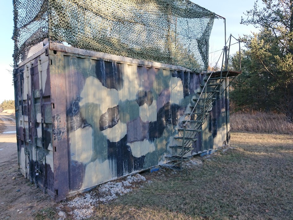

I did the container platform as somebody mentioned in one of these threads. I used 2x4 walls to temp shore the inside roof, welded a 1/4 x3 a36 flat around the entire outside perimeter, used #4 rebar @ 2ft centers. Poured concrete and finished it off with a broom for a slip proof surface. I welded poles for a canopy( covered with military netting) in the corners and fabricated some structural stairs along one side. I put (2) 680 lb shooting benches and also have 42 sandbags for the 3rd shooting position. Very stable, and has lockable storage inside. I will post some pics when I figure out how. I never thought of doing the oversized deerstand idea as someone posted, that looks a he'll of a lot simpler and much cheaper! Great project!

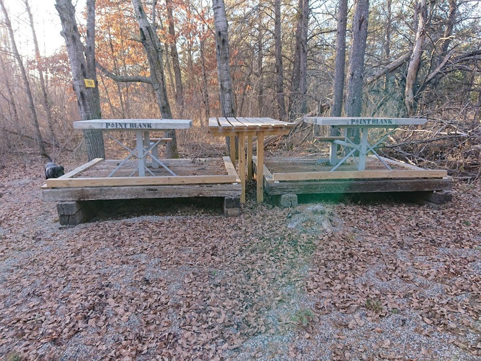

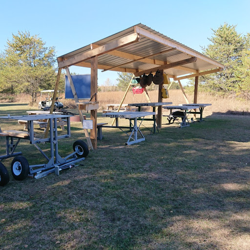

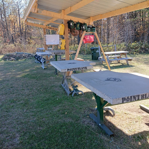

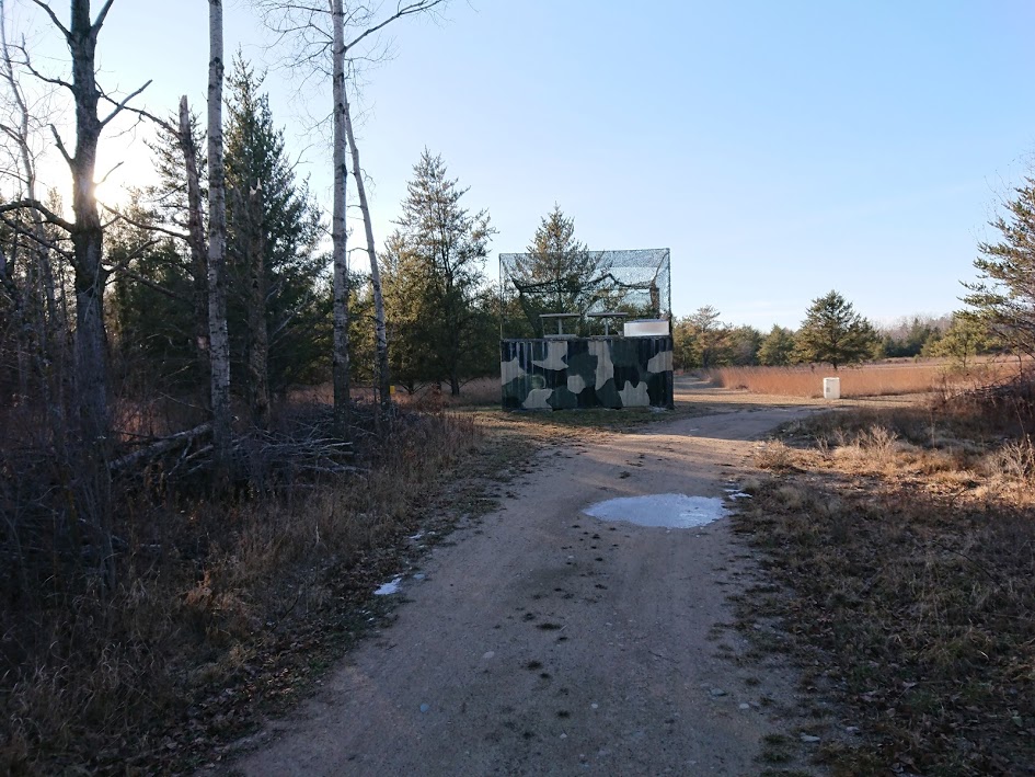

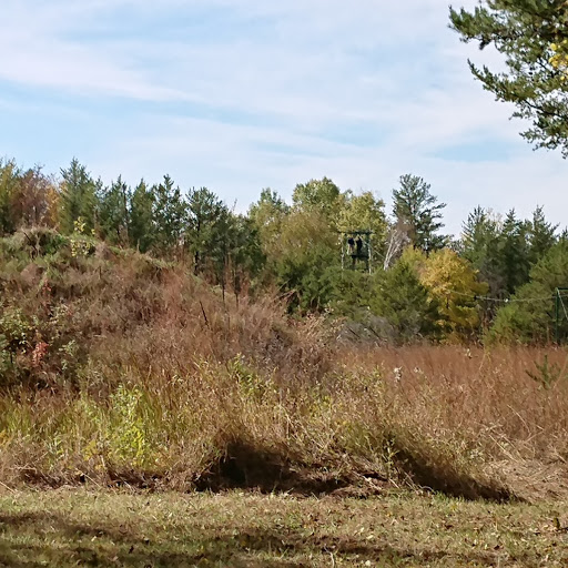

Bear with me, I ended up with more of my range pics than intended.
DSC_0025.JPG 43 ft tower, hidden among the trees.
DSC_0027.JPG 43 ft tower
DSC_0242.JPG 100 yard benches
DSC_0245.JPG 100 yard benches

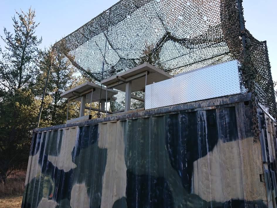

DSC_0216.JPG 517 yards to target, the 20 ft container. The 3 inches of concrete is solid, very little transfer or vibration. Forgot to include an pics from on top....
hDSC_0218.JPG 2 benches and sandbags. Alum diamond plate keeps sandbags from falling over the side. Love my home made camo job??
DSC_0219.JPG Cargo net shades our camera monitor. From ground to bench tops is approx 12 ft.
DSC_0220.JPG Stairs up the backside, with rope railing. Stairs could have been wider, it was what I had left over on a project. (30 inch tread width)

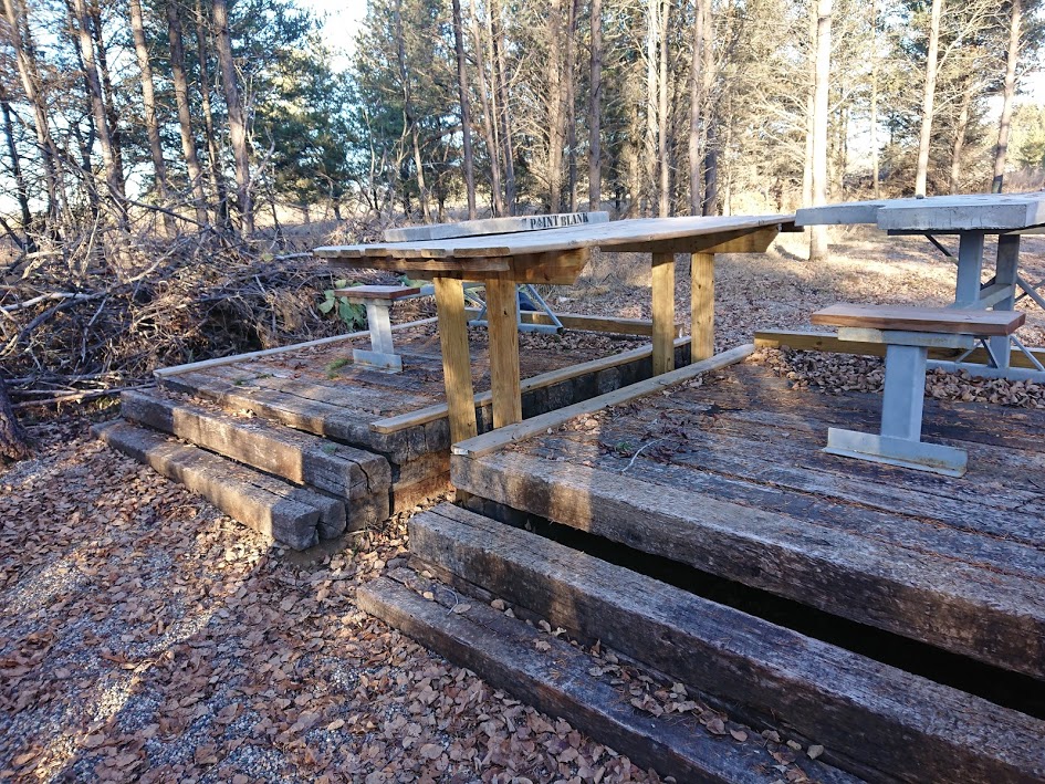

DSC_0224.JPG (2) platforms I made at 750 yards, the benches are rr ties and are separate so one shooter cannot vibrate the other.
DSC_0227.JPG Steps on back of rr tie platforms.

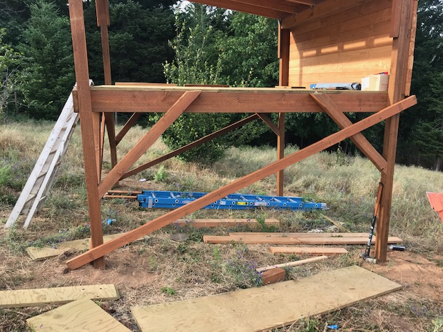

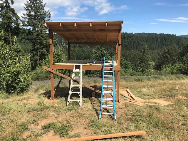

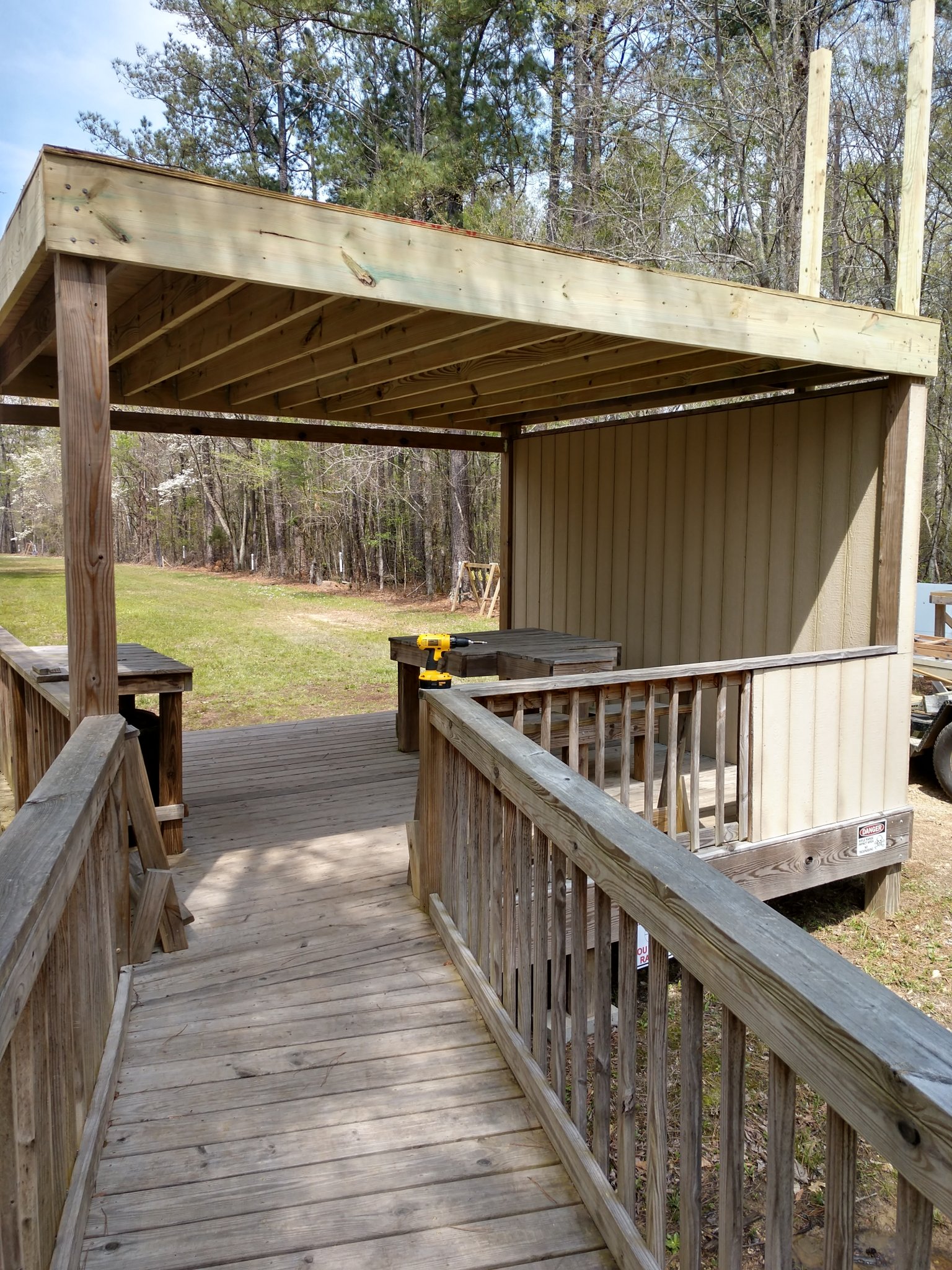

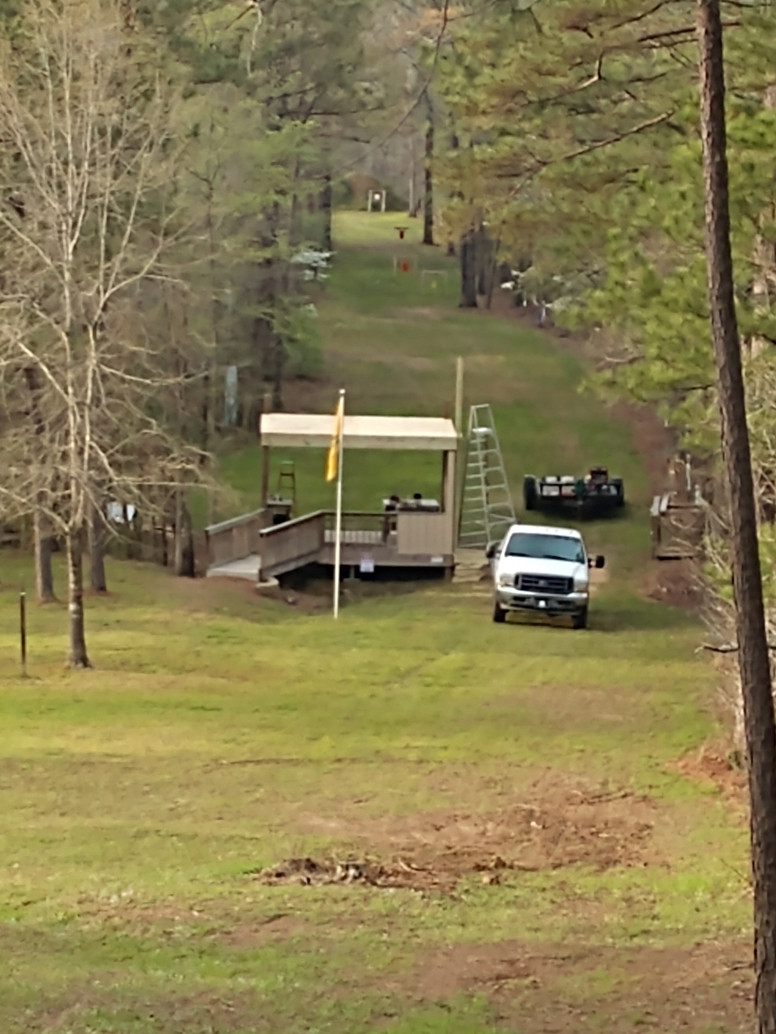

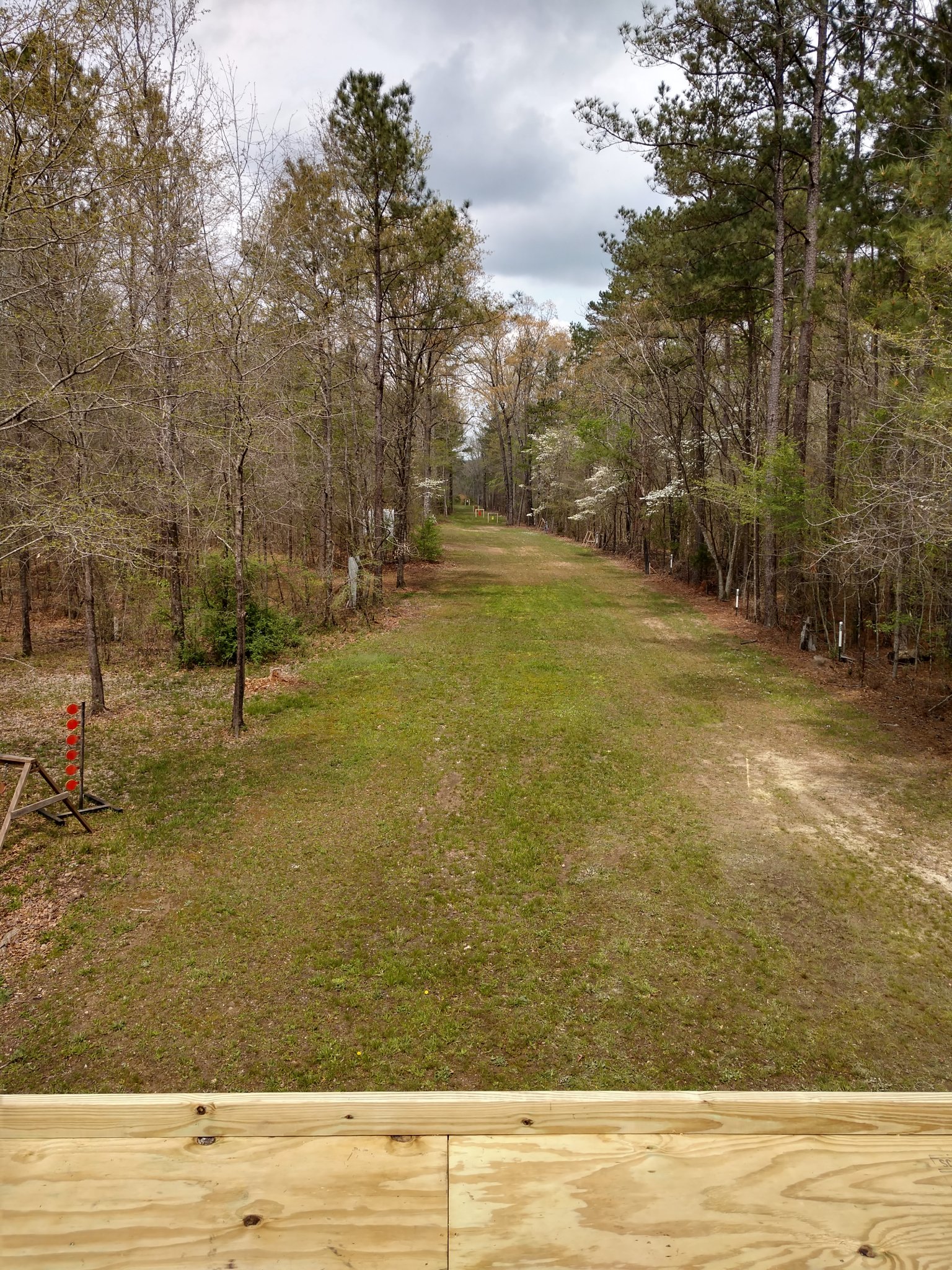

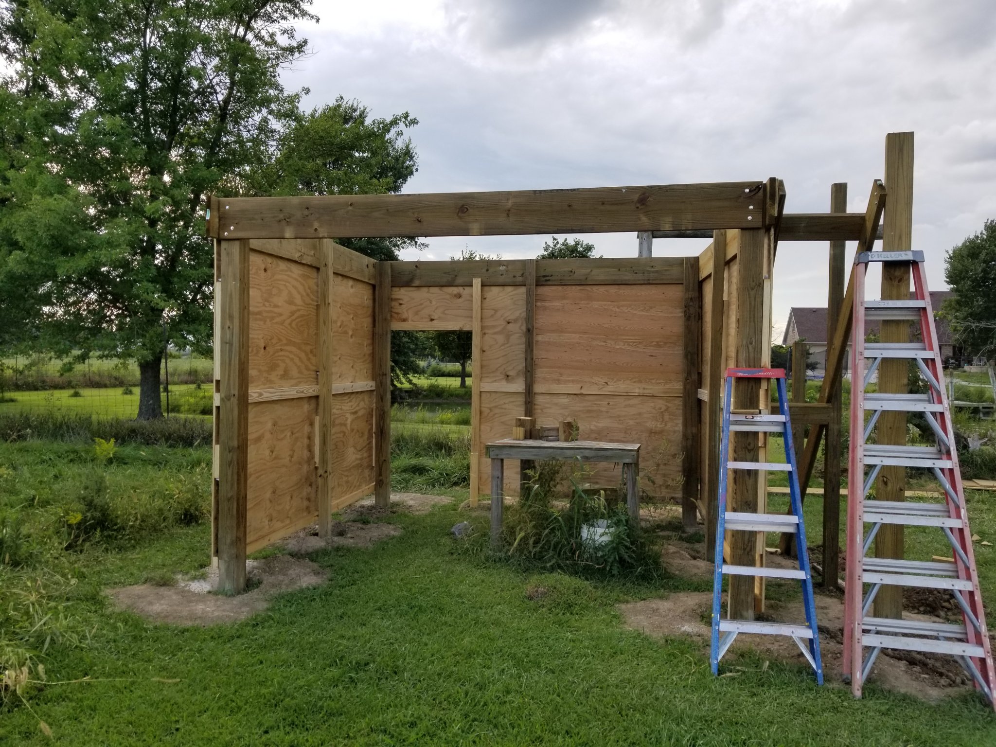

I have one I put up last year to raise my shooting position due to drop off to get more distance. Its simple and I will post some pics later.
OK OK Sorry:) I wanted to get you newer photos but I forgot.
Here are some during the construction to give you something to go until I get newer ones. Its still a work in process.
Helping to dig the holes
Front View (still has temp bracing up) Replaced with 45 degree 4 x 4's front, back and sides. Metal roof added later.
Some of the side bracing up and back wall

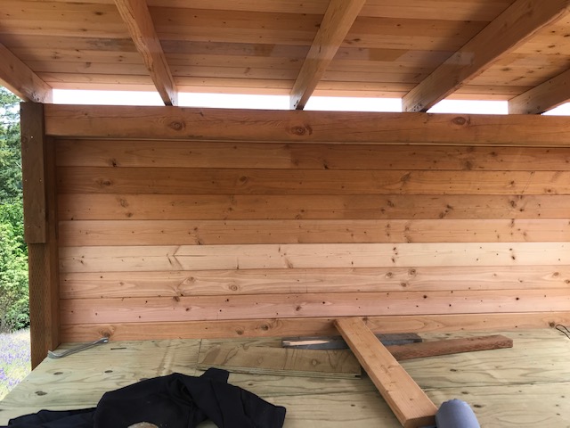

Back wall and hurricane straps are not installed yet. Half side wall was also installed to help keep the brass in which made it even stiffer. I am going to add a second side wall too.
Front header with straps in (I built it low to keep the weather out, can't stand up) Shooting table on the left.
View looking back at it
View looking back zoomed (iphone - sorry)
looking up range during our yearly pumpkin shoot - ready to shoot the exploding pumpkin
If you look close you can see the telephone poles for the main shooting shack yet to be built. I have a depressed area from 440 to about 550 that I want to put target down into that you will only see from the higher platform which will have two levels with a wood burner.
The berm at 200 has the plate rack and pistol steel which is color coded for pistol only. Did a lot more work to the berm and range since these photos.
My eleven year old shooting the AR he stole from me!
Happy day he clean all 21 steel targets from the plate rack at 200 all the way to 8 targets at 600 yards
My terrain slopes off so to get more distance and more shooting locations in why I place the shack where it is now. There are two dirt platforms to shoot from also.
Hope this helps, I'll get some more photos later when the weather permits.

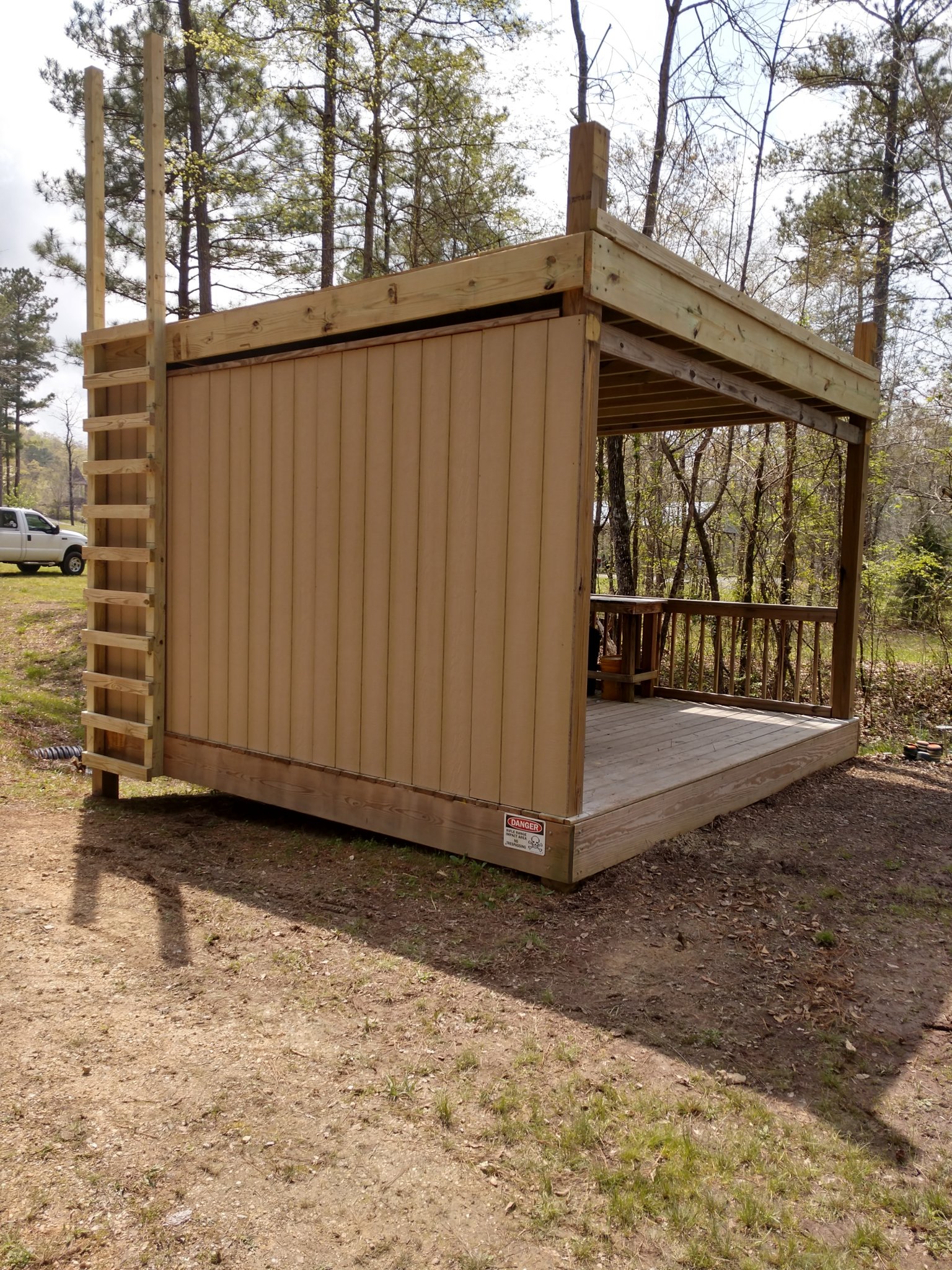

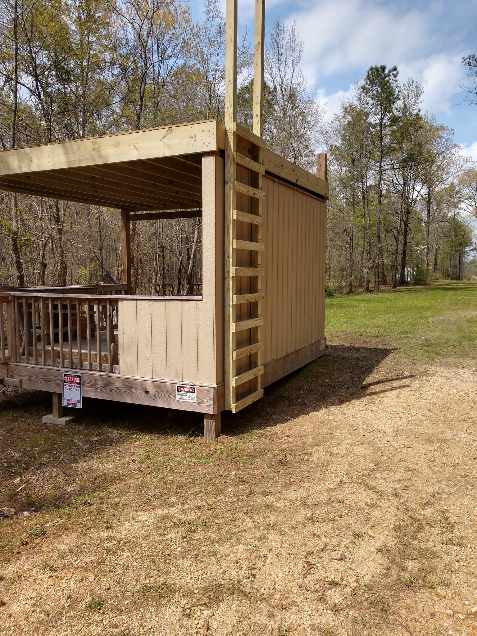

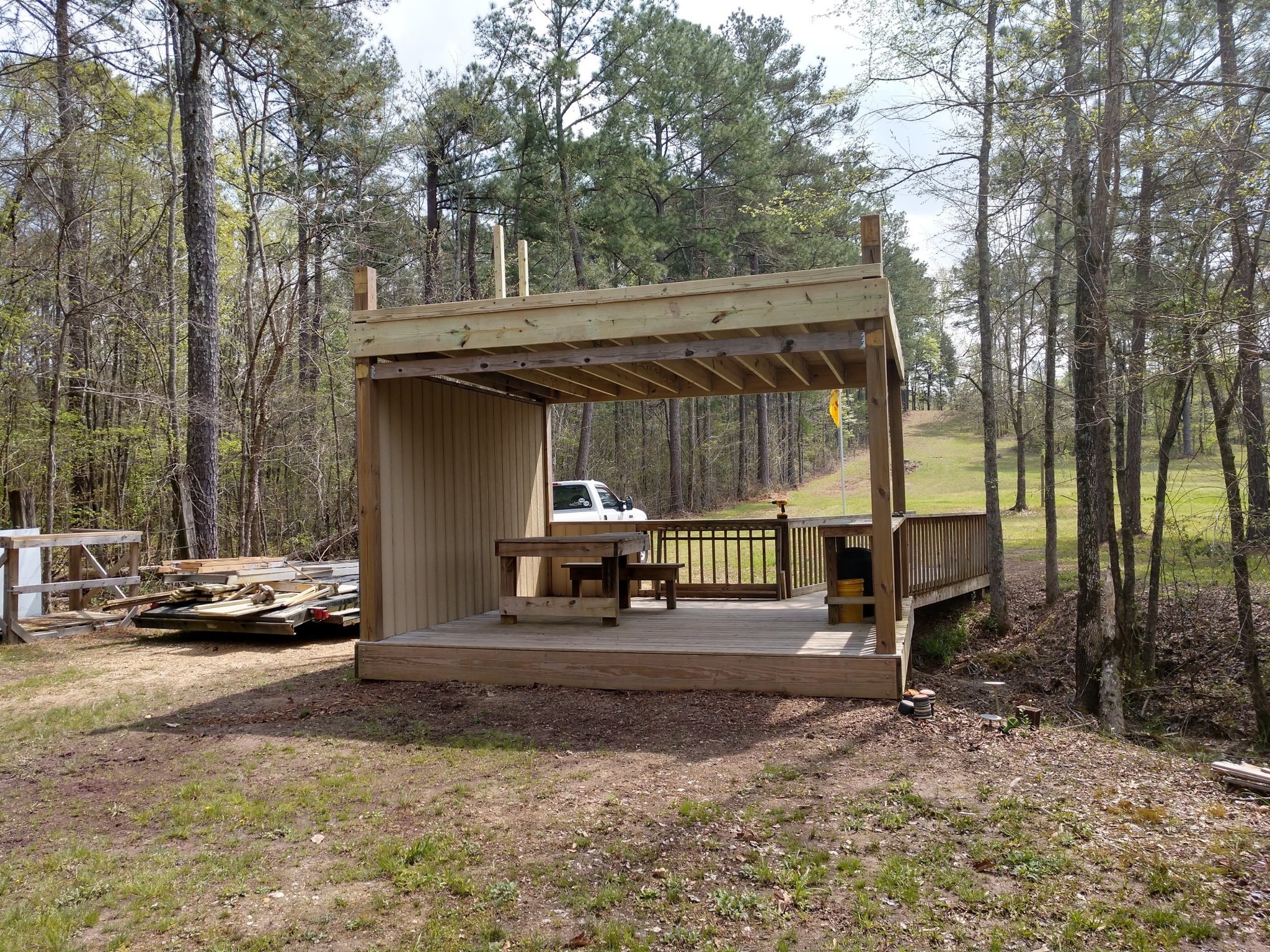

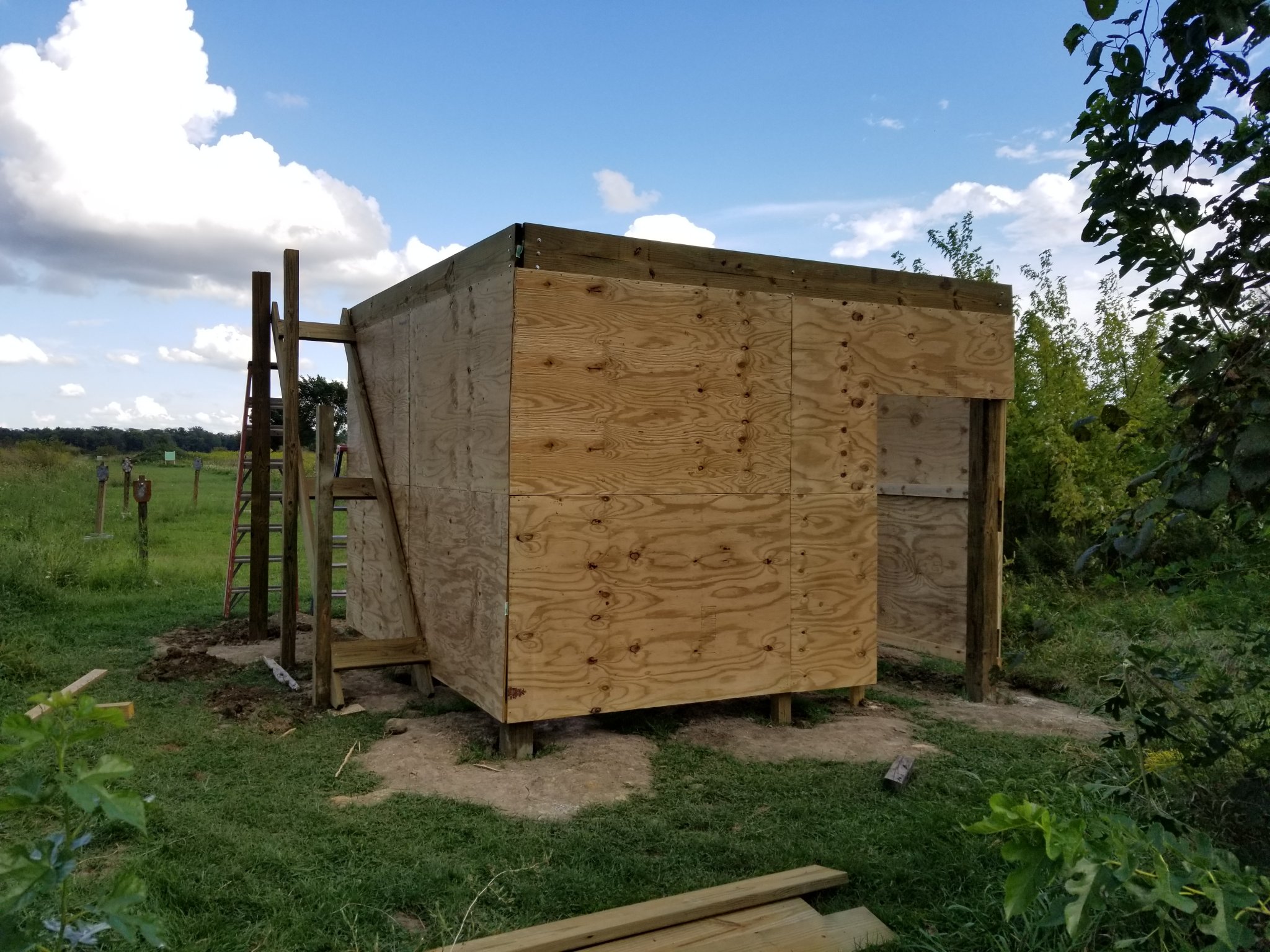

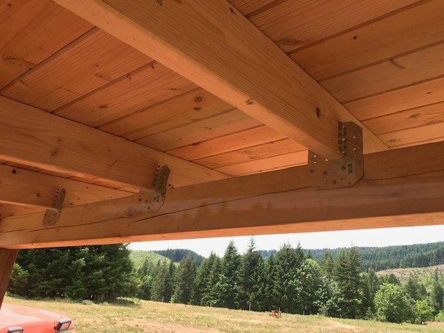

Been working on mine. It's done except for the safety rails and some cross bracing.

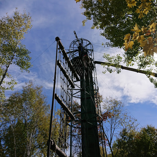

In our advanced precision rifle course, students shoot from our rappel tower @ 36ft deck height, one target is near the tower base so you have more than a 45 degree downward shot, and it confuses shooters in part cause most are a lil nervous at heights, most shooters stand , hanging the muzzle over the edge with the bipod legs keeping the rifle from falling. The second target is at an unknown distance, partly obscured so range finders are useless, its a human torso and has a diagonal band about 4inches wide as a hit/score zone(target is about 239 yards away) so somewhat challenging. I like the scaffold idea, portable and easy to change up.
I'm not really afraid of heights, but I have to admit that when I finally got to the top level, I realized how high up it seemed when looking down from the little platform from which I shot. Not only does a shooter have to know the distances to the target, but when targets go from 75 to 550 yards there is a significant amount of elevation and wind drift to calculate. The elevated heart beat from carrying gear up the ladders, and then the added "zowie, it didn't look this high from the ground" effected my concentration.
It was a good course of fire. I think anything that makes people shoot under stress is good. I think the saying "Sweat more in peace time, bleed less in war" applies.
