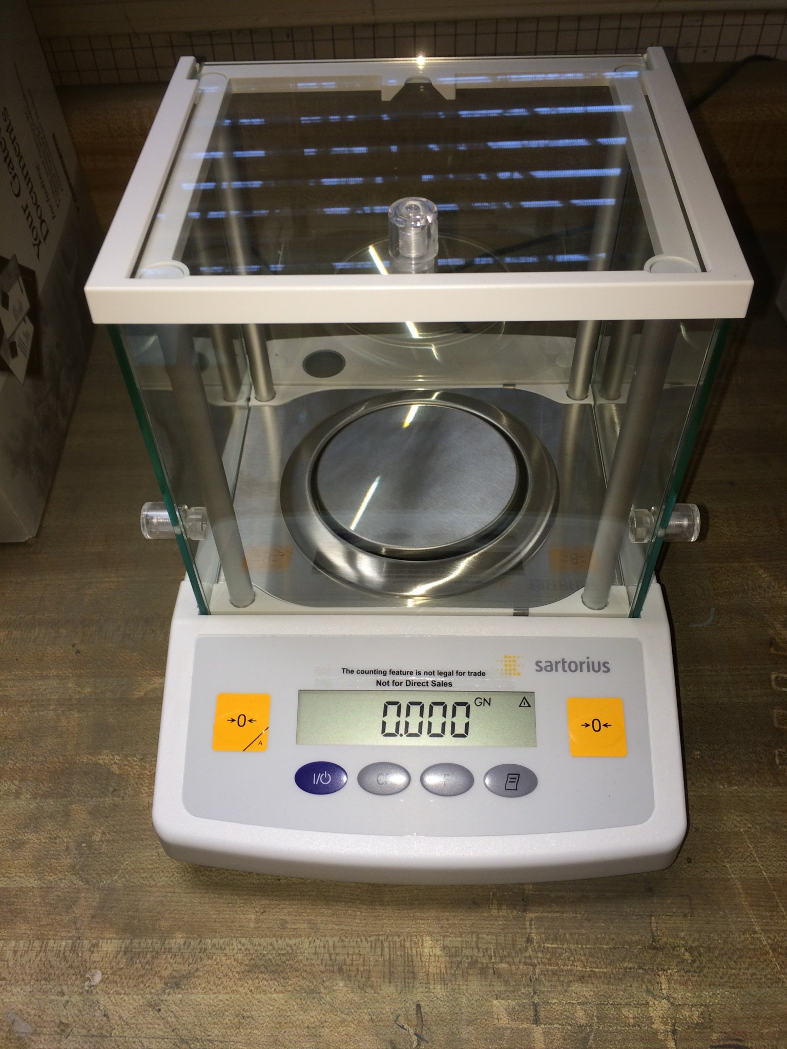

    In a recent Cortina video with Doug Skogman, Doug says that the sartorius scales are rocksolid and do not drift like the FX – 120. As a result, he claims it speeds up the reloading process because of less need for zeroing a drifting scale repeatedly. Does anyone have experience with both scales that can comment on this?
    We have quite a few sartorius balances in our lab at work which I use often, and I use an fx120i at home for loading.
    If the environmental conditions are stable, I don't find that the fx120i has excessive zero or calibration drift even when sitting idle for several days; I find it very comparable to our sartorius balances in the lab. I've left it powered up for a week before and it's still at 0.000 and setting the calibration weight on shows 100.000 grams.
    Also keep in mind the fx120i has 4 settings for zero tracking. If you find the balance getting stuck at +/- 0.02 grains or 0.001-0.002 grams frequently and you have to rezero often, try increasing the zero tracking setting. Stronger zero tracking is fine for the charge weights we're measuring, but if you were trying to weigh something near the minimum resolution of the balance (0.001-0.002 grams) the balance may think it's drift and it will try to rezero itself with a stronger zero tracking setting preventing you from weighing such a light sample.
    Excellent info thanks.
    Sounds like you don’t think the Sart is worth the extra salt
    I can't say for sure as I've never used a sartorius for reloading, but my hunch is the extra resolution the higher end sartorius balances are capable of is "in the noise" unless your brass and bullets are all perfectly uniformed and all other variables tightly controlled. (Not to mention are you inspecting each kernel of powder for uniformity as surface area can have an influence on burn rate... The rabbit hole keeps getting deeper the more you look.)

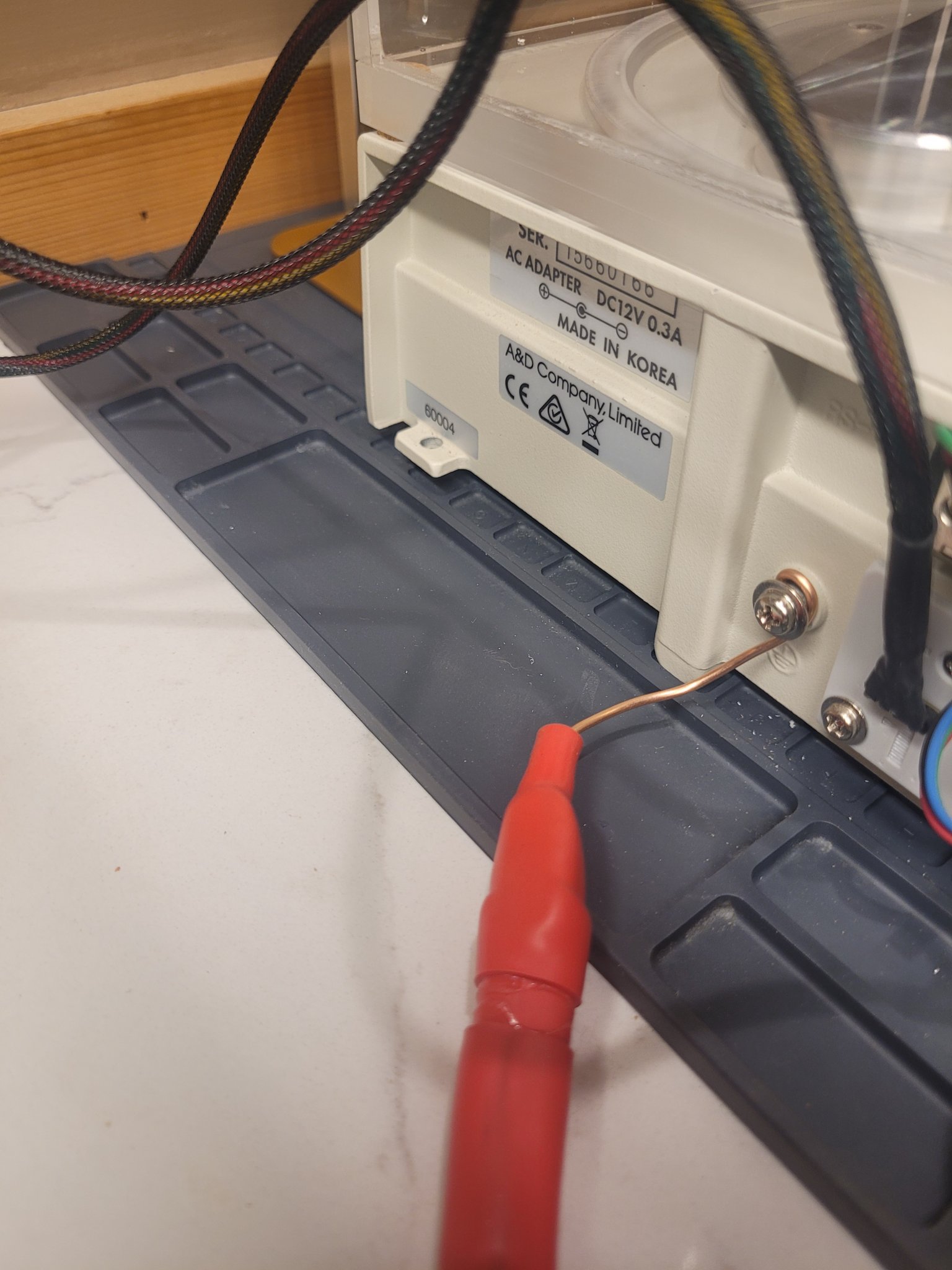

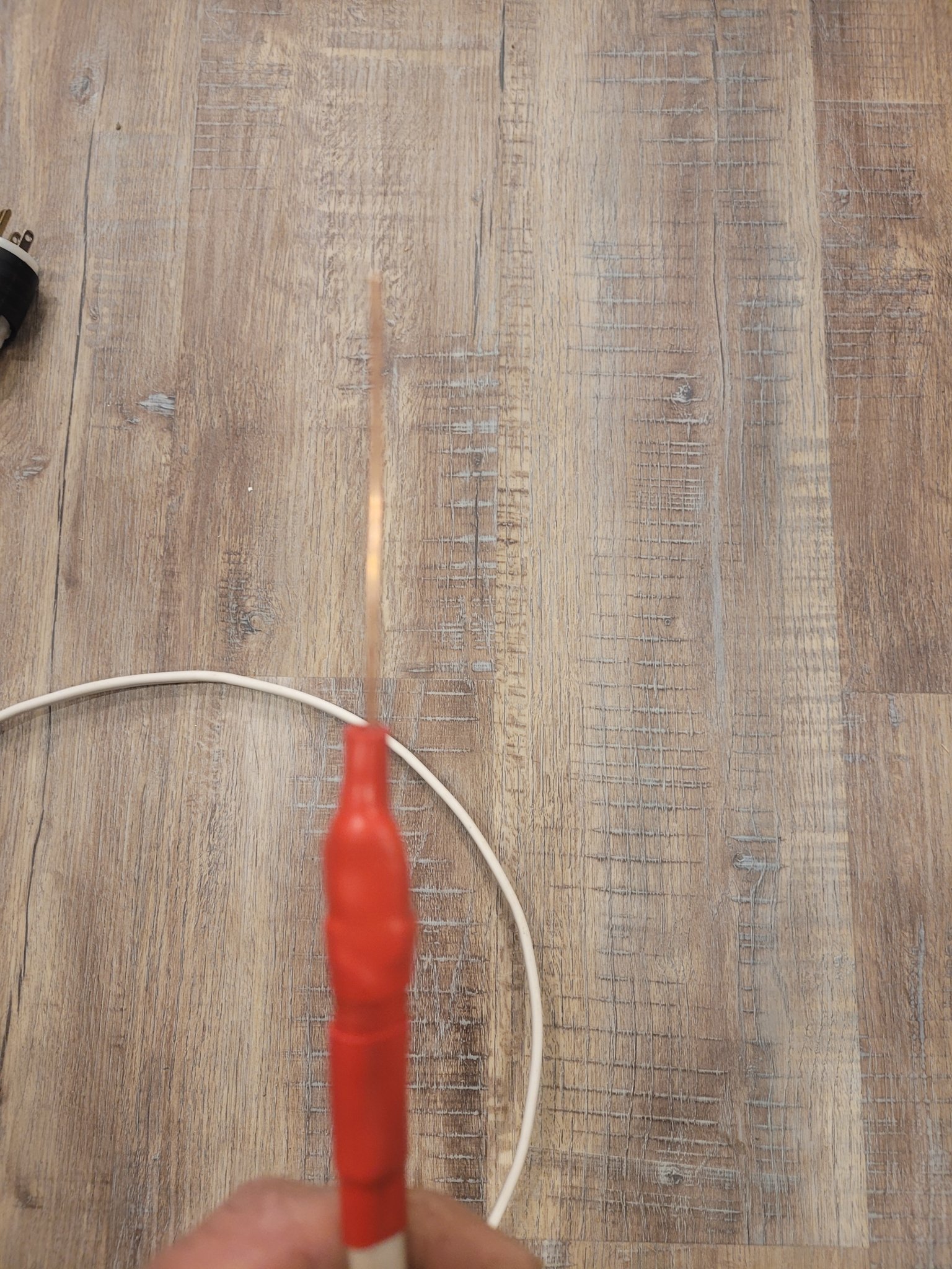

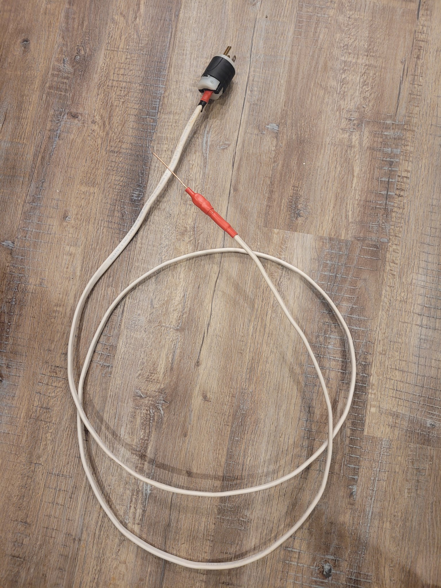

    Just wanted to add to this a really easy way to help yourself. These scales have a grounding lug on them for a reason. Here's a way to make a super simple grounding wire that will work well. Just don't hook up the other wires obviously, and make sure you have then ends where you cut them separated and each taped up, then I'd do the heat shrink like I did with the goo inside that makes it bullet proof. You have a really easy and good ground and will help with static a lot.
    Reactions: secondofangle2
    Yes read that on A&D faqs page. Says to connect ground wire to work bench, but I suppose that will work too. Keep us updated on how it works out.
    I have mine set up on an anti static Matt, which is grounded, and then the scale is grounded itself as shown in my pics above. This is the best way to do it I believe and what the AD guy I talked to on the phone a few years back, told me to do. I had a battle with static and there's a thread here on that.
    Grounding to a work bench would only work if the bench was metal so, not sure what the context of that is but I know grounding to the common ground in a plug at your house will ground it well.
