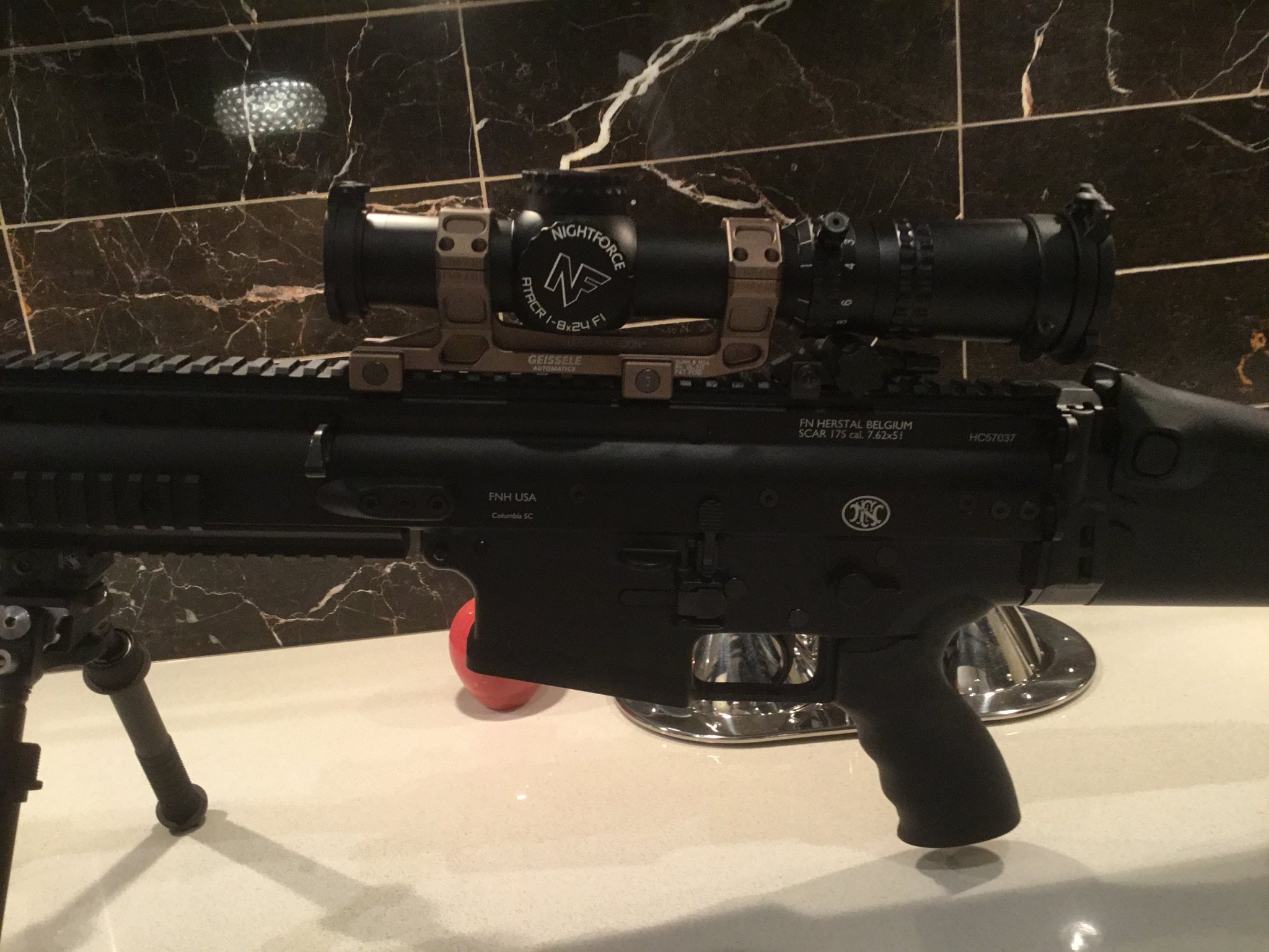

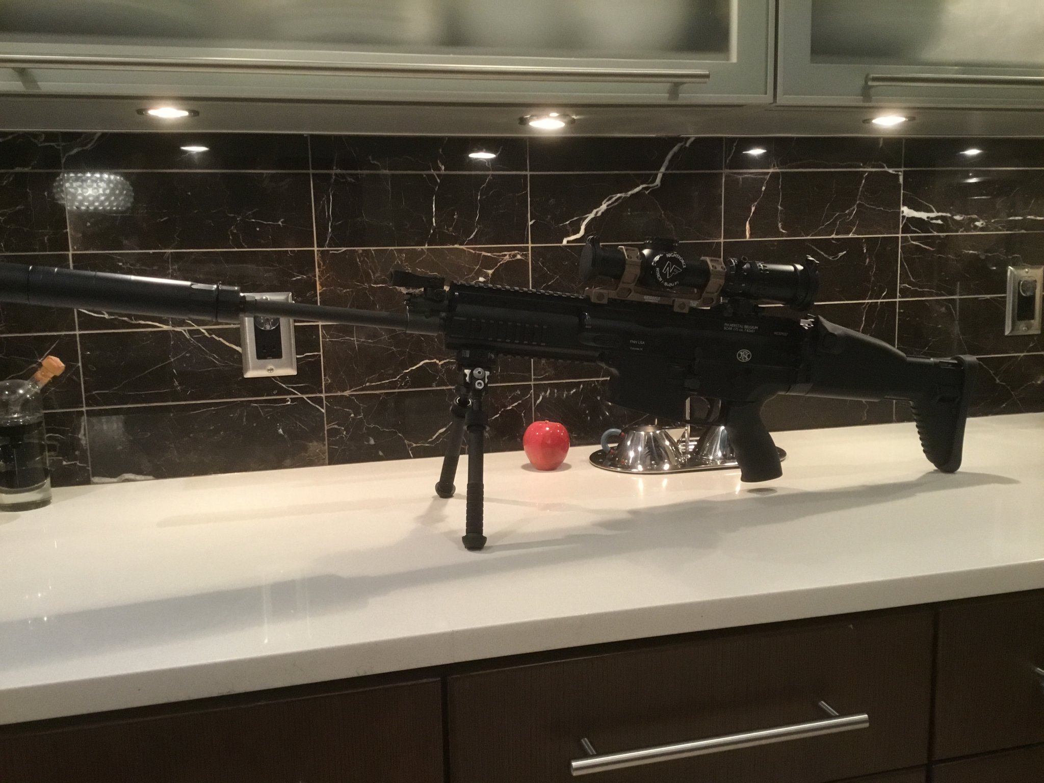

Didn't have problems with my Trijicon in a LaRue - 1000 rounds or so - buy as a prior post mentioned this is likely a drop in the bucket for the pros. I'm going with this set up for now...
My personal experience. Already got crapped on in another thread by a SCAR fanboy for noting my experience with both my expensive and very good NF and CQBSS. Thankfully both companies are great for customer care.
I wouldn't be surprised if there are some here who still believe the earth is flat because they have never seen it's curvature.
What Nightforce and what broke on it?
My ATACR F1 4-16x MIL-C
I have had three ATACR's F1, Two of them 4-16s, both phenomenal optics, the one I put on my SCAR went haywire. My other 4-16 MIL-R has been on my Larue with no problems what so ever. I believe these to be premium optics and it's not the optics fault. Love the rifle, a big fan, just need to figure out what optic to put on next, might be an Elcan or Vortex 1-6?
