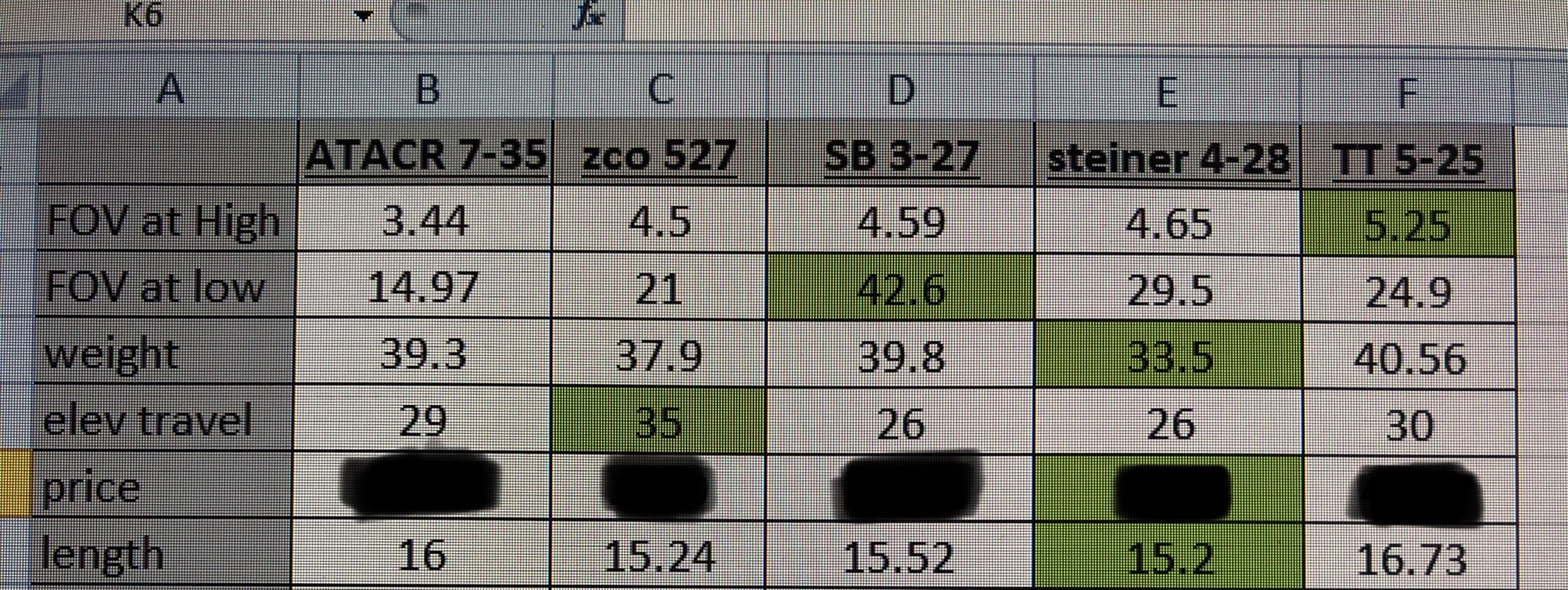

@Gil P. - here’s a half ass chart I made of some high level specs with the sb and Steiner and a few others recently. Maybe that helps.

Wow the Schmidt has a big FOV on the low end. How would you rate the eyebox on the 3-27? I've owned an M5XI and ZP5, in case you have compared it to either of those.
