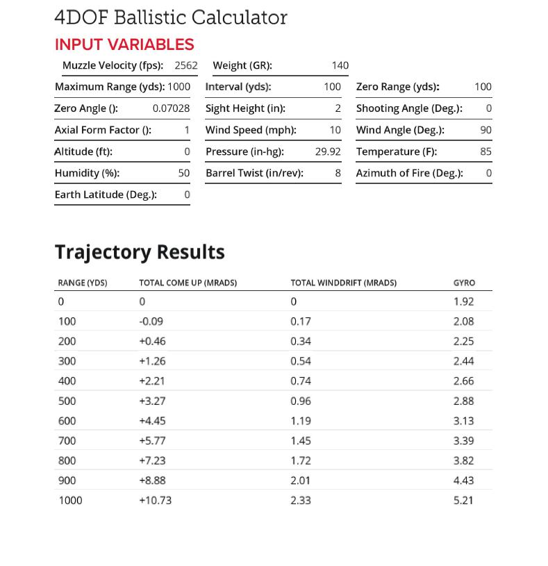

I have a Savage Model 11 that I am currently using the factory bases on. My problem is with my zero I only have 4.8 MRADs of elevation and I need at least 10.7 for 1000 yds. The only scope bases I can find are 20 MOA which would give me approximately 5.8 MRADs of additional elevation, bringing me up to 10.6 MRADs. I can then shim 6 thousands with a soda can to gain an additional 6 MOA, about 1.7 MRADs for a total of 12.3 MRADs of elevation.
Are all my assumptions here right? Will this in fact get me to where I want? I was also planning on bedding the rail to the action, but am not quite sure how to go about it if I shim, any ideas? Do I put the shim in the bedding compound?
Thanks

Im showing a 6.5 creed 140 eld out of a RPR at 2750 fps is 8.1 mils to 1k yards. At 2562 fps it would be 9.6.
So thats showing youre about a mil off of where I would expect. Unless you have a short ass barrel?
Personally, I wouldnt shim it. I would figure out why youre slow and dragging too much.
