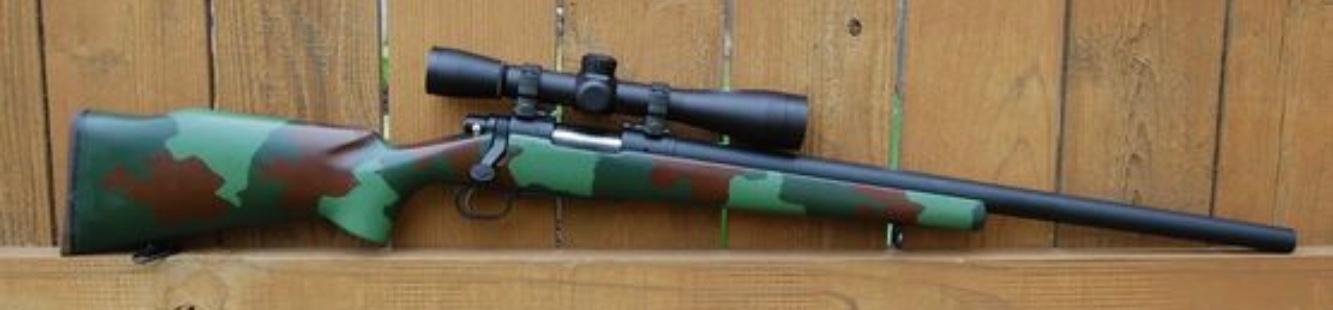

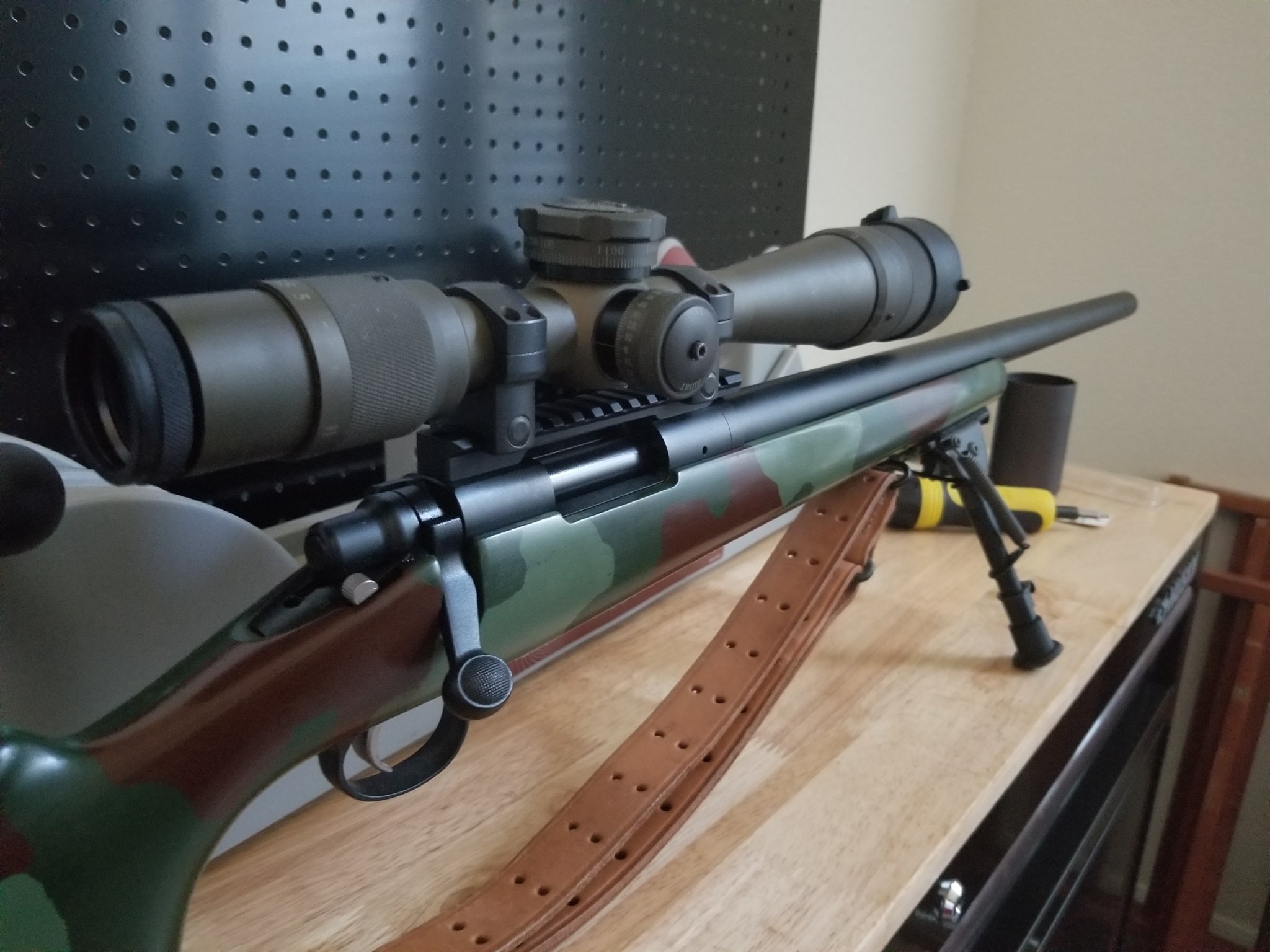

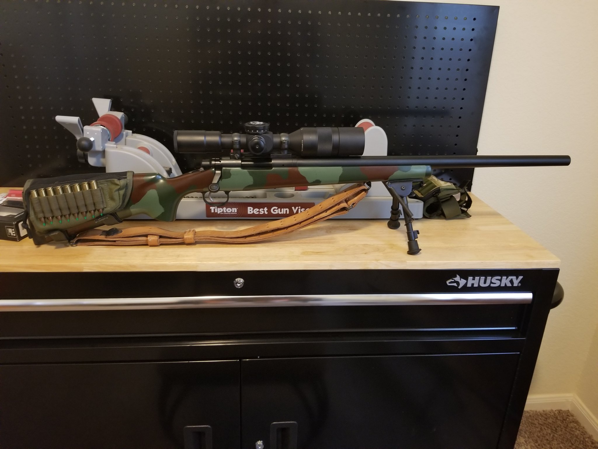

Thanks for the pic. I have the 1” tube Bushnell 3200 right now that it’s going to wear. I’m a bit concerned about durability.
I have also considered the Vortex Razor HD LH 3-15X42 1” Razor.
I’ve looked hard at that SWFA scope. The rifle is not historically accurate. I’m just wanting the right look but with modern glass and I really appreciate all the help.

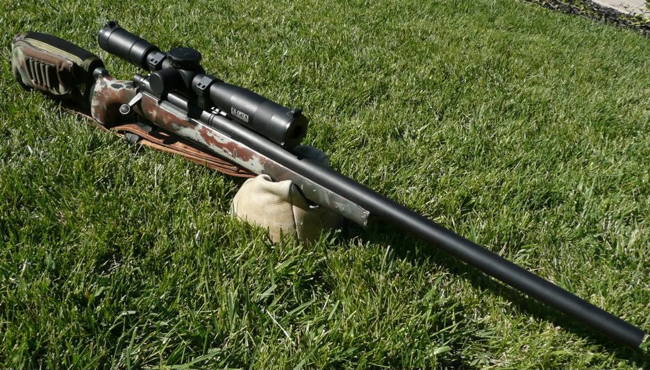

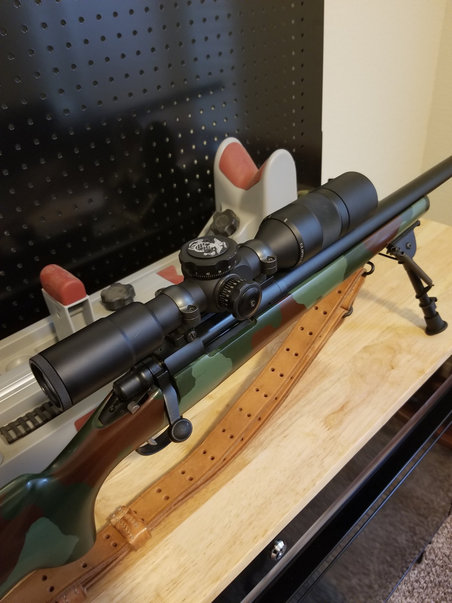

FWIW, one of my shooting buddies has a budget M40A1 replica with the Bushnell 3200 10X scope
(See here on the right with some green camo paint on it). For a budget build it will work, but unfortunately

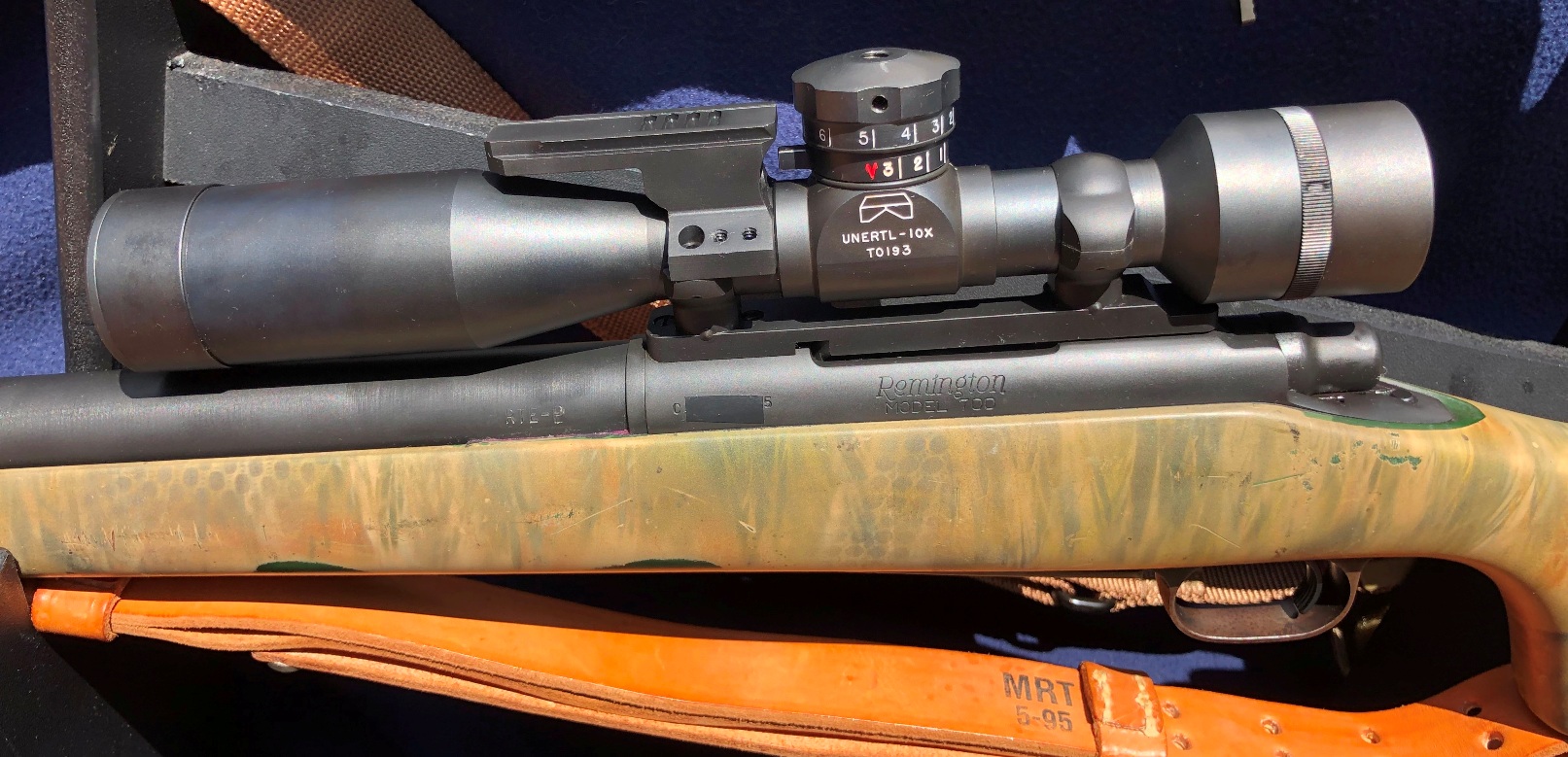

there really is no scope made that looks much like the old USMC Unertl 10X scopes - as seen to the left.
(This pic was taken the Sept 2018 vintage rifle match held by the Quantico Shooting Club. Good times).

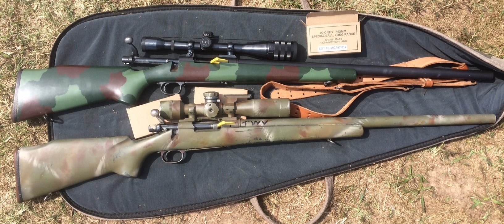

Since you want modern glass, here are a couple more alternatives. The Leupold M3A Ultra10x or
later Mk 4, 10X with M3 turrets looks "kind-of right" on an M40A1 clone given the scope is basic
and was of coarse used on M24s during the same era as the M40A1. (1990s, etc). The downside is
that they cost about $800 to $1k depending on condition and accessories. This is not my
rifle, but I think the scope looks good and doesn't look out of place on this replica:
2nd: Below is the old B&L 10X Tactical (Elite 4000 scope) - that was used on all kinds of US Navy sniper rifles
from the 1980s into the 2000s, but its kind-of hard to find and they sell for $800 and up on eBay. However,
that SWFA HD 10X is basically identical except for the logo, and I think looks good on an M40A1 replica.
I prefer the Leupold aesthetically, but I think the SWFA HD version in 10x is good choice for new/modern glass for around $700 on sale
Lastly, here's the US Optic ST-10, which you noted is above your budget, and honestly, to my eyes it doesn't look
a lot like the Unertl 10X scope due to its long rear ocular (the Unertl's ocular is short and stubby, which makes it unqiue).
The ST-10 does look like a heavy-duty military-type scope, but the old Unertl is simply very different looking...
As others have noted, your Bushnell will work just fine. If it were me and historical accuracy
was the goal, I'd go old-school with a Weaver T-10 like this replica, as this scope
and base was used by a Marine Recon unit in the late 1970s before the Unertls were
available, but then again, that would technically require an early 'smear' stock - ouch....
Good luck whatever you decide.
FWIW, one of my shooting buddies has a budget M40A1 replica with the little Bushnell 3200 10X scope
As others have noted, your Bushnell will work. If it were me and historical accuracy

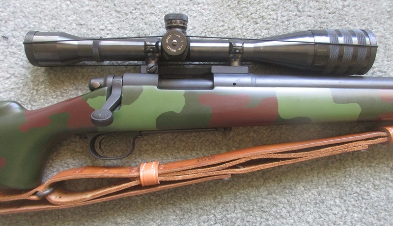

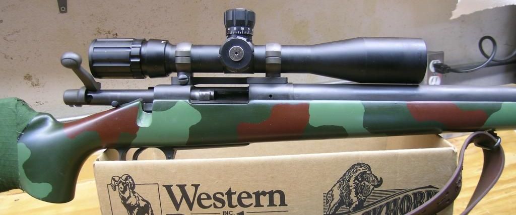

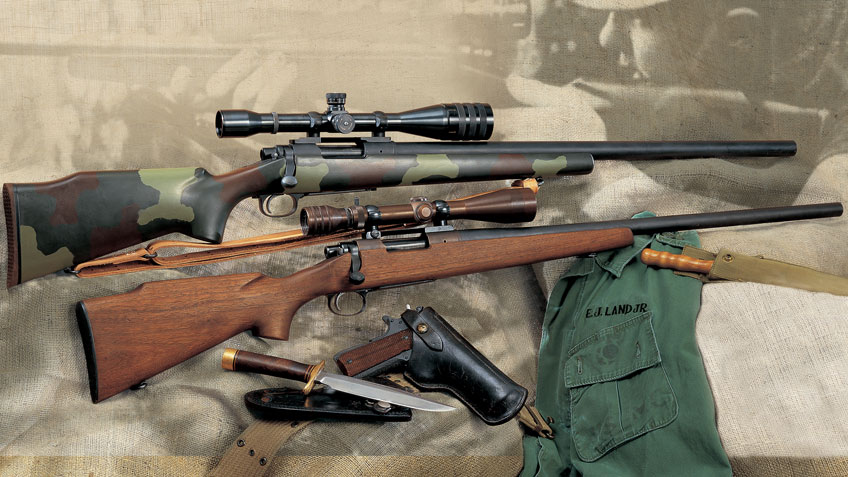

If you wanted the vintage "real" look, the closest you'll come to is the Weaver T-10. Like others have said, they were originally on the M40A1 rifles and in fact there is a picture of Carlos Hathcock sitting with an M40A1 sporting a T-10 on his lap.
Here is a picture of a really nice M40A1 with a T-10 on top:
When I was looking into doing an M40A1 "budget build" the T-10 was at the top of my list for optics since here in Canada, an MST-100 from US Optics runs about $4000 for a used one. Instead an amazingly built rifle with an MST-100 scope on it fell into my lap.

If you wanted the vintage "real" look, the closest you'll come to is the Weaver T-10. Like others have said, they were originally on the M40A1 rifles and in fact there is a picture of Carlos Hathcock sitting with an M40A1 sporting a T-10 on his lap. View attachment 7127265

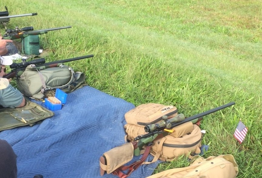

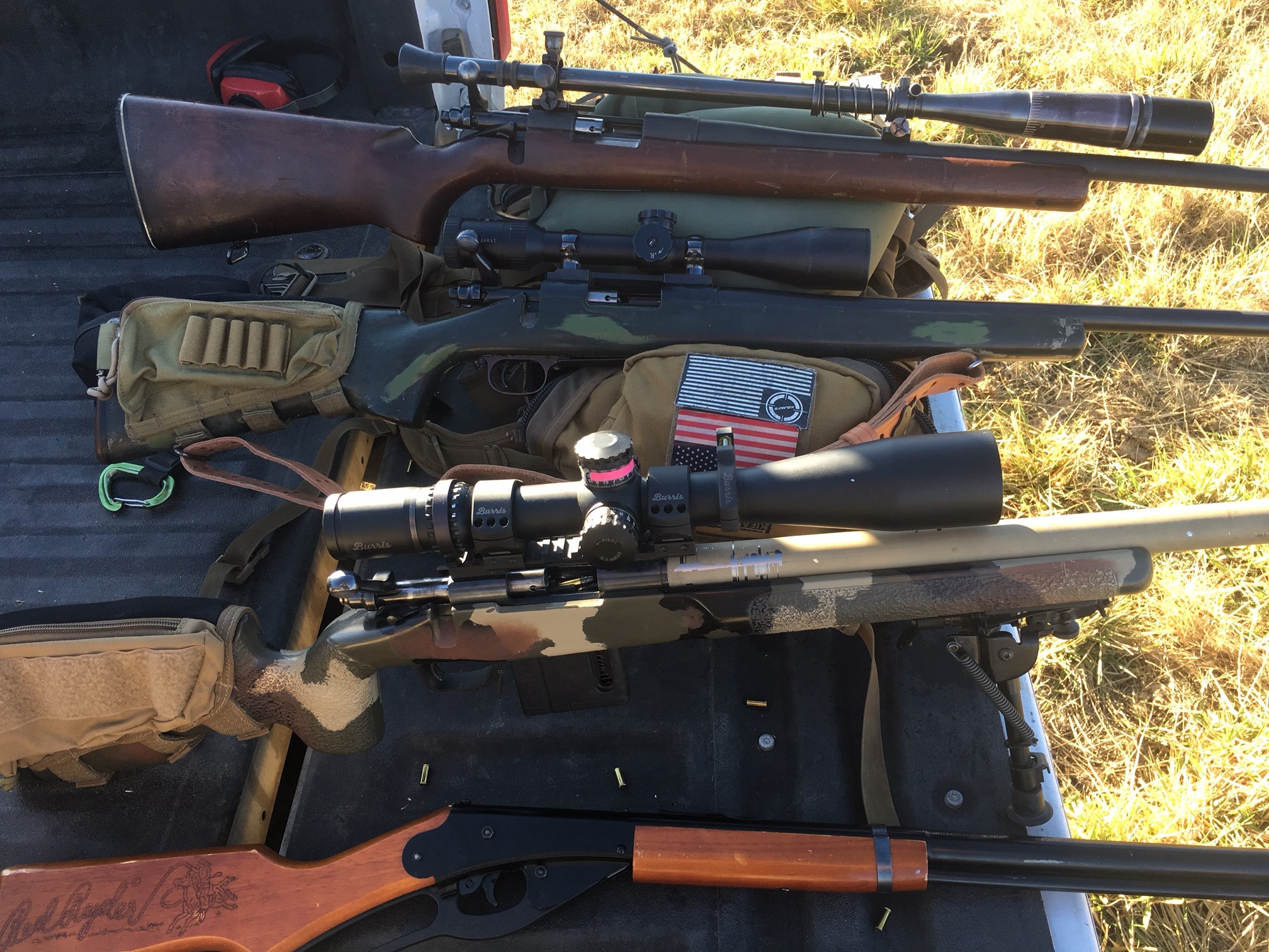

Attached is a 2017 pic from a match with a replica M40A1 /T10 and real USMC M40A1 rifle with a Unertl, but the finer 1/4 MOA adjustments on the T-10 allow for more precision shooting than the Unertl, and my buddy usually out-shoots the guys with the Unertl & MST-100s. Just an fyi.
There is nothing wrong with your current scope, but just an fyi re my understanding of the Weaver T-10 used in long range matches.
Yes with 1/4 minute clicks and an adjustable parallax the T10 is a more capable range scope than the Unertl.

Attached is a 2017 pic from a match with a replica M40A1 /T10 and real USMC M40A1 rifle with a Unertl, but the fine 1/4 MOA adjustments on the T-10 allow for more precision shooting than the Unertl, and my buddy usually out-shoots the guys with the Unertl & MST-100s. Just an fyi.

The T-10 is still a capable rifle for the sedate range world.
As far as its construction its a steel tube than will likely survive what aluminum may not.
You can spend a lot more for a more capable scope but if you are interested in M40A1 than a T-10 is the most cost effective, historically relevant best performing scope you will get.
My A1 runs a USO MST-100 and I have two M40s that sport the Leupold replica green scope that really has no similarity to the original Redfield.
When I wanted something with a modern optic I abandoned the historical PWS build and built what I wanted which was an M40A1ish. It features what I consider the best parts of the 40, the A1, the A3 and the A5. It sports a Premier Heritage ST, 3-15X with mil dot reticle.
Put the St-10 on this rifle than start another build with the money you save.
