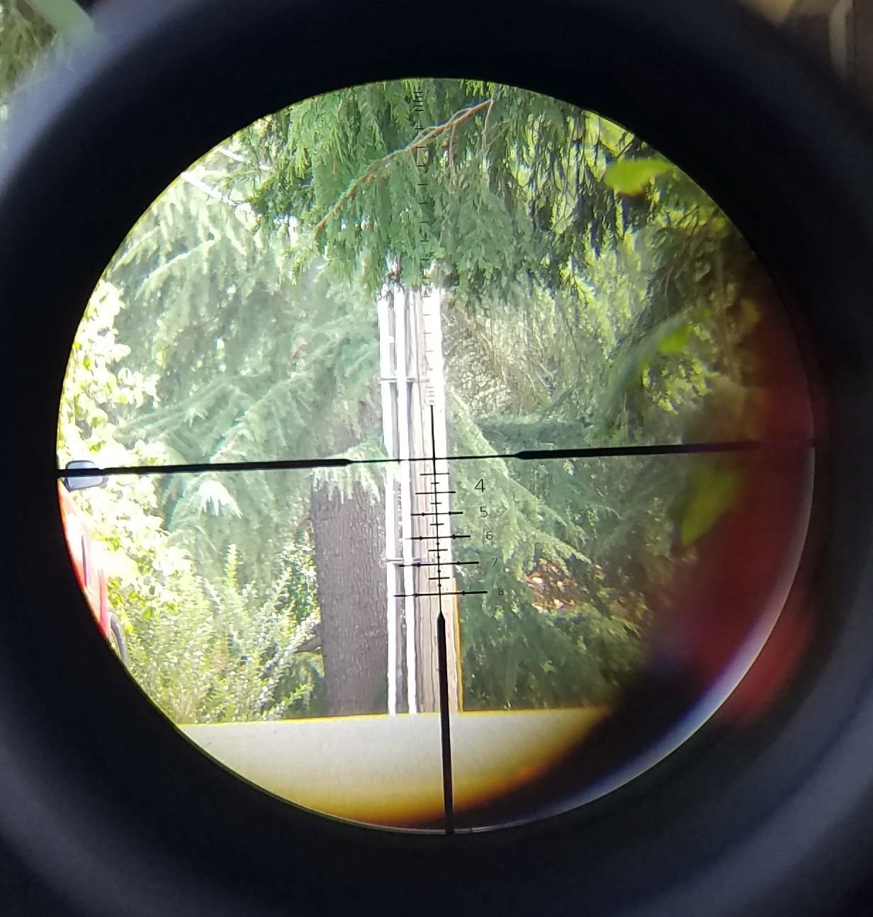

I have the plumb bob on the end of my 50 foot deck and a benchrest set up.
But a lot of scopes do not focus at 50 feet.
So I have figured out which telephone pole features are plumb, 200 yards out.
The worst problem is some scope levels move when tightened.
I have a couple rifles to build, maybe I wll work out some scope level pinching.
