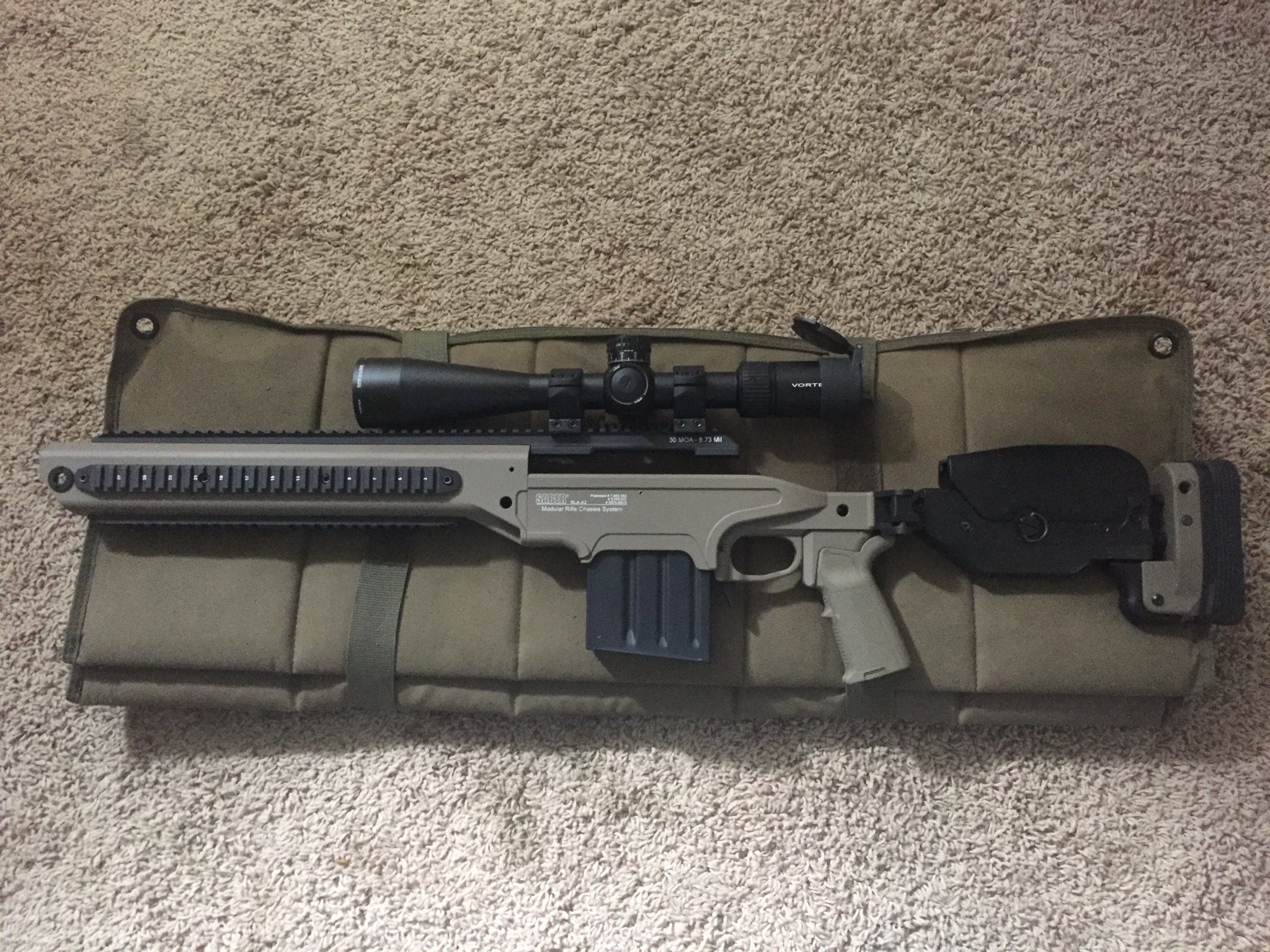

Rifle FN SPR 308- scope NF 5.5-22-56. Rail badger 20 moa. Currently the scope has high 1.125 NF ultra lite rings. My goal is to try and get 1/8" spacing obj to barrel spacing. The spacing from objective to barrel is just under a 1/4". I installed some med 1.0 rings and now there is 1/16 to 3/32 spacing.
I like the look and function of 1/8" spacing and the small difference helps on the fit and cheek weld. I have looked for and cant find any rings that will get me there.
Is 1/16 to 3/32 to tight on spacing?
Any thoughts on how to get the spacing?
