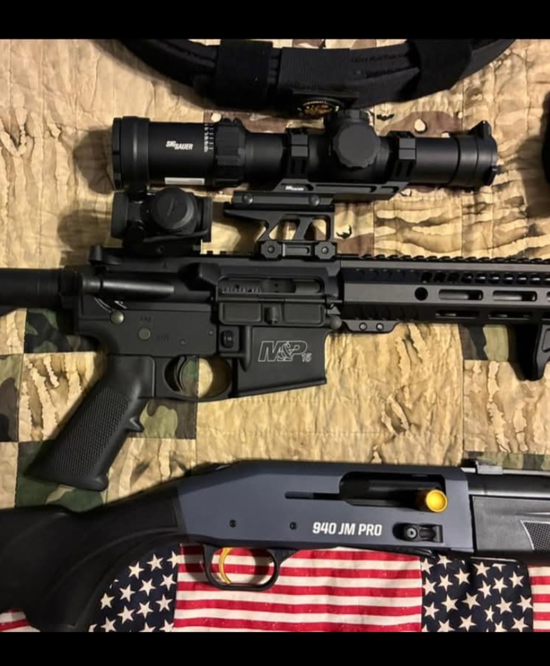

I struggle with this new trend of ever increasing height over bore. Good thing there’s options!
Anything but this.
