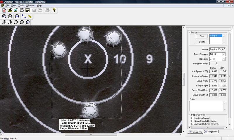

I need this target scored please:
Five shots.
I am not scoring it myself for a couple reasons. First, I'm not sure I can be 100% objective. Second, I fired five rounds, almost certain that I hit with all five rounds, but I cannot find the fifth round.
I <span style="font-style: italic">think</span> it went through the same hole as another, as one looks slightly elongated, but I do not want to make that call. If you see it, please tell me which one it is.
I'm leaving the pic full sized; please click on the thumbnail to view the full sized pic.
The center is 0.5" across the black.
Please let me know what you all think!
Thanks!
Josh

<div class="ubbcode-block"><div class="ubbcode-header">Originally Posted By: dhutch</div><div class="ubbcode-body">Your bottom hole is from 2 shots. </div></div>
That is what it looks like to me too.
Re: Score This Target Please!
49-1x.
elongated hole on bottom goes down also.
Even though a x is an x, nothing is solid.
Tighten up the group, and no discusion needed.
Keep going, and find a place where you shoot one bullet per spot.

Hi Folks,
I want to thank you.
Here is a screen capture of what I'm looking at:
(click the pic)
I have this posted on at least 10 boards, and there is a 50/50 split between opinions as to whether the double is at 6 o'clock or 1 o'clock. I initially thought it was at 1, but I agree now that it was at 6.

The smallbore guys at my club would get the overhead projector out, blow up the shadow on the wall and measure each hole to see which was out of round. Then look at how far out of round the double was and see if it would cut the line with both shots.
Most non OCD shooters at the club would chuckle at these guys and commence to shoot for the next hour while they measured, argued, and called each other names.
I've seen it happen upon occasion... it's not a joke.
I think your quest is a noble one, and I think you can do it the next time out if you allow sorting that bulk ammo. You might shoot an oddball 0.99 MOA group without sorting them, but I'm pretty sure you can do it quickly by spending about an hour sorting through that bulk pack.
EDIT: If I was scoring a match and this target came in I'd just give the shooter a 50-1x, if someone beat it fine, if nobody got within a point then I wouldn't think twice about it. When one of the above mentioned guys got huffy about it then the overhead projector would come out...

Josh,
The bottom hole is two rounds. +1 on mtstcon, Get a .22 scoring gauge. Champions Choice has magnified HERE and non-magnified HERE . They're cheap and it takes the argument out of the equation. They also have overlays but IMHO the gauge is cut and dry.

(Editted to change score estimate from 50-1) I'd also guess 50-2, true bullet diameter will be larger than the black ring.
Here's another style of scoring device. No plug to enlarge the hole ("non-invasive"), and scores 12 rifle bullet diameters from 22 through 40 calibers. Click thumbnails for larger views.
Is this an "X" or just a "10"?
You'll notice the target "grain" running vertically in that photo, and the hole is actually wider than it is tall due to this.
Outer edge of scribed line is true bullet diameter - it's an "X"....

Scoring "best edge", you only have to touch the outside of the next higher scoring ring to get that higher score. This time I zoomed in on the target, and assuming the "double" is at 6 O'clock, I'd now score that a 50-1X, as the 10 O'clock hole probably would not contact the X-ring (only the 12 O'clock hole would be an "X"), and (probably) "both" 6 O'clock holes would be "10s". If it was scored "worst edge", it would be a 48-0X....

I've scored enough round nosed bullets to know that is a 50-2, without a doubt.
Until you get the correct scoring plug and plug a lot of targets you really don't know if "it'll go" or not. You will call them out often. I did for a few years scoring my own smallbore targets, then got educated.
