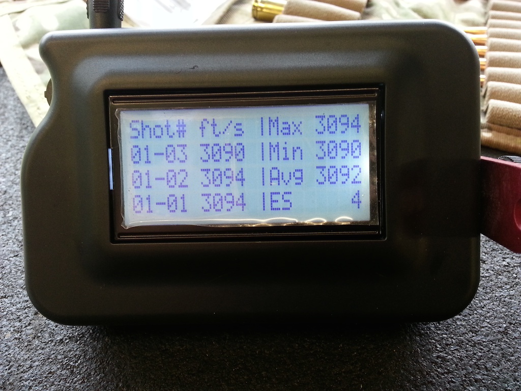

Consistency! Neck tension plays a huge role!
I have reloaded for 20+ yrs, i can only relay my experience. I have found pocket uniforming, fh deburring, consistent nk tension, and proper powder charge all do more then primers for low es)sd. I have only used br2&br4 in that time frame with the exception of 1k rem 6 1/2 bought last year. Paying attention to the my listed items, i have never had much difficulty getting lo teens es and 3-7 sd. Keep in mind that an ar gas system adds one more kink to getting very consistent numbers
See now I will go the other way... That picture was taken with my standard loads. I do none of the above, and I use standard winchester brass. I deburr the flash holes (on new brass), and I chamfer the necks when I load. That's about the extent of it. I use .002 neck tension and I use the carbide expander ball. Seems to be working out for me.
That all being said I've only been reloading for about 4 years so I don't have nearly the experience that the gentleman above me does. What I did learn I learned from bench rest shooters, because no one knows accuracy like they do.
