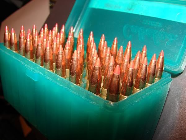

I just began to reload my new .260 and when i load the bullet (redding micrometer seater for 140VLD) I have a little stick after oading when i raise the arm and it leaves a ring around the ogive of the bullet. Any ideas?

I assume it looks something like the above photos! I have found that it's typically the combo of high neck tension and a soft bullet jacket.

I put some solvent on a q-tip and ran it up inside the die for cleaning but if it is more difficult than that to clean I may not have completed the job. I am using 7/08 brass necked down with the .289 bushing and the bullets seem to seat very smooth it is just the draw back that seems to stick to the bullet. It actually looks just like the bottom ones Terry. It is less a dent ad more a mark. I cant even feel it with the tip of my finger but if I rub with my nail there is a slight catch. I am using 4831sc so there is a slight compression on my loads (45.5gr) so far but I plan on going up so.....
