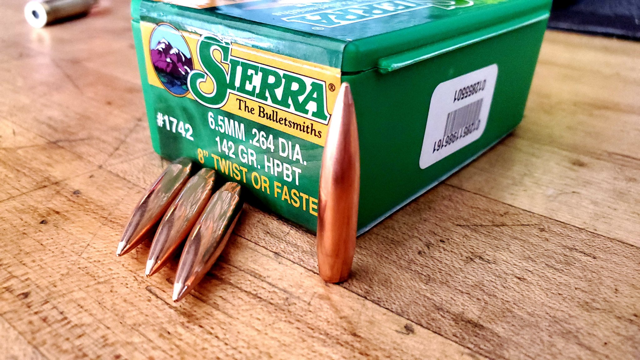

    Ok, so, as part of my finalization of a magical load for my Tikka T3x Tac A1, 6.5 CR, I chose the Sierra 142 pointed Matchking to devote my love and attention to....
    They're pretty:
    41.3 grains of H4350, Prime brass, Federal 210M primers is the recipe.

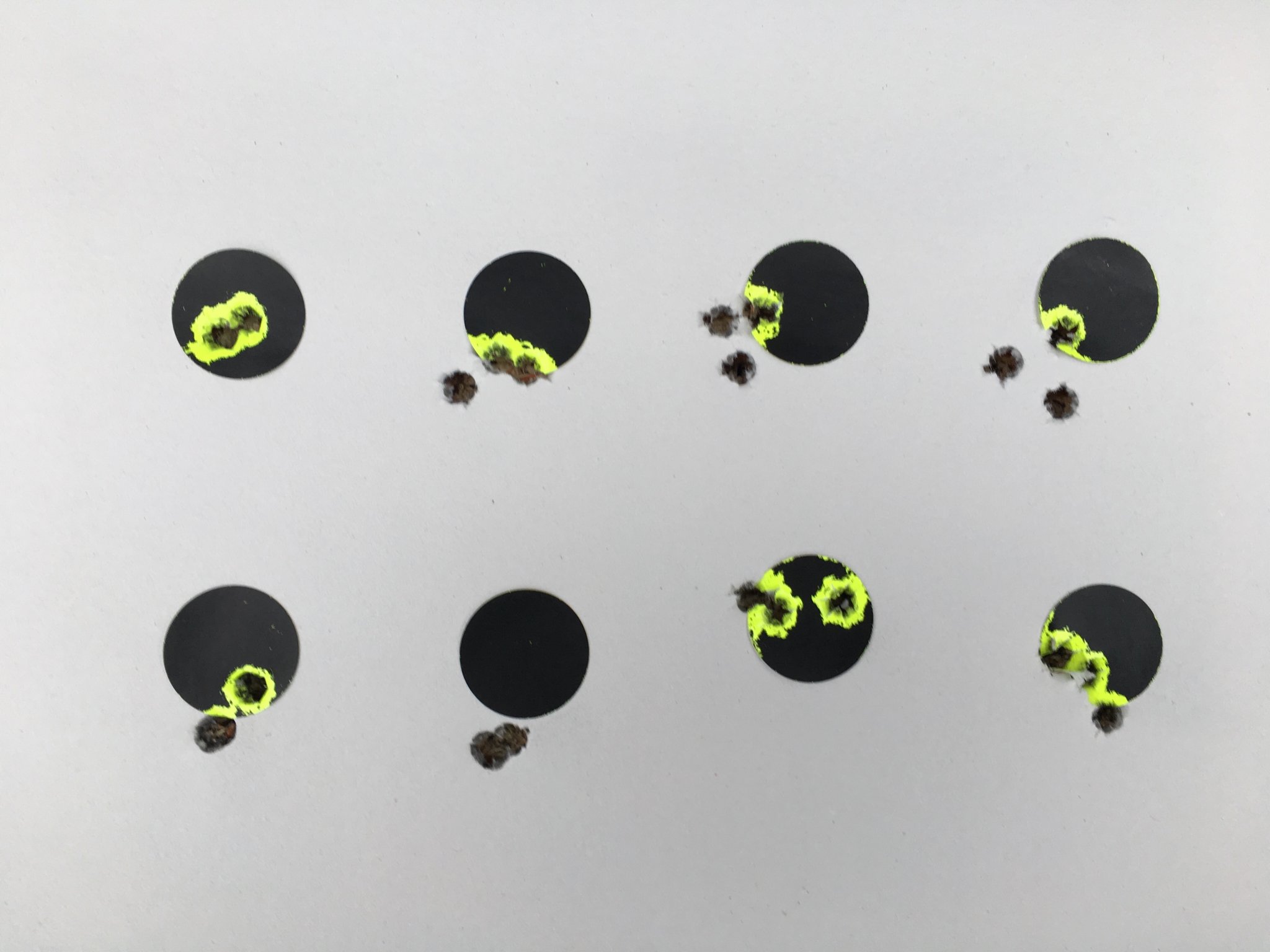

    Today, I did the test at 201 yards. 2 groups of 5 for each depth. One group aimed directly at the aiming spot, the other was 0.5mil right with my magnetospeed mounted. I dialed 0.5mil right and aimed at the same aiming spot.

    .030" jump:
    V: 2727, SD 5, ES 14
    .060" jump:
    V: 2725, SD 9, ES 25
    .090" jump:
    V: 2729, SD 16, ES 42
    .120 jump:
    V: 2734, SD 5, ES 13

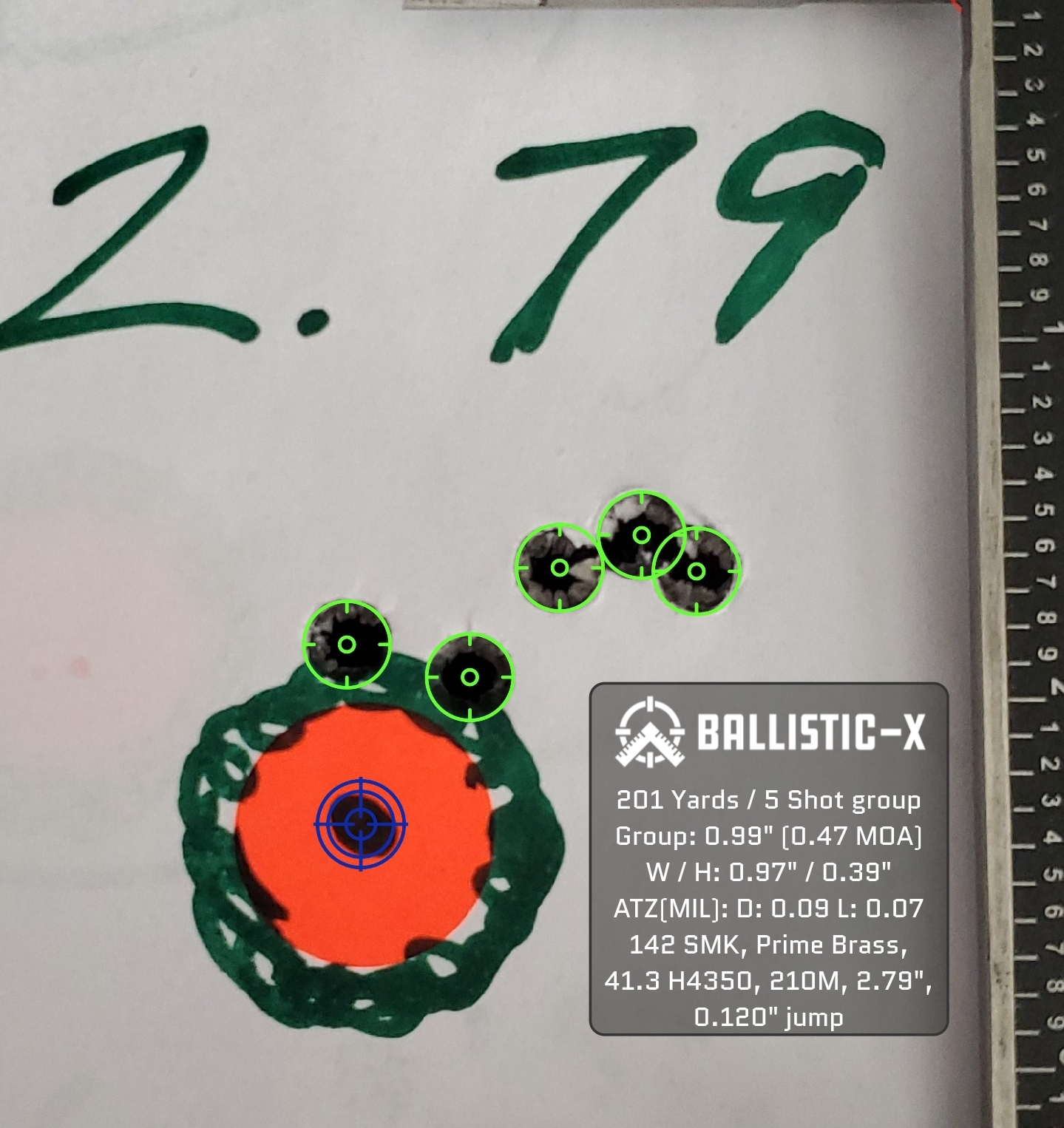

    One thing that jumped out at me was as the jump increased, the point of impact shifted up from below the aiming spot with the .030 to even with the aiming spot at .060 and .090, then above the spot with the .120 group.
    I'm thinking of going with the .090" because A. It had the best average group size between the two groups (also, 0.24moa is the best I have every shot ever in my life) B. The 5 shot velocity data is usually statistically BS and usually just a guide.
    Question: Should I maybe look at the .120" jump? I ask because when doing a ladder test, we look for charge weights that have the bullet evit the barrel on the top of the sine wave upswing.

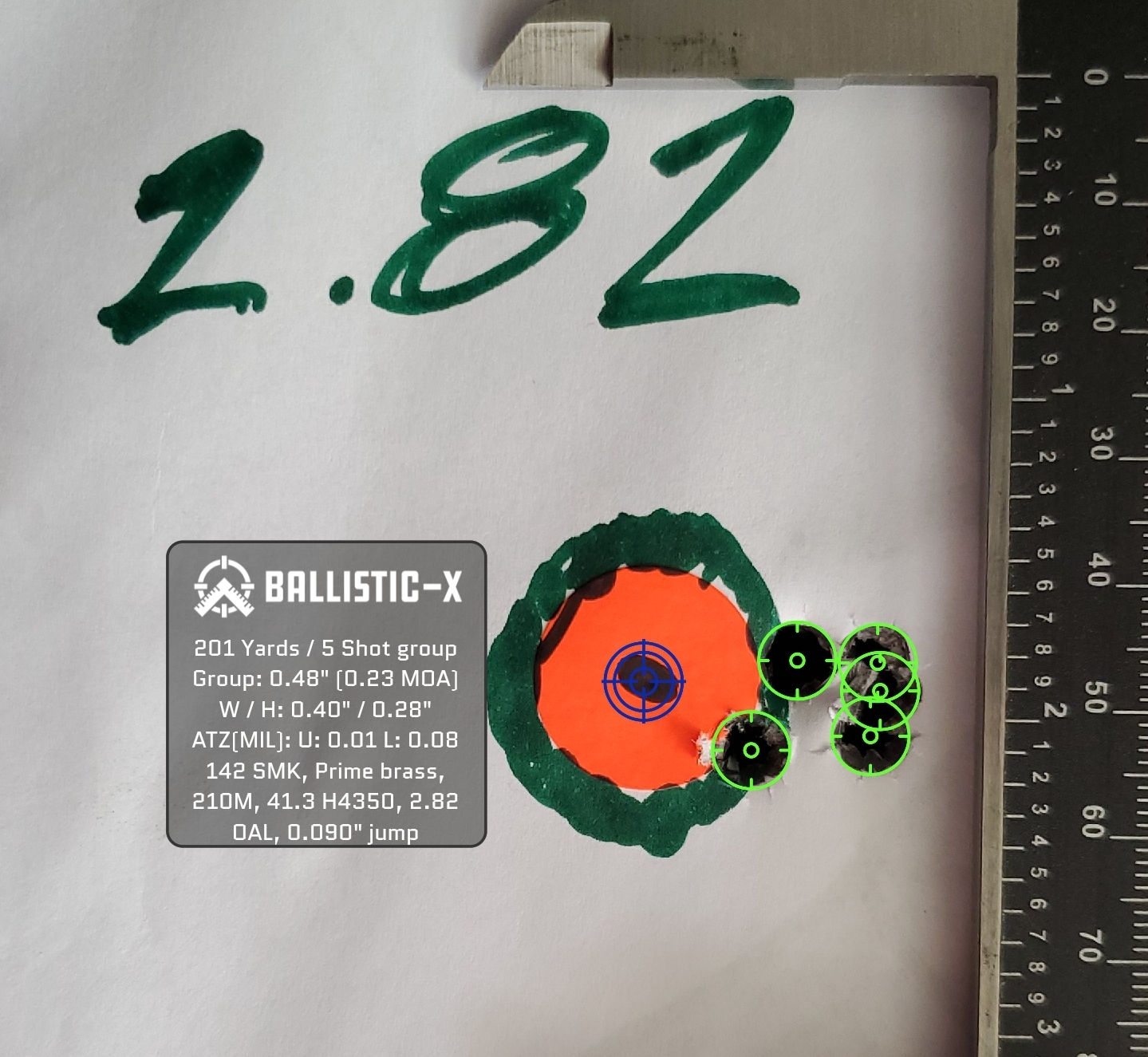

    The first group that impacted on the aiming spots was without the magnetospeed. The second group to the right of the aiming spot was with it attached. So, one group without, one group with.

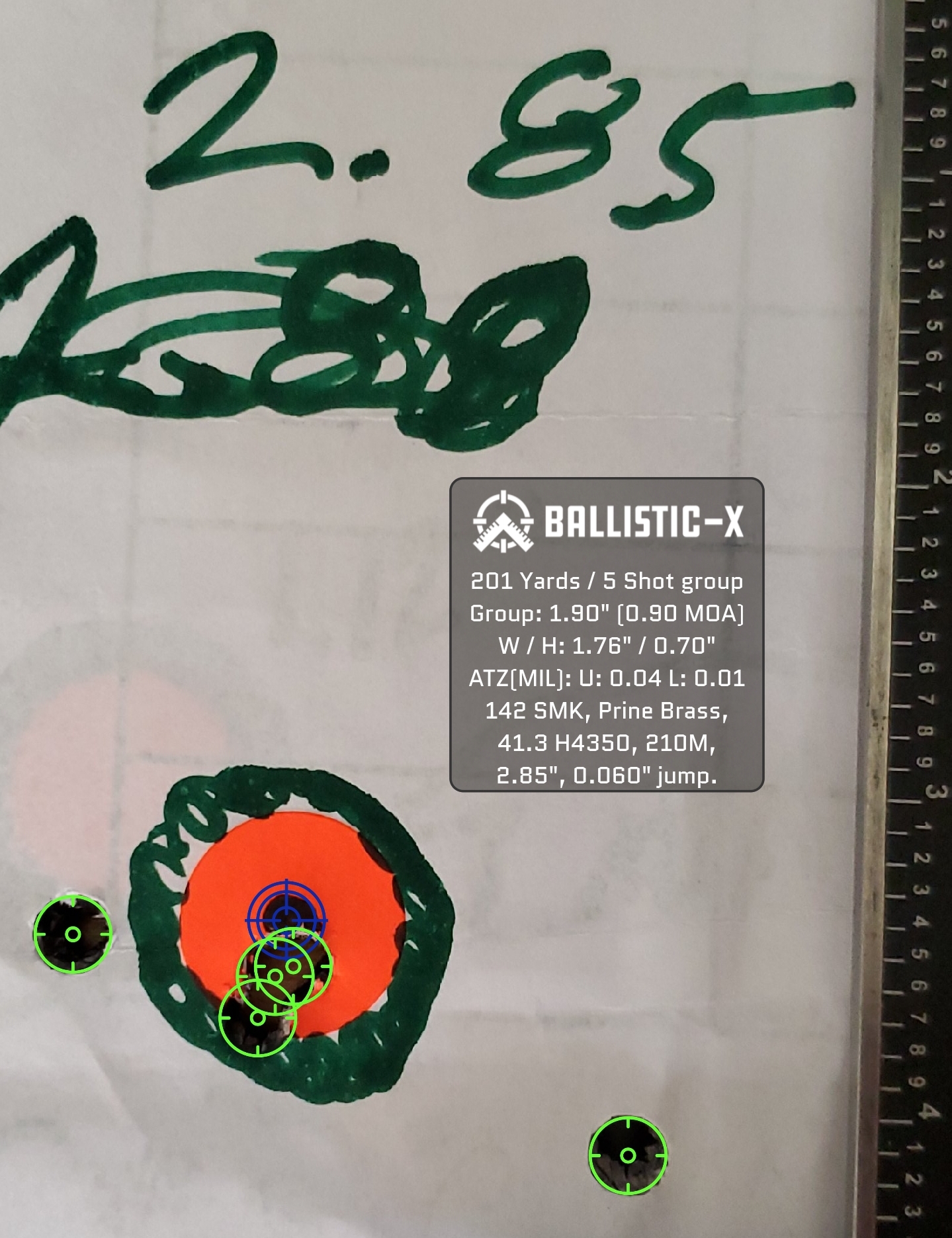

    Your .060 group is also a decent group. The 2 outliers could have been wind or you but 3 are stacked.

    In that case, think I'd try 75, 90 again, and 105, to see where the group and velocity spreads are optimized. SD and ES for 090 wasn't great compared to others, but group was nice. Worth running again to see if she repeats.
    IMO the SD 16/ES 42 @ 2.820" is an anomoly.
    All the other groups around it, before and after, agree with each other as far as the number go. I would ignore the numbers on this one. Seating depth, within reason, doesn't have much affect on the velocity numbers unless you are playing around into the lands.
    I would bet that the 5 on the orange target at 2.820 were just as tight on the numbers as all the rest. You could probably stay here and be just fine.
    Notice the POI rising as you go from 2.88 to 2.79.
    As far as positionally, 2.790 is in a better place because it is higher on the target, and therefore more probably at the top of the barrels nodal travel. It is also not very far from coming together. if you wanted, you could take 2.790 and go .005" either side and it would have a really good chance of coming together.

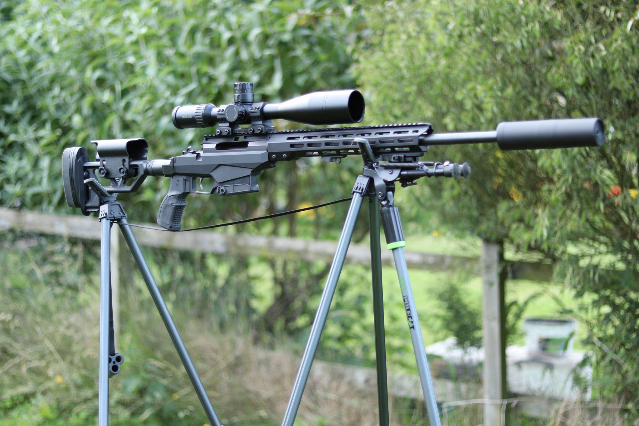

    It should be possible to get somewhere in the region of 3-4fps ES and 1.0 SD with a factory T3x Tac A1. My particular rifle liked Hornady dies with the elliptical expander mandrel installed, Hornady brass, Federal GMM LRP, H4350, Hornady ELD-M 140gn. I started at 2.820" COAL and worked my way in until the groups tightened up.
