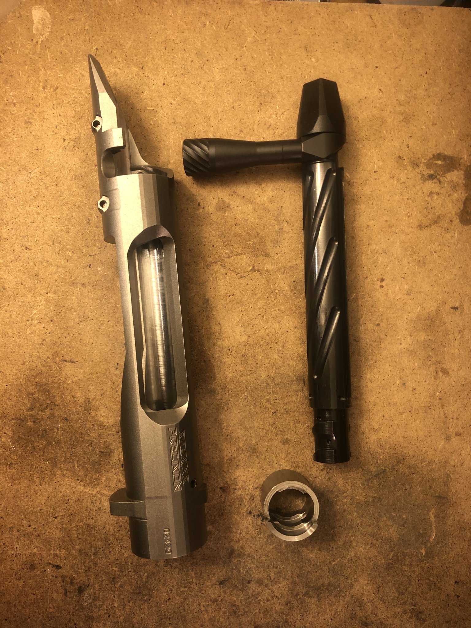

    The Hit is a different action from the standard Havak, although sharing the same bolt and breach block (think kinda like Ruger American vs. RPR - same deal). All of the Seekins bolt rifles use the same barrel tenon and headspace dimensions, because they all use the same bolt and the same breach block.
    The Havak’s fit R700 footprints, EXCEPT, the forward end of the action ahead of the recoil lug is longer, which isn’t always relieved sufficiently, and the bolt stop, also not relieved - THIS is the modification the rep was likely mentioning; you don’t modify the action here, you modify the stock/chassis, just the same as modifying a chassis/stock to accept any custom action with a side bolt stop/release.
    The Havak’s use a stainless steel receiver body. The PH1’s used a steel bolt body which was DLC coated, the new ones are aluminum bolt bodies which are cerakoted (ala the Element). The Element is the same receiver, but made from all aluminum. To pull this off, they use a steel breach block into which the bolt head/lugs locks (think AR-15, but instead of fixing the barrel extension to the barrel, those lugs are cut into a steel bushing which just slides into the front of the receiver body.
    My Havak started life as a PH1, but when I sent it in for the cock-on-open bolt retrofit, they replaced my action entirely, which is technically now a PH2 design. It dropped into the same stock inlet when it came back. But admittedly, the new bolt feels like shit compared to the old bolt, and I’m planning to ship it down the river soon, after 5 years of using the original Havak action for PRS competition.

    No, the breech block is their steel insert in the front of the action into which the bolt lugs lock. You can see in my photo of my original action above, there is the action, the bolt, and the breech block. Think of the Havak design much like an AR-15, such the action doesn’t necessarily have to take the force of the firing, but rather the lugs bear against the steel barrel extension - in this case, the breech block. That’s how Seekins gets away with having the aluminum action on the Element - the bolt lugs lock into the steel breech block.
    Glen replaced my action once on a whim, I expect if they can’t get the new action running, he’ll replace it too with one that does. I’ve texted him back and forth a lot since I’ve had my Havak, he’s taken great care of me, so I’m not terribly concerned that he has to rework this one.
    The PH2 action is the same as the PH1’s. They use a different locator pin location than the original design, and they changed bolt design and coating. The bolt design change is a big upgrade. The coating SHOULD hold up. I’m guessing I just didn’t get a good cure on my cerakote batch for my bolt. I got a lemon - not all PH2’s or Havaks have the issue mine had.

    No. It's how they get away with using the same design for all of their actions, even the Aluminum bodied Slam and Element. The bolt lugs are locked into steel, not aluminum. So they get a light weight action but with the proofing strength of steel. Bat Machine is using a similar design in their new Vampire actions.
    Thank you...that's a bit surprising to me as my OG Havak is steel (as you know) and I sort of...kind of...remember it being the only action offered at that time....no aluminum action. I guess that Seekins was smart and looking ahead if this block was to accommodate future aluminum actions.
    as the original production runs were DLC coated, not nitrided.
    Eh, it might well be DLC....not sure I could tell the difference on a bolt. My bolt is black and its not a coating, its a treatment so...DLC??
    I don't think any of the new cock-on-open bolts have steel bolt bodies. Given a slick coating, I don't think that makes much difference.
