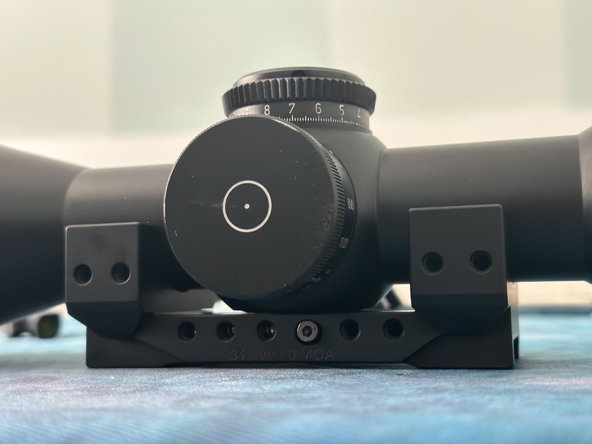

To All the, We want lower in bigger scope crowd,
you guys are not smart at all, and should please just stop with the lower. Lower is bad, lower rolls your head, lower compromises every position except offhand, lower is fucking stupid
This is 1.18" mount and it's supposed to be one of the most popular heights, this is how dumb the end users are,
They don't fit, the saddles are too big so you can't mount the scope. If you are less than a 1/4" from your barrel with your bell odds are you bent your tube, or compromised the scope. Lower is not better and does not work.
For our modern shooting and rifles we should be 1.3" at the lowest point, and higher is better fundamentally. Stop asking these guys to make low. Lower is an old wives tale that needs to be retired

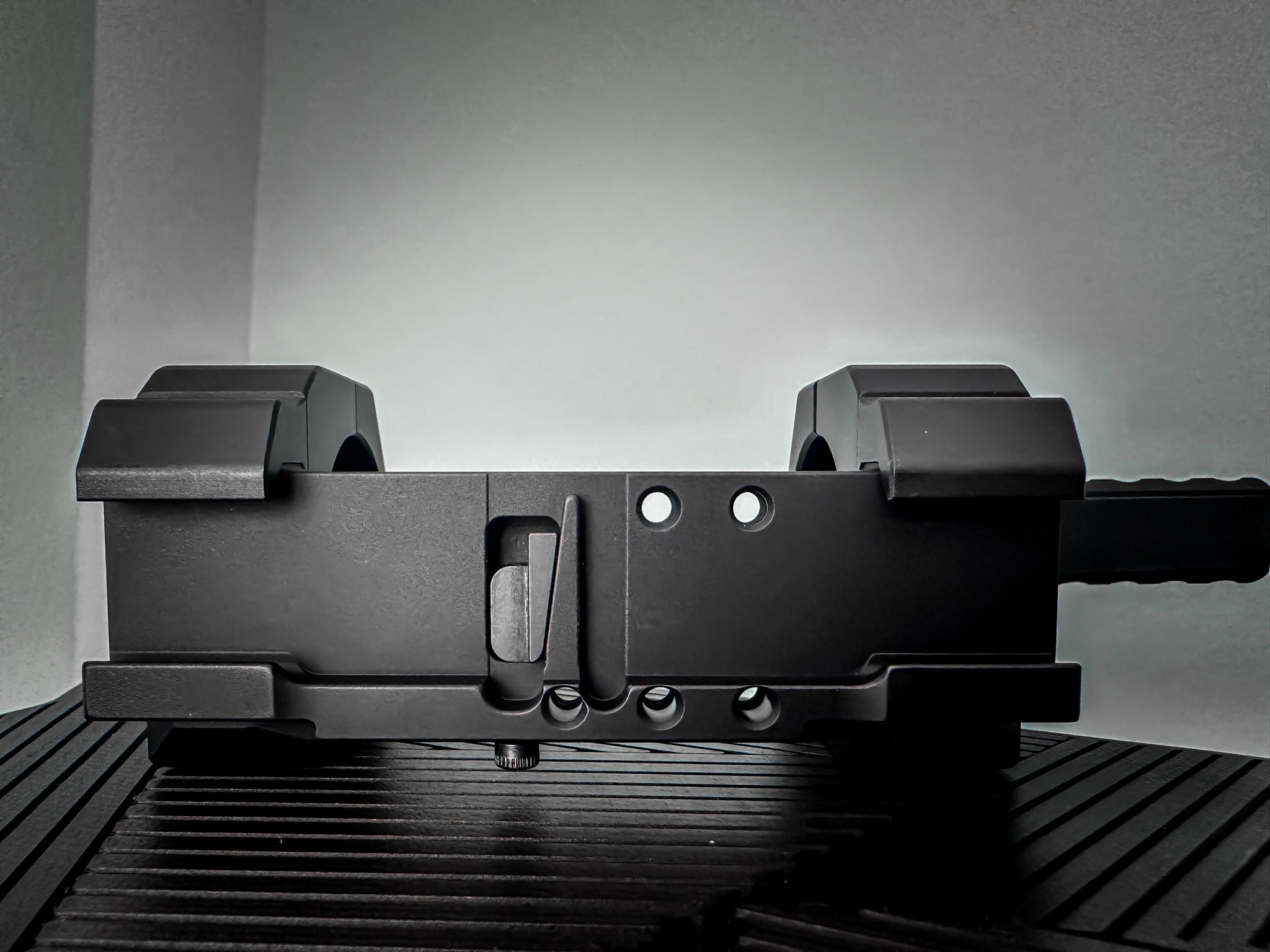

Is that necessary? I mean in addition to cross bolts?
Look at the bottom. It's instead of, not in addition to. No cross bolts engaging the rail.
Reactions: AleksanderSuave
Oh yeah, I think I’d have a to see it to fully comprehend.
As I understand it it silver-colored wedge slides against the black one, expanding to occupy the space between two picatinny lugs and abutting them. The cross bolts engage the sides of the rail form and the wedge engages perpendicularly.

I like levels on the rings because I worry that when mounted on the tube, smacking the level could result in a bent scope tube and levels are very easy to smack the way they hang out. The level adjustment screws should make it a bit easier to get the level properly leveled to the scope adjustments. I wonder if it makes the level less robust than one integrated into the ring cap such as the Hawkins and if that's worth the trade off though. I haven't found it too be too difficult to align levels properly with the scope reticle even when I don't "cheat" and use my scope testing jig. The level looks to have ample room for light to illuminate it and to be in a good position for you to actually see the thing without moving out of proper sight alignment so all good on that. I like the wedge idea for what amounts to a recoil lug. Bobro does something similar in their quick release mounts and it is probably the main key to those mounts return to zero function. Does Seekins specify a direction forward on this? I would have thought the half milled into the mount would be against the forward lug instead of the adjustable half. Does it matter? I agree that more folks scopes are too low than too high and am happy to see more cheek peices with the capacity to move higher. I'll be interested to see the price and options on this new mount. Given that those ring caps are compatible, I am at least as interested to see if they start selling their scope rings with the bubble level cap that can except the NV mount.

Because we have been removing scopes and testing them in class, we see it compromises the tubes on recoil when the bells hit the rails
We had a student, super low NF, about 1/8" off the rail, tested the new scope worked, next year did it again, off, and looking it we can see the bow in the tube.
You all think you are smart, but whatever ignore solid advice

The tapped holes on the sides of the "ring" part of the mount. Will these be for accessories? Do they happen to be the spacing sphur uses?
Anybody seen or heard of any provisions for mounting a red dot to this? Looking for something a little lower than the diving board.
I'm wondering the same. I've got a send-it I'd like to mount and I'm wondering if it'll fit.
