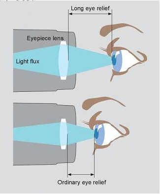

Perfect, that seems to be sort of what I found and observed, but was not sure, it's not just the distance between the eye (or I measured eyebrow) and the ocular, but also the angle in which the eye sees the lens.
My goal was to mark off adjustments (if needed) for each position.
Thanks much @Sharpened Graphite!

If I remember correctly Frank did numerous tests on this on a thread at the old Scout site, the conclusion was that if you have proper hold and cheek-weld the distance from your eye to the ocular should not change regardless of position. I see very little difference when I'm shooting off the bench, vs. when I'm shooting prone vs. when I'm shooting from a standing position. It comes down to the fundamentals of getting the proper hold (seated in the right place of your shoulder pocket and cheek-weld) every time, regardless of position. If you're finding that your eye relief is too far or too close causing a tunneling effect when you change position you may want to work on getting your proper hold in that position, it could also be that you have a very finicky scope (tight eyebox) which causes eye relief issues with even the slightest position off. This is often what is referred to as a very forgiving eyebox which you'll hear about mostly from the alpha class scopes.

In understand just what you said, it does help clarify the answer. I did some searching before asking here, primarily on a “composite zero” developed from each of the positions.
As you mentioned, as long as cheek placement is consistent, doesn’t matter. I don’t place the rifle buttock in my “shoulder pocket” but rather inboard on on pec muscle, right next to my cheek.
Optic is Nightforce 7-35x56 F1, pretty forgiving eyebox.
