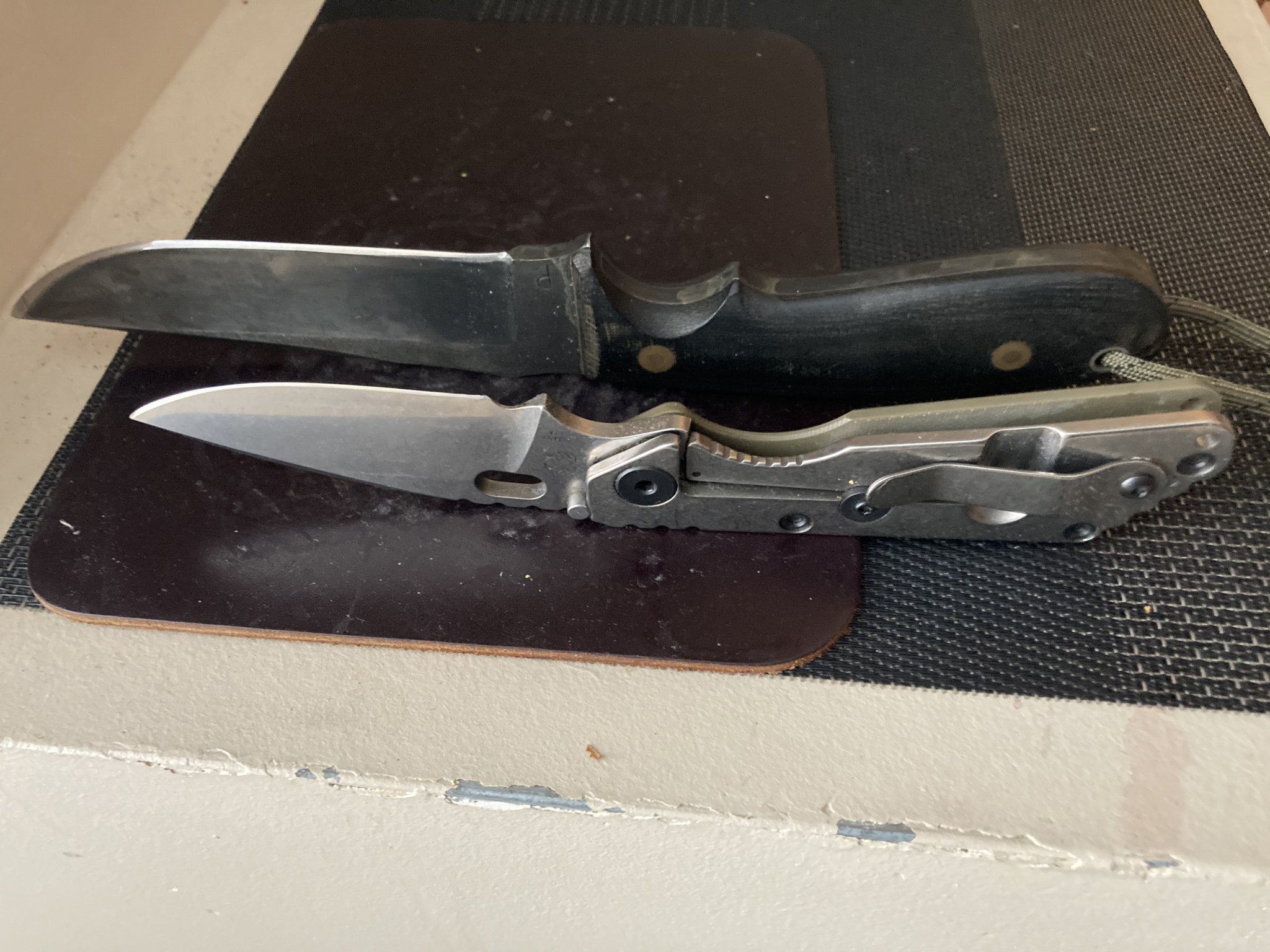

I like my thicker blades convexed; I use jeans or a belt to strop them as needed.IMG_6466.jpeg

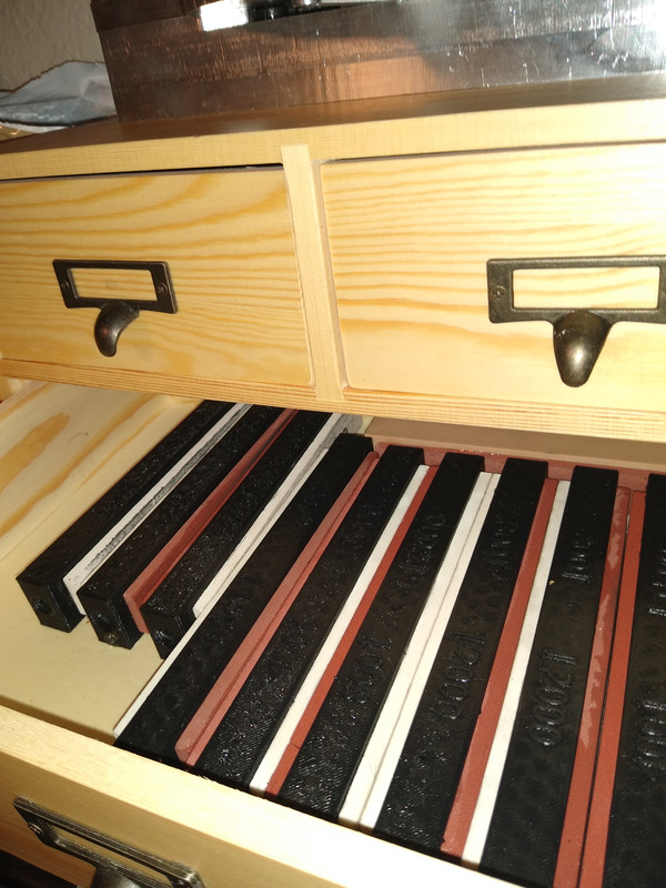

I made my own custom sharpener, similar to the higher end wicked edge system. It uses edge-pro stones epoxied to 3d printed plastic blocks. It gets my knifes really sharp, fast.
I bought the clamp from WE, I made everything else.

In design and manufacturing, Prototyping is rarely, if ever, economically viable. I did this for the challenge and fun of it.
I spent about 600$ in materials, including the gen3 clamp, which I bought from Wicked Edge, accounted for 250$ of my cost..
After 2 days of labor and half a day of CAD/CAM work, designing and tolerancing parts, buying a Wicked Edge would be more economical.
Though they are expensive, the WE machines are a pretty good value considering the material quality and design.
I decided to change the 3d printed stone holders though. The double sided version made it too easy to get a fingertip out past the stone face. Saves money on manicures, but made up for in Band-Aids.
I'm going with single sided holders, with fingertip protection.
