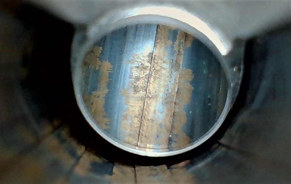

By the time I'm done, there will be two brands you won't want to buy. In the beginning because of an evil enabling colleague, I discovered how easy it was to build AR's. My second build wound up as my cheap 556 bench rest-esque gun. In its ultimate configuration, it was basically Aero upper and lower, Faxon 18" fluted barrel, SSA-E trigger, Bushnell Forge 4.5x27 (parent company is based in KC and my rifle club gets a discount at the factory store) etc. Life was good as I sat and fired 4 round strings at paper 200 yards away, regularly holding .7 MOA, with an occasional .45 MOA group thrown in. Then, one day, after ~900 round down the pipe, my <MOA gun became a 6 MOA gun. Long story short, the bore looked like this.
Faxon said they'd send a replacement, although they didn't have an ETA on when they'd run 18" non gunner profile barrels again. That was 2 months ago. In the meantime, other poor choices were made and I wound up buying a Ballistic Advantage fluted 18" barrel to stick in the gun. Because BA didn't want to be outdone, here's what the brand new barrel looked like out of the packaging on the day it hit my doorstep.
And because BA can't be bothered with even substandard customer service, they're requiring me to return this boat anchor for inspection before they send a replacement. Dimwit I spoke to started babbling about a third party seller, storage conditions....I came close to ripping his head off and pointed out their warranty says nothing about point of purchase.
There's my story. I know Faxon isn't well liked here, but at least they're not morons and saw their barrel was toast. On the other hand, Ballistic Advantage puts out crap and does its best to further inconvenience you. I'd say 'The End', but I still have two garbage barrels in my possession and zero good ones.

    Have any before pics of the Faxon barrel? Or, did you do what most people do with bore scopes, and only buy one after an issue popped up to inspect for an issue with no actual baseline comparison?
    The38Super
    May 10, 2020
    242
    206

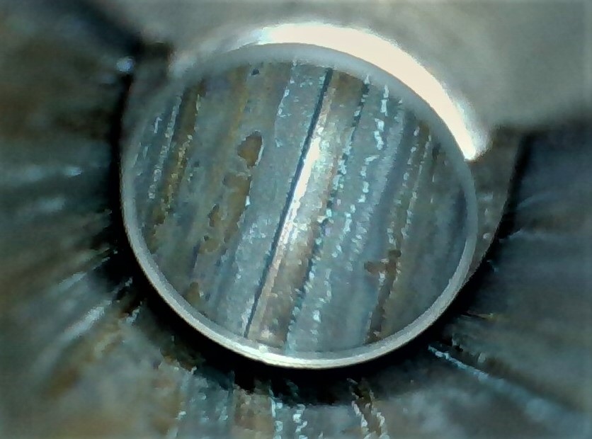

    My delicate feelings may be hurt at the suggestion I only bought my scope after an issue arose. I purchased it when any adult male would - because I saw it and thought it was cool.
    Here's the Faxon about mid way through its short life.
    After the accuracy went to hell - immediately following a range trip. Doesn't look bad, which confused the heck out of me.
    However, the next day, it looked like this
    As you can see, it's begun to corrode, along with some other interesting reactions.
    Here's a video (taken contemporaneously with the above pic) showing how the bore surface degraded.
    Faxon Barrel

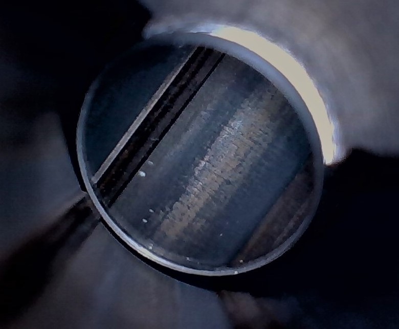

    Thinking about this.... maybe just fuck ton of copper fouling? Maybe could been corrected with several rounds of Sweets762 or other specific de-coppering agent.
    Ran a full course of Bore Tech Eliminator through the barrel, in the hopes the rust was confined to the surface. A) it's not and B) there was a bit of blue on one of the patches, but that's it. Broke in my Bergara BMP earlier this week and that had a fuck ton of copper, with tons of blue patches coming out of the barrel. It's definitely rust.
