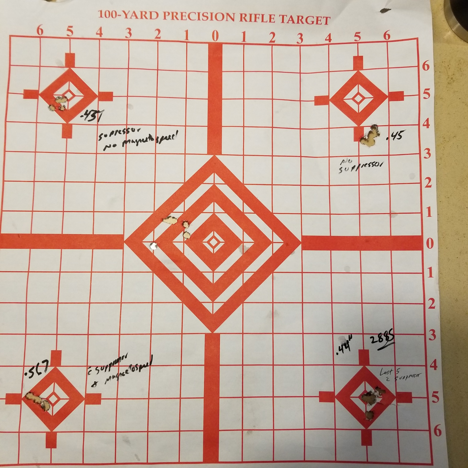

22" with berger hybrid 130 otm and 2880 and Varget with no load workup and very pleased with only one seating depth tried. Wanted simplicity and do not plan on changing.

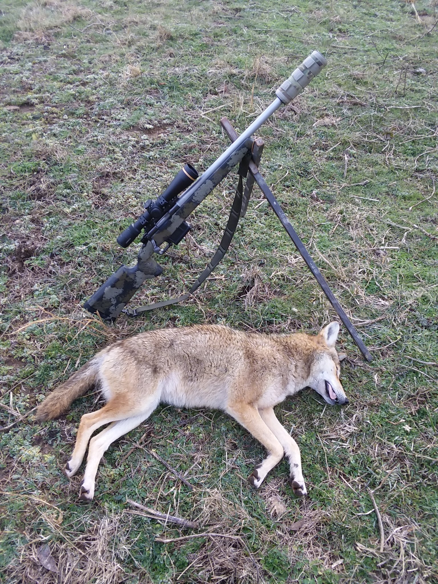

I grew up on my dads farm hunting with a 30-30. After about 15yrs in the military, 13yrs of it overseas, I moved back to the states and hunted in dads farm again. I started off with a 6.5 SAUM. Stupid. Talk about blown out meat. Then I went to a 243AI. Also dumb. Then I bought a Howa Mini in 6.5G. Just for kicks. Took it hunting. It was perfect for whitetail. Perfect expansion. No blown up meat. The following year I took a 6 Creed shooting 90gr TGK's at 3050fps. Because I'm dumb and have to learn lessons twice. I shot 4 deer that year. 3 in the head so there were no issues. The last one I shot in the body. The first round didn't do anything. The second round grenaded. It blew up a lot of meat.
This last spring, I took the rifle pictured above and shot 2 hogs and 4 whitetail in TX. Perfect performance everytime. Both hogs were at 350yds and 3 of the deer were as well. The last one was 100- something and I brained him as well. I now favor slower bullet for hunting. Id like to replace the 6 Creed barrel on my hunting rifle with a 6.5. Proof offers a 20" 6.5 Creed but I don't own a 6.5 Creed yet and would rather hunt with a spear than be a Creemore shooter. A 6.5x47L would be perfect. Get down to 2650 - 2700 in a light short package. Expand the bullet in the right shot placement vs blowing it up. Would a 6.5 Creed do the same thing? Haaaa....yes. It would.... But a 6.5x47L would be so much cooler.
