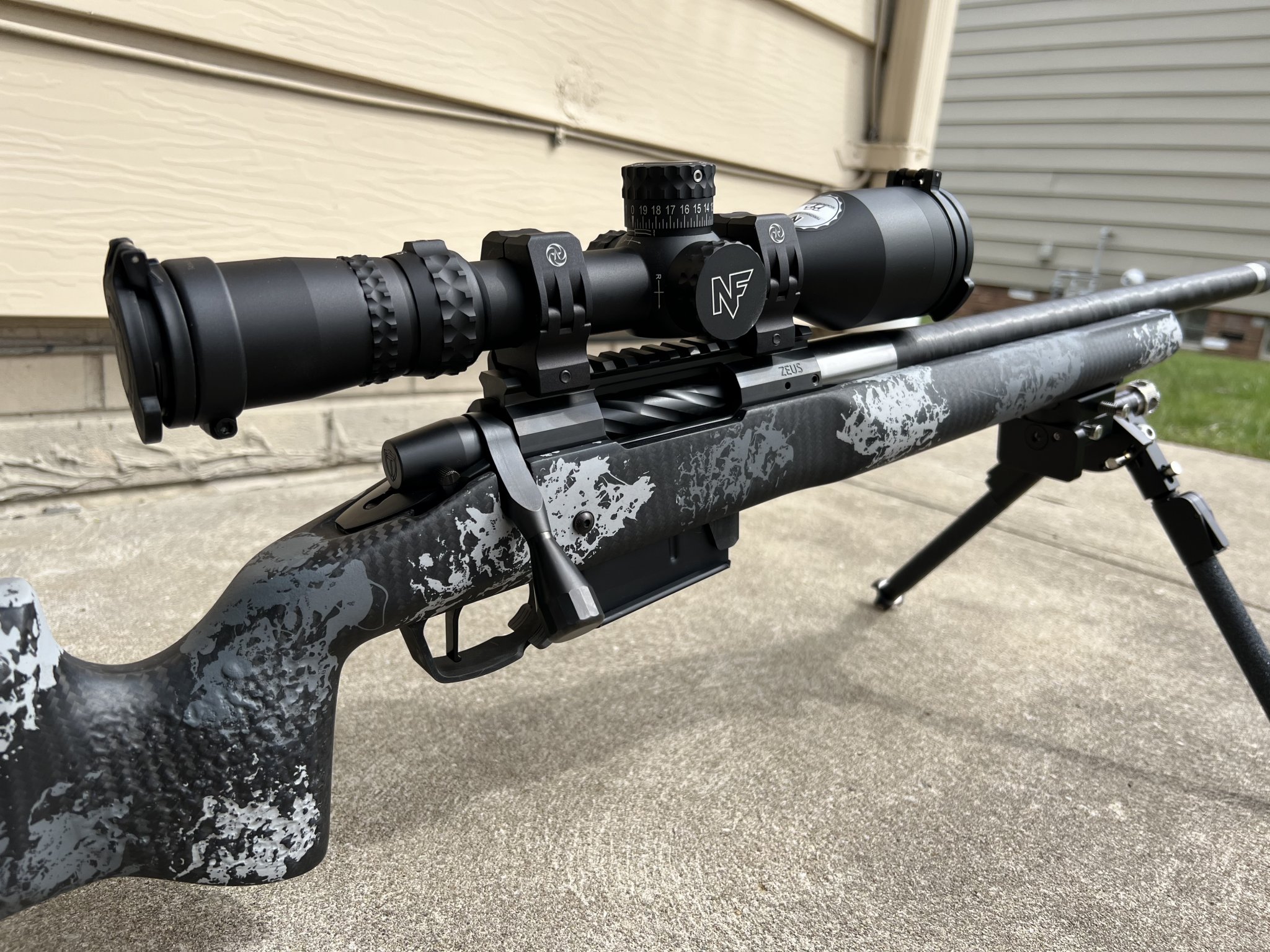

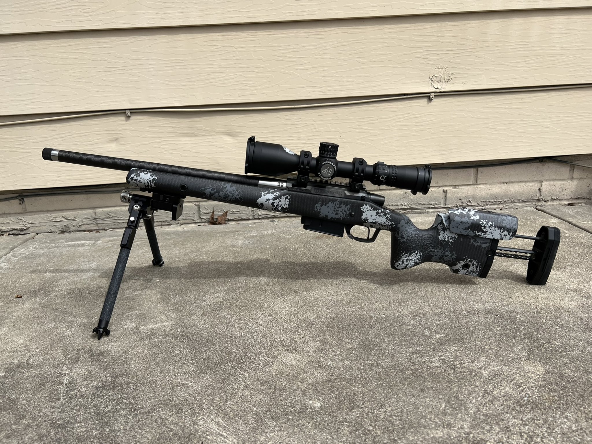

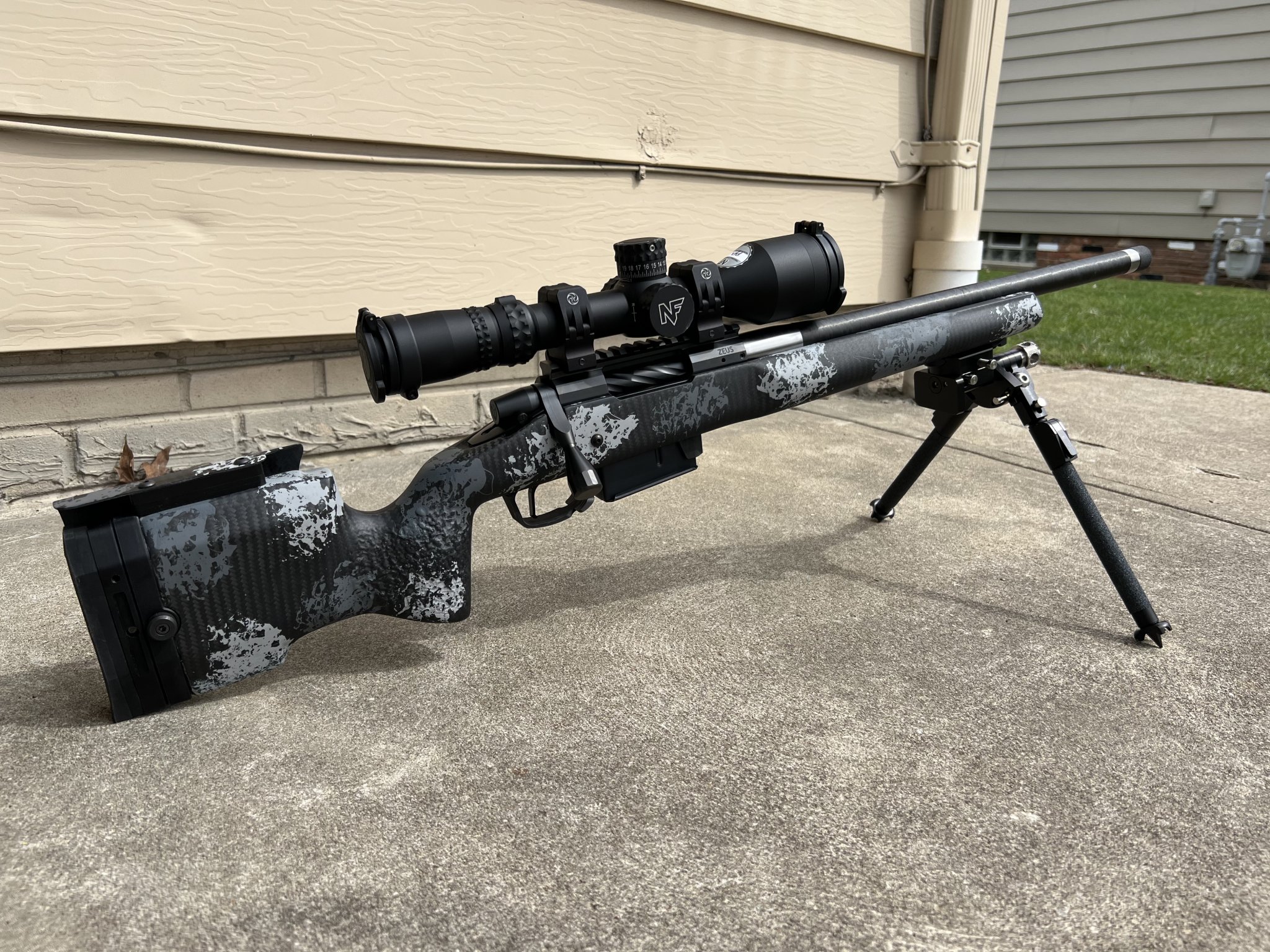

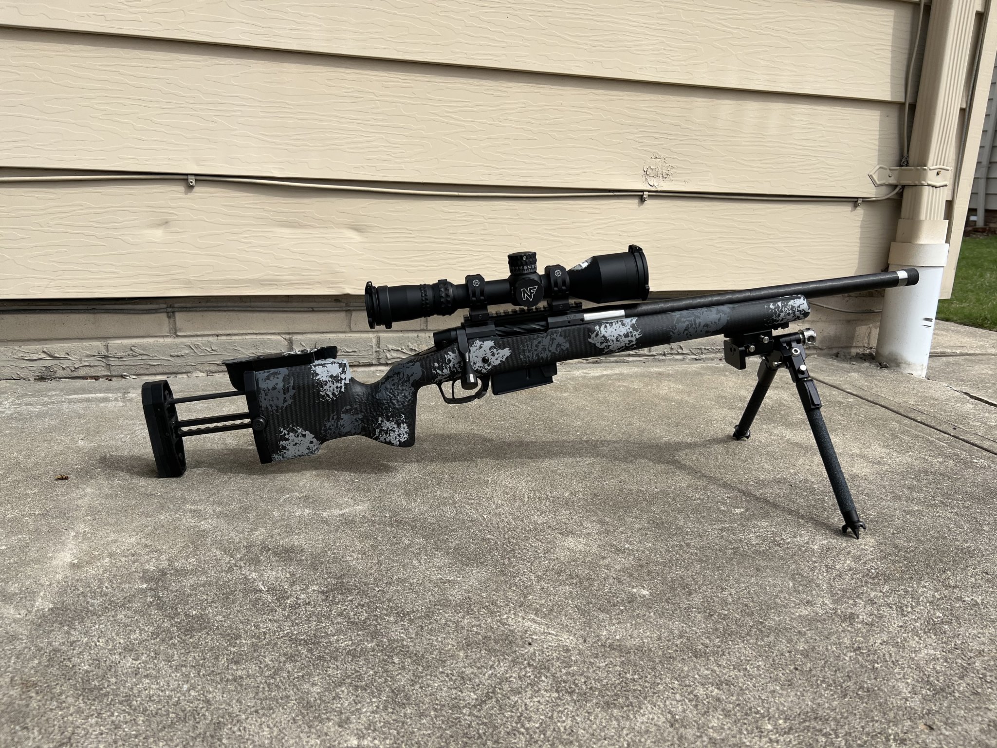

I just threw one together, but haven't had the chance to shoot it yet. I'm looking forward to hunting with it - should handle very well. Wanted something my kids could grow with as well and I think it's going to be perfect.
Terminus Zeus QC
18” Bartlein 1:7.5 chambered in 6 Creed
TT Diamond
NF NX8 2.5-20 F1
Manners CS2 w/ mini chassis
Terminus Zeus QC
TT Diamond
NF NX8 2.5-20 F1
View attachment 7844167View attachment 7844168View attachment 7844169View attachment 7844170
That’s a great looking rig there. Let us know how she shoots after you get some time behind her.

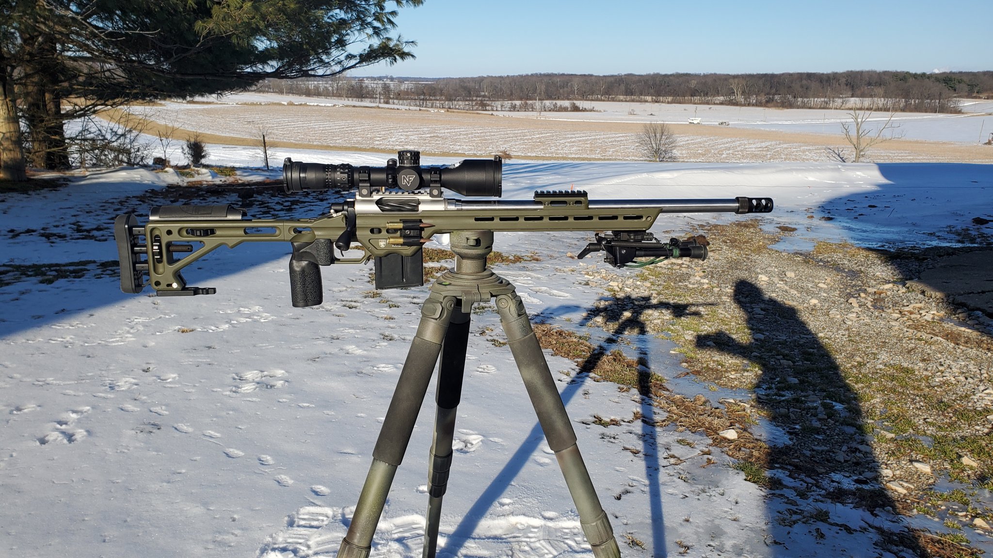

    Had a 16" 6creed on a badger action, have a 20" 6creed on a stiller now. Also have a 20" 6creed on an ai. I don't remember speed of 16" but drt'd a nuisance permit doe at 798yds with it and 105 hunting vld. The 2 20" 6creeds run 2920 and 2950, both with 105 hybrids and rl16.

    Had a 16" 6creed on a badger action, have a 20" 6creed on a stiller now. Also have a 20" 6creed on an ai. I don't remember speed of 16" but drt'd a nuisance permit doe at 798yds with it and 105 hunting vld. The 2 20" 6creeds run 2920 and 2950, both with 105 hybrids and rl16.View attachment 7844577
    Nice I appreciate the info man. Sounds like 18-20 inch will definitely get the job done for how I’m wanting to use it.

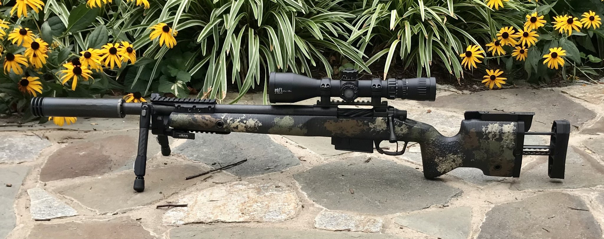

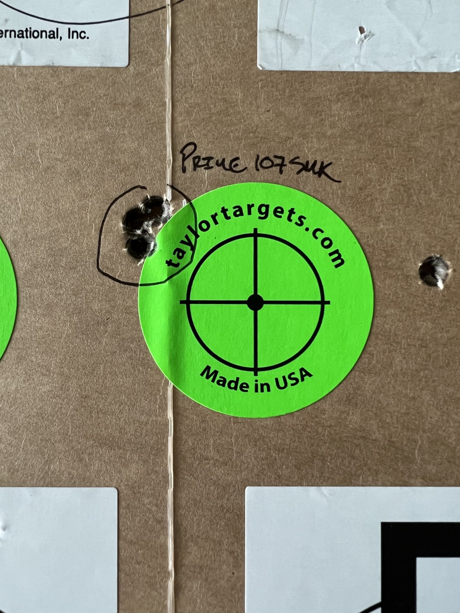

    Sico Omega
    Shoots Prime 107 at 2740fps
